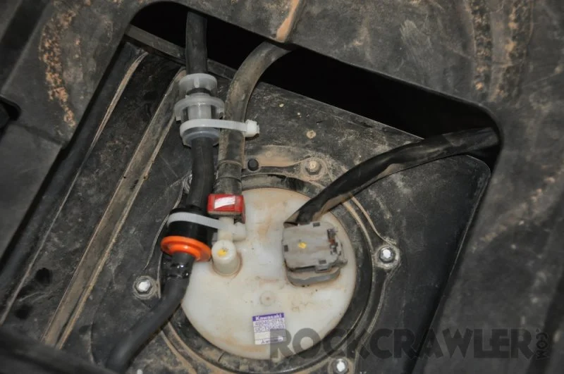

    Quick-Simple mod #1
    The factory fuel rollover check valve is located on top of the stock tank and vents into the chassis. There is no filter, and if you spend time in dusty conditions, it can/will clog your check valve open and you'll enjoy dirt in your tank...that results in a dirty fuel filter/sock and more issues to deal with (and can include a burnt up fuel pump)
    $2.95 for an inline fuel filter
    $4.55 for a package of windshield washer/vacuum hose
    three zip ties :)
    I shortened the hose where it connects to the tank, allowing the line to lay closer to the tank...I cut about 3/4" off and reattached. I removed the center console as well and extended/looped the vacuum line.
    The photo shows the rest.

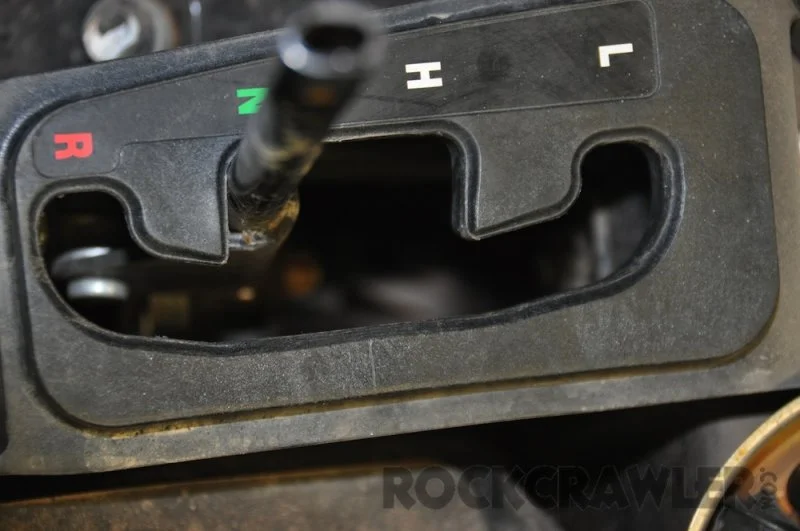

    next up was a freebie...tools required were a small handsaw and a file...
    Simply put, shifting the T4 from L to H to R is an irritation...stupid gate in the way. The shifting mechanism is spring loaded, so the gate is only there to 'slow' you down from hitting R too quickly and causing transmission damage.
    NOTE: you must be fully stopped to shift between ANY gears...you've been warned :)
    Pic shows it after clearing the gate...if you've got a T4, it's obvious...
