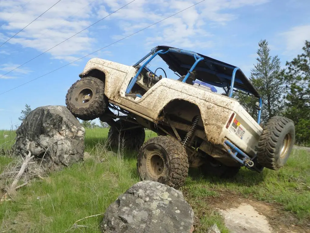

I started with a mostly stock 67 , other than 2 inch lift and 31 inch tires .
Now the only things left from 67 are the frame and the dash
Body is a 4wd fiberglass
Engine 351w 30 over trw 10.5 to 1 pistons , comp cam AFR 185 alum heads with roller valve train
Howell efi MSD ignition
Tranny is a C6 , using a Hayden hydraulic cooler T case is a Stak 3 speed netting 1 to 1 2.44 to 1 and 4.27 to 1 in high range and turning 2500 rpm = about 50 mph. In the lowest range turning 2500 = about 8 mph
Front axle is an 86 D60 narrowed 8 inches on the passenger side and using 4.56 gear with a Detroit locker only needing 1 custom inner shaft on the passenger side
Rear axle is a 77 big bearing early Bronco housing using 35 spline shafts with a Currie 8.8 high pinion hybrid 3 rd member with 4.56 gears and a full spool .
4 link front and rear using Bilstein coilovers 14 inch front and 17 inch rear netting 26 inches of wheel travel in the front and 32 inches in the rear Mid truck mount ¾” sway bar
Steering is full hydraulic by PSC . 4 wheel disc brakes
Tires are 37 inch Pitbull Rockers mounted on Allied Rockathon bread lock rims with 2.5 inch back space
Custom front and rear bumpers and a ramsey 10000 lb winch Alum tool box in the back that also holds 2 batteries 23 gallon heavy guage steel fuel tank
Replaced stock 67 wiring harness with an American wiring harness . Old harness was a fire waiting to happen
LED lights front , rear, and under body
Interior 3 Summit racing bucket seats 5 point seat belts full custom family cage tied to the frame
Wheel base is 3 inches longer than stock axle width .
My goal was to build a well built rig that I can pound on all day and still drive on the street without getting the stink eye from the cops ! I have fun with it but the build is never done !
