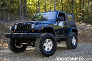

So it stands to reason that Superlift's inside track would mean they'd have one of the first suspension kits for the JK to hit the market - and they wanted to show it to us. OK, well, not just show it to us. They flew us out to Hot Springs to grab the wheel of a pre-production JK and pound the snot out of it on the rocks! It's good to have friends.
Superlift is offering three kits for the JK. The first is a 2" spacer kit (part # 5702) that will clear a 33" tire. This was not yet available for our visit. The other two are essentially the same but differ by an inch. Under the Superlift brand will be a 4" kit, while their Black Diamond brand will get the same kit but with 3" springs. We were in Hot Springs to drive the 4" Superlift kit so that's what we'll talk about here and show you photos of.
The 4" kit will be available under two part numbers. K920 will fit 2 door JK's while K921 will fit 4 door JK's. The kits include springs all around, Urethane bump stops to handle compression, shocks, an adjustable front track bar, rear track bar bracket, alignment cams, rear extended swaybar links and assorted hardware bits. Optional parts include swaybar disconnects for X and Sahara models without the automatic swaybar disconnect, steering stabilizer, extended brake lines and adjustable control arms.

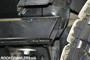

Superlift JK SuspensionThe JK on-site was sitting on 37" x 13.50" x 17" Toyo Open Country M/T tires. Superlift's official materials say that you can fit a 35" x 12.50" tire underneath with notes saying that you can fit a 37" with some modifications. This Jeep had been modified. The front bumper had been spaced forward about an inch and the rear edge of the rocker had been trimmed - both in order to clear the tires. The wheels, having deep stock backspacing had Spidertrax wheel spacers (part # WHS-010) to push the wheels out a bit. These modifications were very unobtrusive and we might not even had noticed them if they didn't bring them to our attention. The bumper spacers may become a production optional part. Chances are, though, that you would not need these with an aftermarket bumper installed.

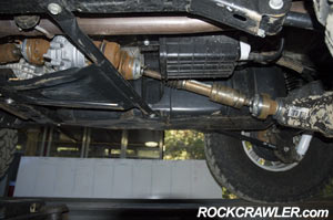

One other thing of note is the driveshaft angles. While the Jeep was on the lift it was apparent that the JK's fixed yoke shafts were about at their operational limits. The style of C/V joint used is not made to take the abuse of more severe angles found on lifted Jeeps when used off-road. Why Jeep used them, nobody seems to know. While we didn't notice any binding or problems during our trail testing, time will tell whether they will hold up long-term. Tom Wood and JE Reel are already working on JK conversion kits to use traditional C/V joints. Understand that this angle issue is inherent to the JK and is a problem that every suspension manufacturer will have - not just Superlift.

Some trimming was needed to clear the 37" tires

Note the C/V angle at the transfer case

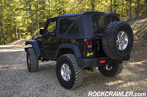

Superlift JK SuspensionBefore hitting the trails we took the JK for a ride on the streets near the park and on the highways surrounding Hot Springs. The suspension felt good, and was predictable at all speeds. Even without the alignment cams, the Jeep's handling was acceptable for the most part, and certainly better than many lifted TJ's we've driven. Adjusting the caster could only improve it that much more.
Ride quality was good and much less jarring than lifted TJ's. The JK has a much softer-feeling setup from the factory to begin with. Jeep uses 22 different spring part numbers at the factory so Superlift has had to come up with a best-choice for their kit. At the rear, there are different springs for two and four door models to handle the weight difference.
One thing that is becoming a headache with lifting all new vehicles is the advent of traction control. The JK has a pretty stout set of controls onboard, including hydraulic brake assist and electronic roll mitigation. In our test drives of stock JK's we found it a bit obtrusive. Throw larger tires on and some lift and the computers get all confused. We needed to disable the switch on the dash in order to drive the lifted Jeep properly. Superlift is working hard on a black box to interface and update the system to work with the lift kit.
During sharp turns the Jeep did not exhibit any scary body roll and didn't surprise as at all. At highway speeds up to around 80 mph, it tracked straight and also didn't throw any punches.
