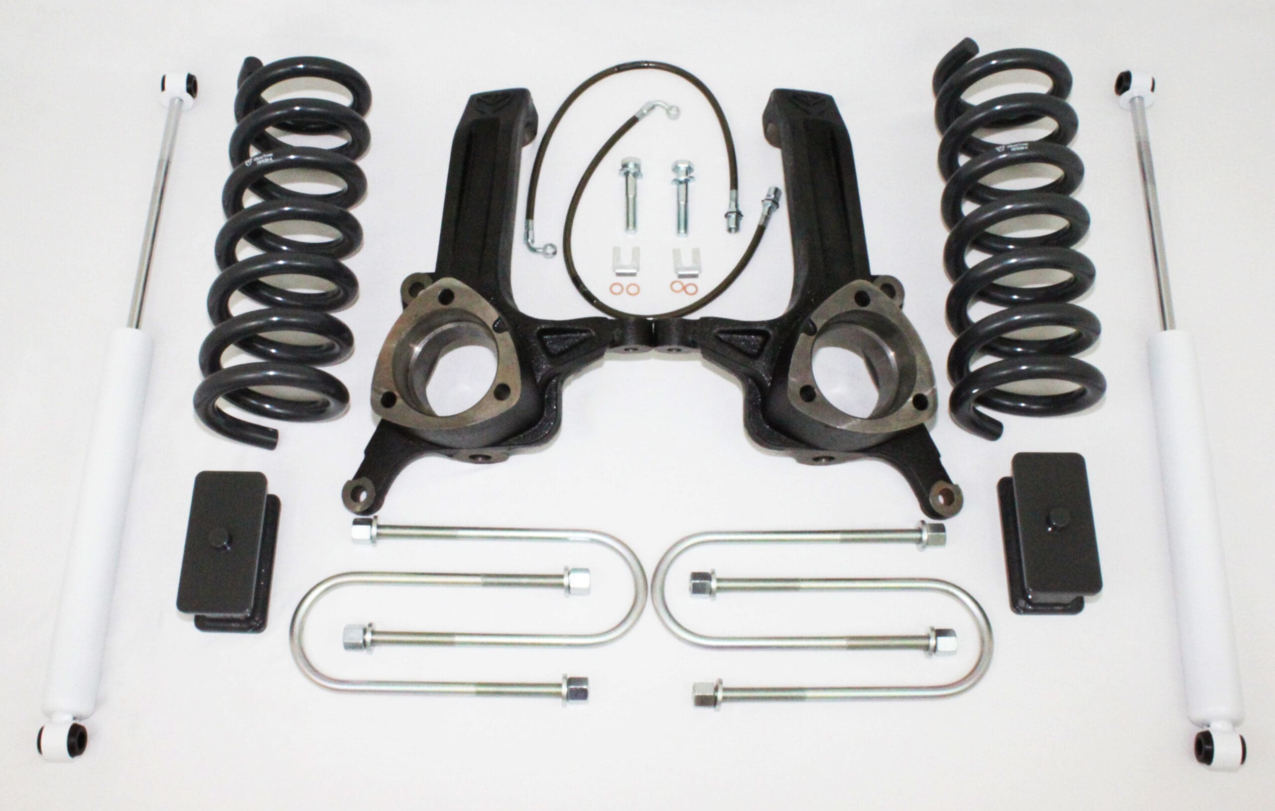

The system’s marquee feature is MaxTrac 3.5-inch lift spindles, which can be purchased as a stand-alone kit, complete with proper-length DOT-approved braided-steel brake lines. Like O.E., the MaxTrac spindle is cast as a single piece of ductile iron. MaxTrac designed the spindle to keep steering and alignment geometry within factory spec. Also, tie-rod bosses and the neck area are thicker than O.E. to handle the weight of larger-than-stock tires and wheels. A durable e-coat finish improves the spindle’s overall look and fights rust.
The complete system adds springs, shocks, blocks and all necessary hardware. MaxTrac front coil springs are application-specific: Hemi versions provide 2.5 inches of lift while diesel coils are 3 inches taller than stock to compensate for the additional engine weight. These springs can also be purchased separately.
MT_DodgeHD3
Rear leveling is accomplished with 2.5-inch fabricated steel blocks. Made in the USA, these blocks are tapered to maintain the proper pinion angle. Grey powdercoating provides an attractive, durable finish; extended-length U-bolts are included with the blocks. Finally, longer-than-stock MaxTrac rear twin-tube shocks and instructions are included to complete this bolt-on kit — no welding or cutting is required for installation.
Estimated labor time for this system is approximately four hours. Also, factory front dually wheels will clear the MaxTrac spindles, but single rear-wheel Rams will require aftermarket rims that are at least 17 inches tall and have a maximum 4.75 inches of backspacing.
