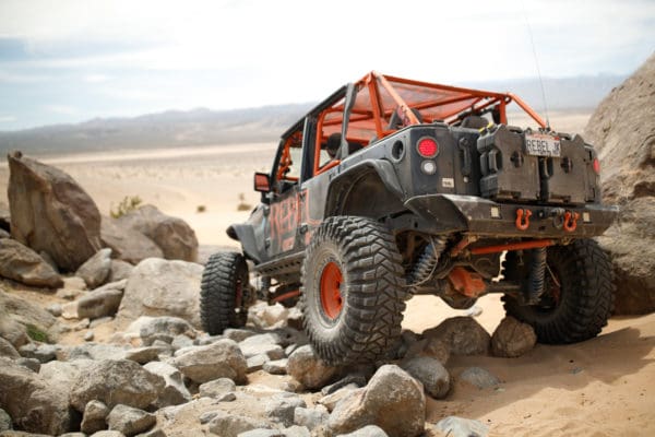

Very few four-wheel drive vehicles can claim to be as tough, reliable and dependable as the iconic Jeep Wrangler, a machine that can trace its lineage back to the Willy’s Jeep. Now Alcon, one of the most revered names in automotive braking, has introduced a comprehensive brake upgrade kit for the JK-generation Wrangler, including calipers, rotors and pads for both the front and rear axles.

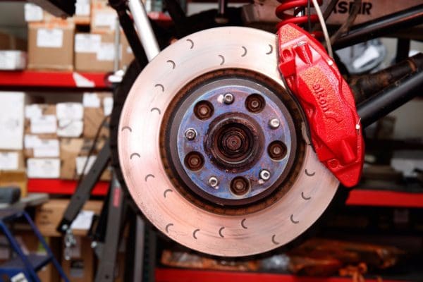

Alcon’s kit has been extensively tested and proven to deliver significant, quantifiable gains over factory installed equivalents. The kit offers up to 30% reduction in disc temperature rise, a staggering 26% reduction in pad work rate (leading to a corresponding upswing in pad life) and up to 25% decrease in pedal effort. Impressive stats by any measure, but Alcon’s kit is also able to bring other, less obvious benefits to the table. All of which are detailed below.
The kit features Alcon’s industry-leading four-piston calipers, all coated in epoxy acrylic paint over an acid zinc finish, a combination that’s proven to offer excellent corrosion protection. Front and rear calipers boast ductile iron housings which provide maximum strength and stiffness, plus high resistance to both impact and fatigue. Last but not least, all calipers come with advanced wiper seals around each piston. These advanced seals are resistant to the extreme temperatures generated by hard braking, yet also prevent road grime from entering the caliper itself.
Both the rotors and pads included in Alcon’s Wrangler kit offer improved stopping power. The rotors are significantly larger than those fitted by Jeep itself (350×32mm front, 330×22mm rear), and have a larger thermal capacity, meaning you can brake harder for longer without suffering brake fade. The pads included in the kit have been chosen for their increased surface area and long working life which makes them the perfect complement to both the rotors and calipers.
