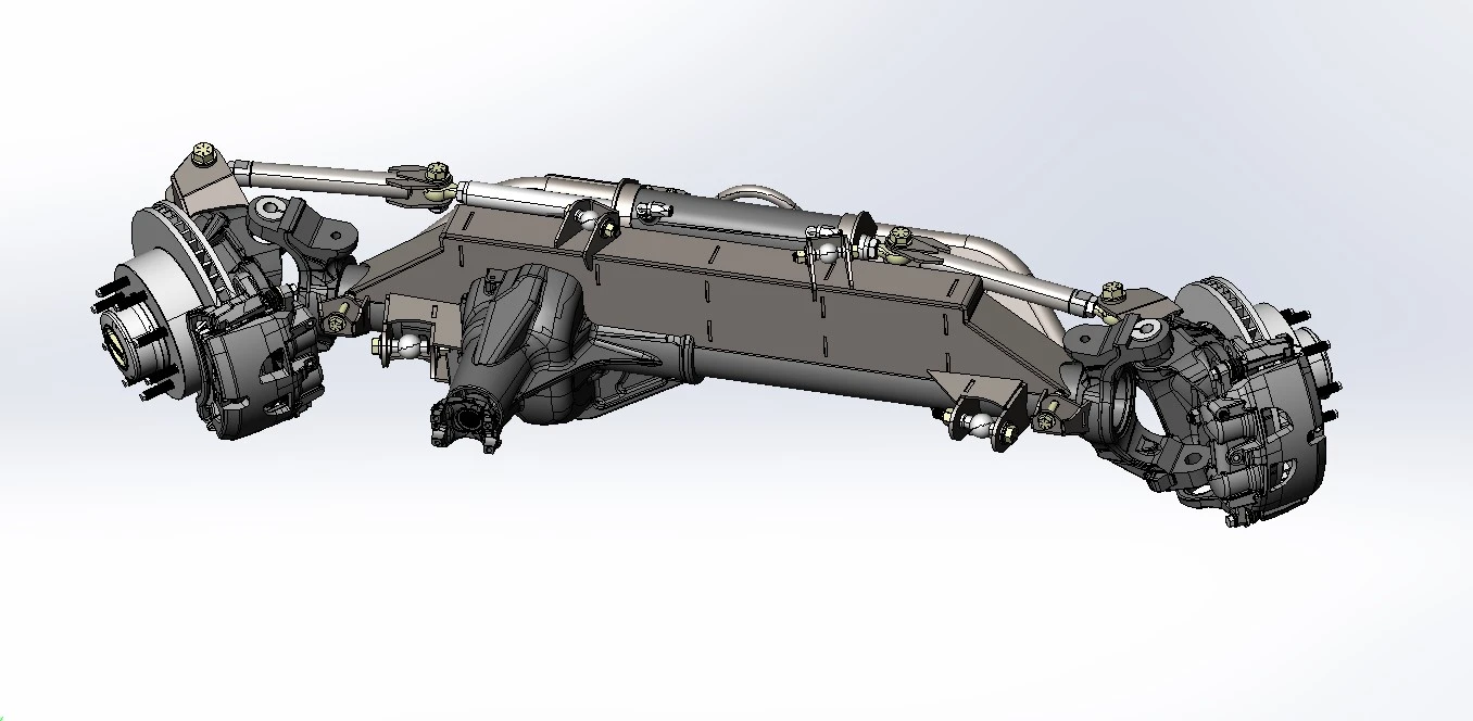

I'm building an f250 axle and shooting for 45deg steering angle. Its tight! I had to grind away the one rib on the the left side of the diff casting and move the link mount as close to the diff as I reasonably could.

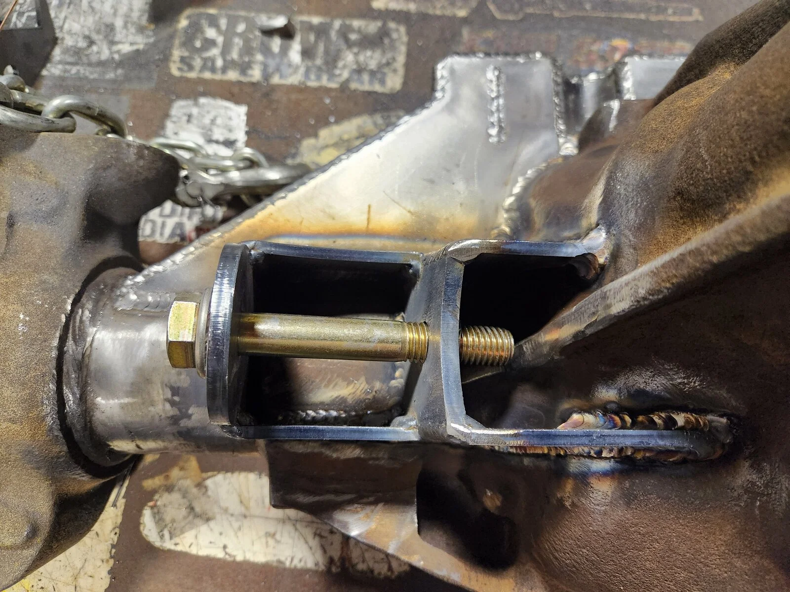

Somewhat bad pic trying to show pinion to link clearance issues. This is for my build and my links clear, but land about 26" apart at the subframe. If I triangulate them anymore they'd be getting real friendly with the pinion yoke.

This is honestly where my train of thought has been leading me I’m just in the superduty cheap but it has a ton of problems. I think hearing it from someone else is what I needed. I have a 14 bolt I may just make into a a front diff and a Dana 80 I can use for rear steer
Its a good bang for you buck, but yeah, its got its issues. I'm just using it because either way I can't afford blingy custom shafts or housings at the moment. I did do a lot of design work to make it all work out with 45deg steering and 14" coilovers. If money was less of an issue I'd go other directions.
