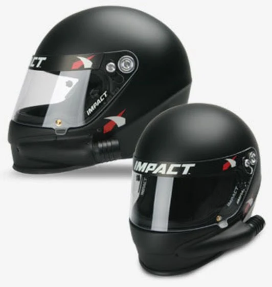

Helmets must be approved by one of the following with the appropriate approval decal attached; Snell SA2005 / SA2010 or SAH2010 / SA2015. The interior and exterior areas of the helmet must be free of defects (i.e., the padding must be in good condition and the exterior of the helmet must not be damaged). Beginning with the 2017 Best in the Desert Racing Season, SA2005 rated helmets will no longer be permitted.

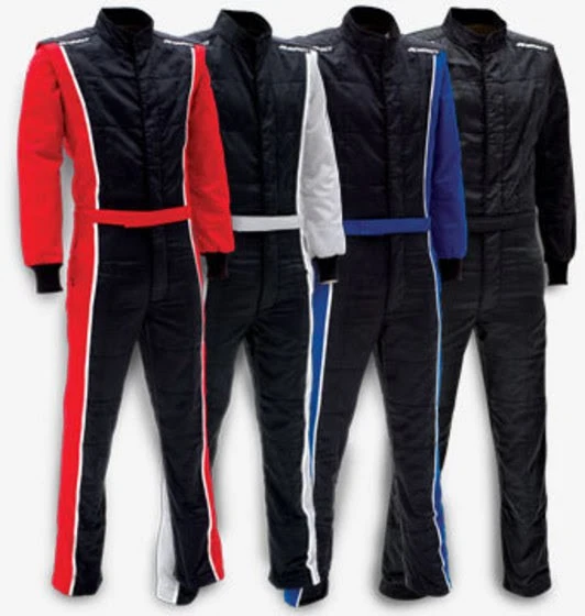

One-piece firesuits are mandatory. Two-piece suits are not permitted. Suits must not have any holes, rips, or tears or be worn thin and must be free from any petroleum-based contaminants. All suits must be manufactured from fire resistant material and shall bear a minimum of an SFI 3.2A/5 or higher manufacturer’s certification label. Fire retardant gloves and footwear rated to the SFI 3.3 standard are very highly recommended. Best In The Desert Racing Association also highly recommends that each fire suit be labeled on the upper right chest with the entrant’s full name, blood type, allergies or other important medical information.

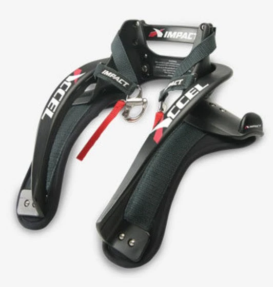

For the 2017 race season, Best in the Desert Racing Association mandates that all persons driving or riding in any class race vehicle wear a frontal head restraint (FHR) bearing the SFI Foundation’s 38.1 manufacturer’s certification label.

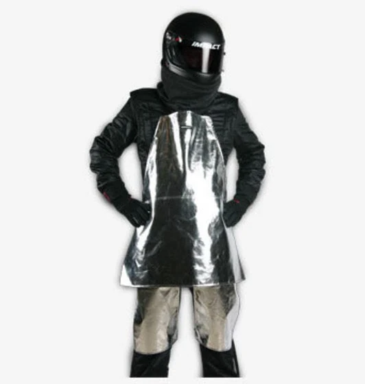

Best in the Desert mandates refueling personnel (aka “The Fueler”; the crew member responsible for inserting the fuel nozzle or dry brake during a pit stop) wear a one piece or two piece fire suit minimally rated to the SFI Foundation’s 3.2A/5 manufacturer’s certification. The suit shall cover the crew member from the neck to the ankles and to the wrists. The suit must be free from holes, rips, tears, and not worn thin. Additionally the “fueler” must wear a SNELL rated full face helmet, an SFI 3.3 rated balaclava, SFI 3.3 rated fire retardant gloves, and SFI 3.3 rated fire retardant shoes and an SFI 52.1 rated fueler apron.
