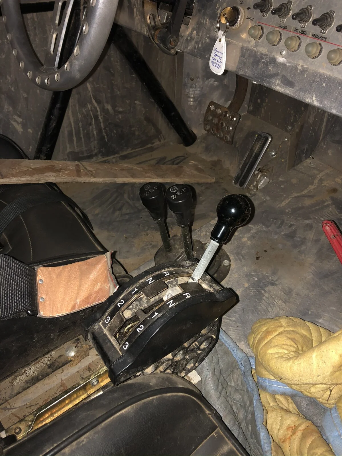

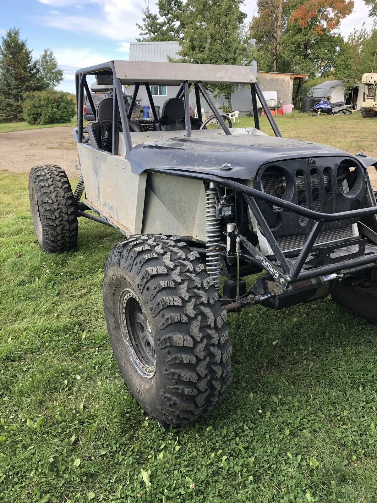

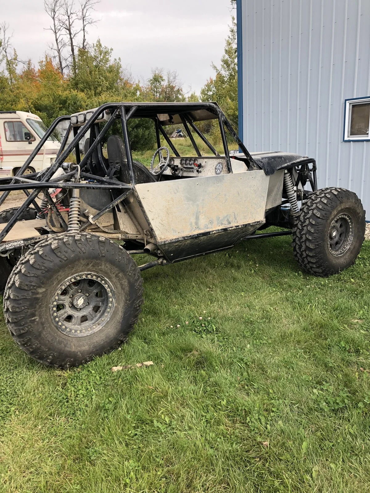

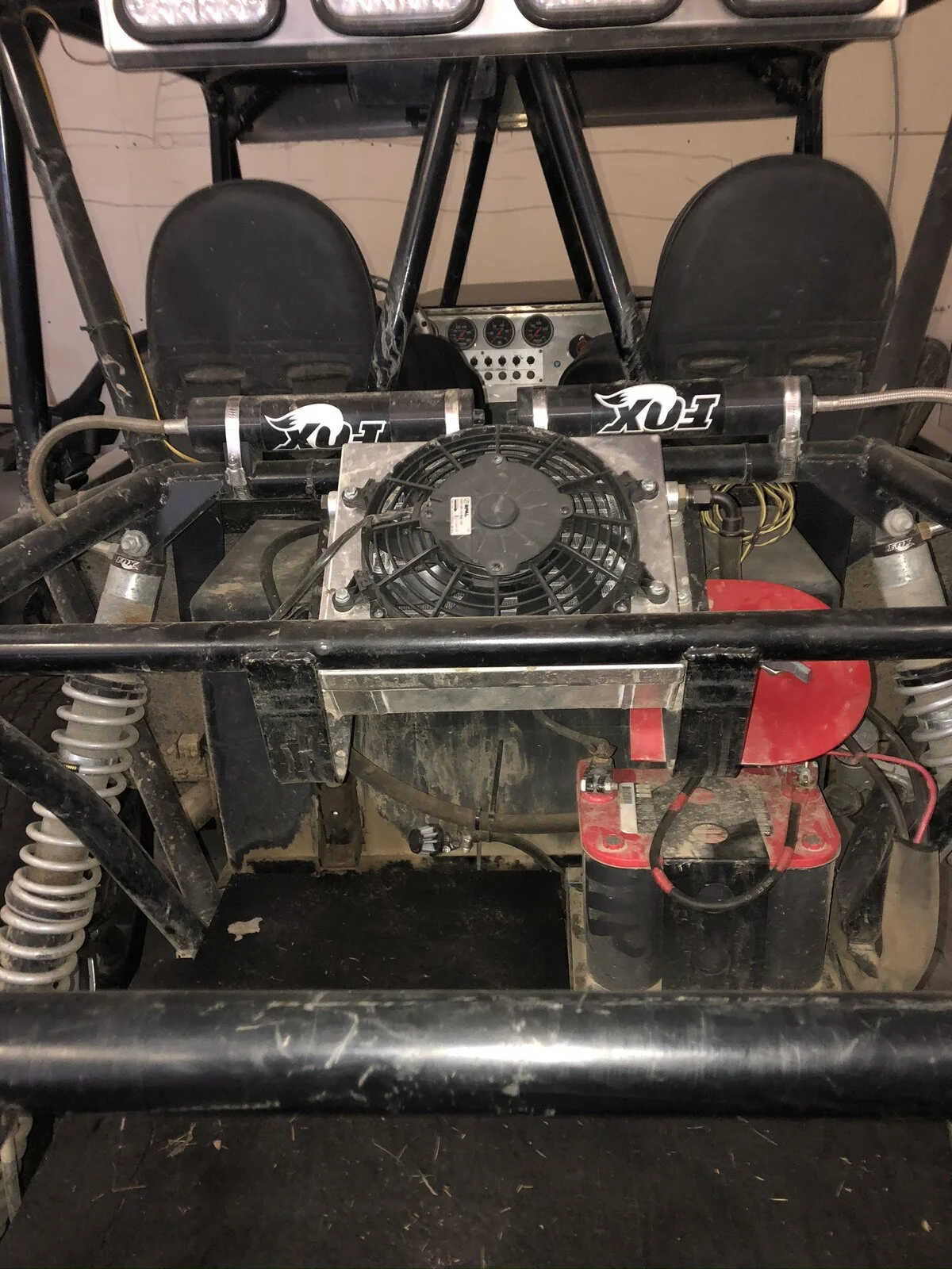

Chassis- 2015 goat built chassis welded together by Drew himself. Suspension is front and rear 4 link with 2.5 14” Fox coil overs sway bars front and back PSC full hydro prp seats
Motor- cammed 5.3l with wiring harness from Pacific Fab.
Transmission- Turbo 400 built up with braking clutches with reverse Manuel valve body.
Transfer-case- 2 speed Atlas with 3.8 reduction
Front axle- Trail-gear rock assault 9 5.13 gears with Yukon grizzly locker 35 spline shafts and wilwood 4 piston Callipers and discs.
Rear axel- Trail gear rock assault 9, 5.13 gears with Yukon grizzly locker 35 spine shafts and Wilwood 4piston Callipers and discs.
4
Wheels and tires- 17” racelines on 39.5/13.5/R
