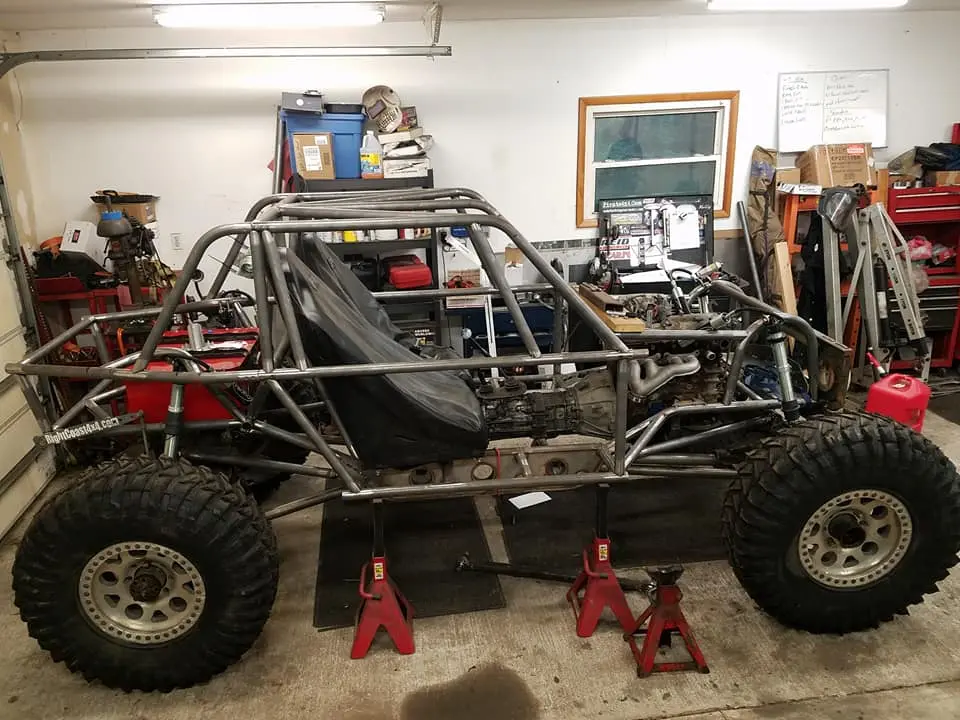

Just some guy from Pa checking out the place while building a new rig.

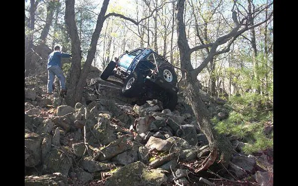

My old rig

Clearly, we need more pics and specs on both rigs!
Pic from Rausch Creek or ? damn, I miss Paragon....
That's from RC but I actually used to be a trail guide at PAP. I really miss that place but with AOAA and Famous Reading opening eastern PA is pretty stacked right now.
Buggy is a Toyota based drivetrain, 3rx, W56 and ultimate duals, narrowed 60/14b and 40 treps, Radflos and air bumps and of course a fj40 clip.
Truck was just a exo'ed 94 x-cab with duals and linked with narrowed tons and 40's and a narrowed front clip.

My FToy is pretty narrow for our terrain (Sand Hollow), so my new buggy project is going full width and rear steer...waiting on axles to arrive, then time to dive in :)

I run a 64 wide rear and 65 wide front in the buggy, the truck was 64 on both. I had the 60 narrowed and cut and turned the d60 or I've have stayed full width this time.
My FToy is 64 WMS front, 60 rear. Works awesome :) However, the crew I run with is mostly full width with 42's and rear steer...
