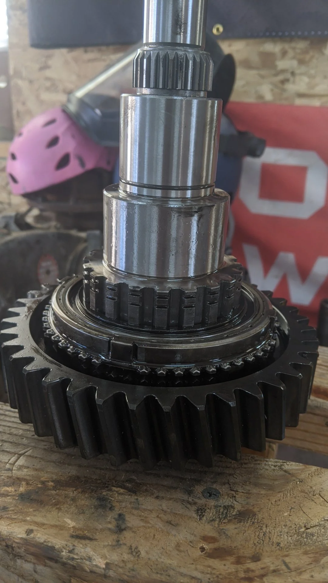

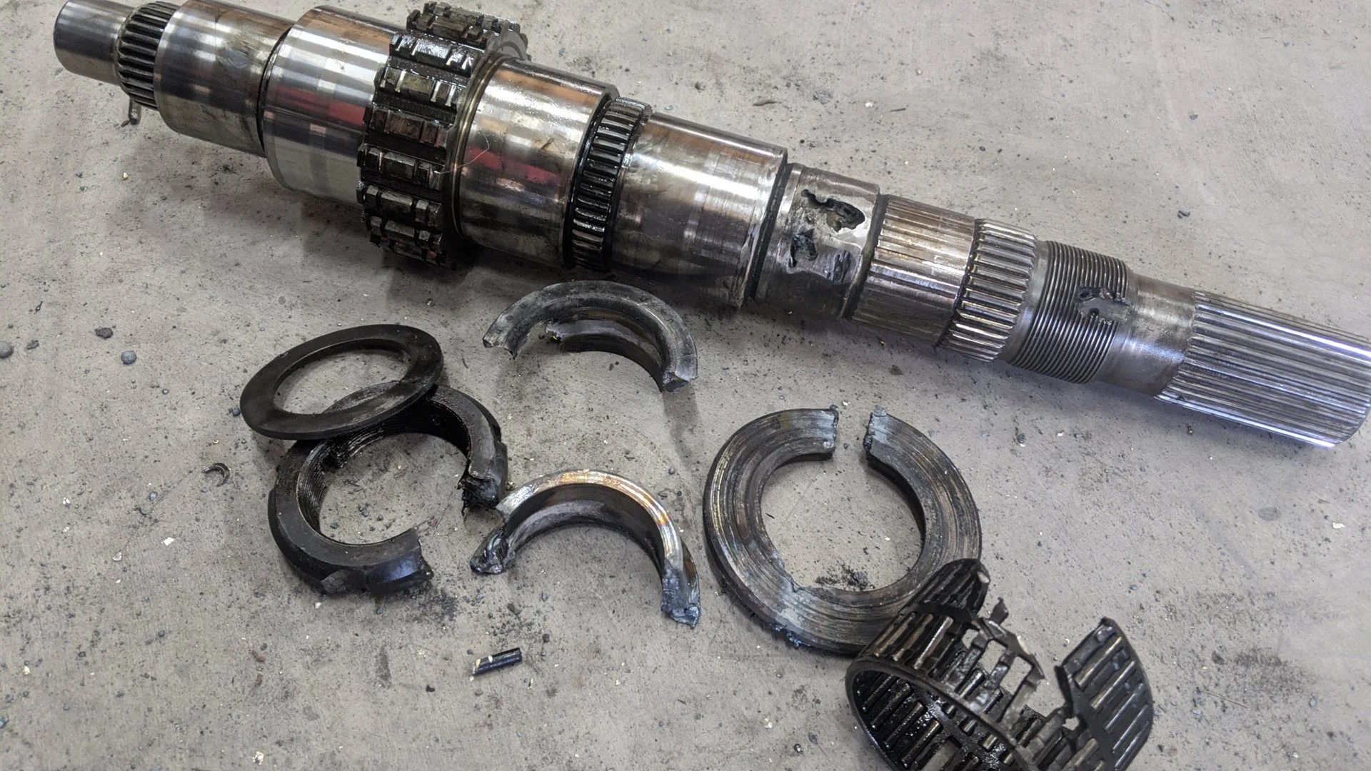

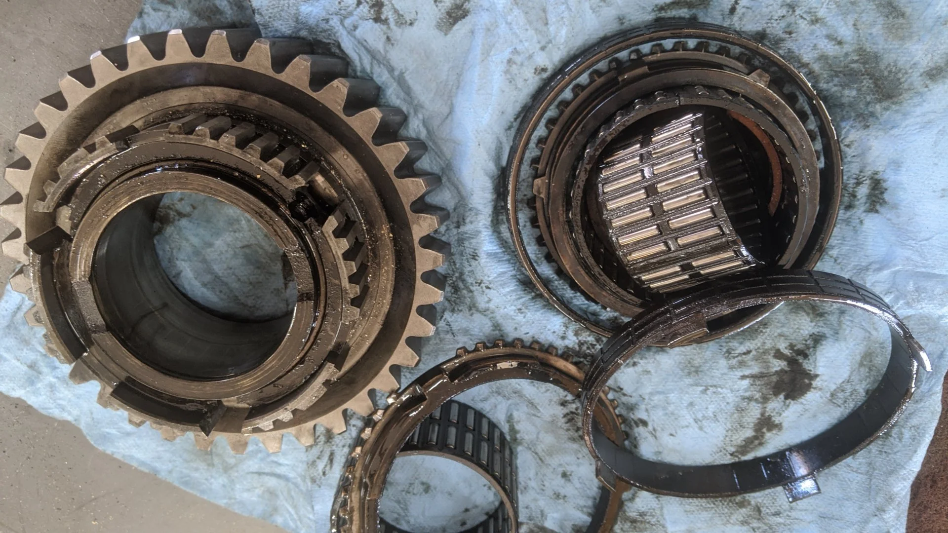

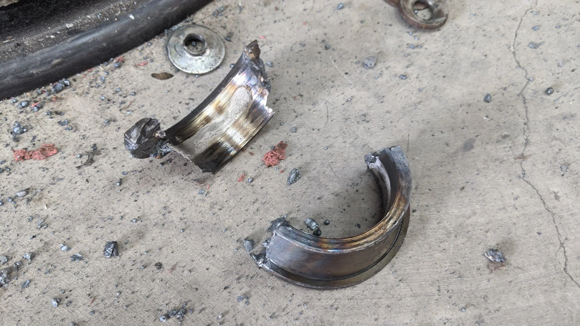

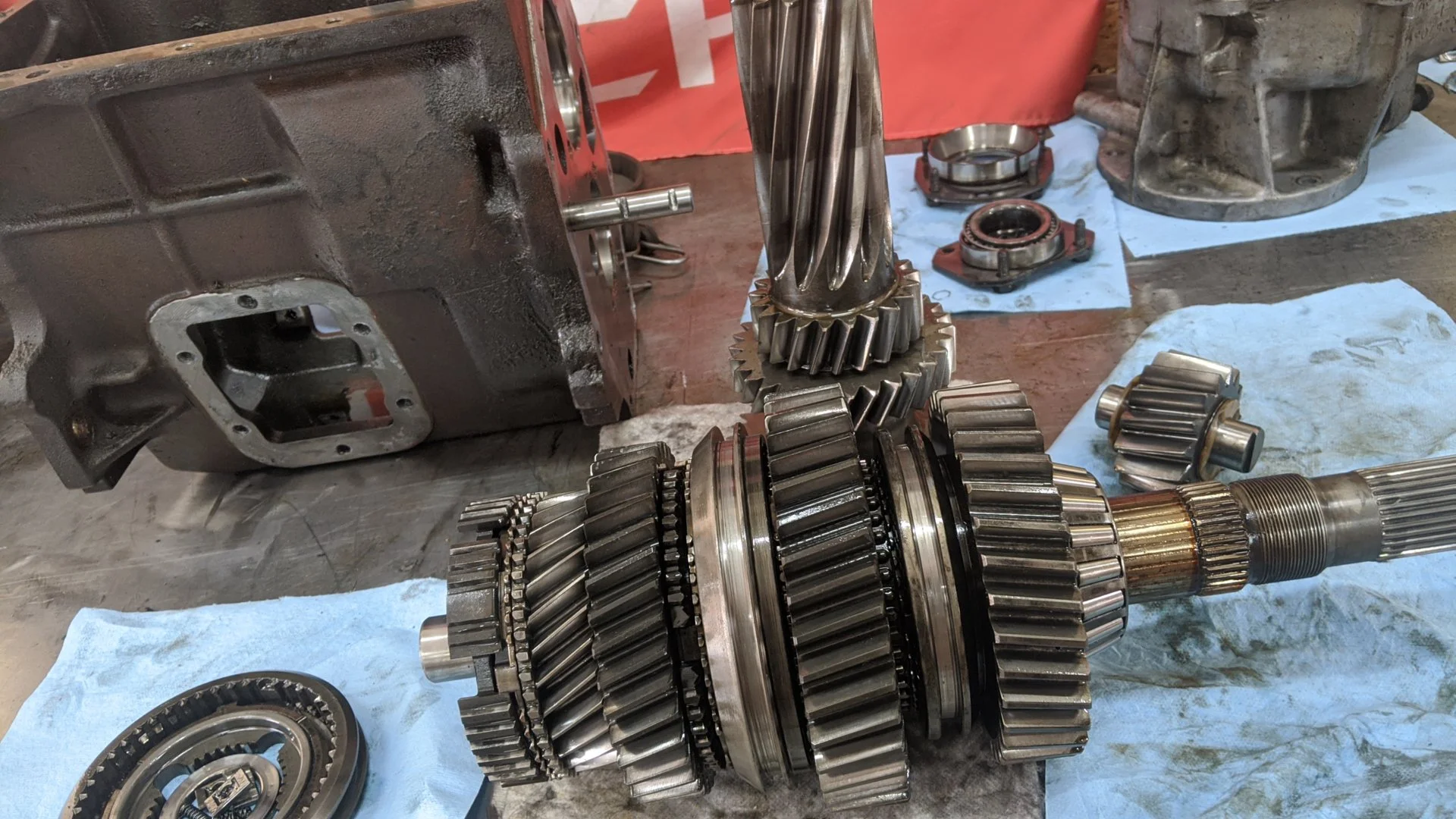

Today's progress on rebuilding my 98 Dodge NV4500...never a good sign with disassembling the mainshaft involved the torch...
Simply put, the reverse idler gear roller bearing is junk, so a set of roller bearings, a new thrust washer and a new reverse gear are on order. Yay.

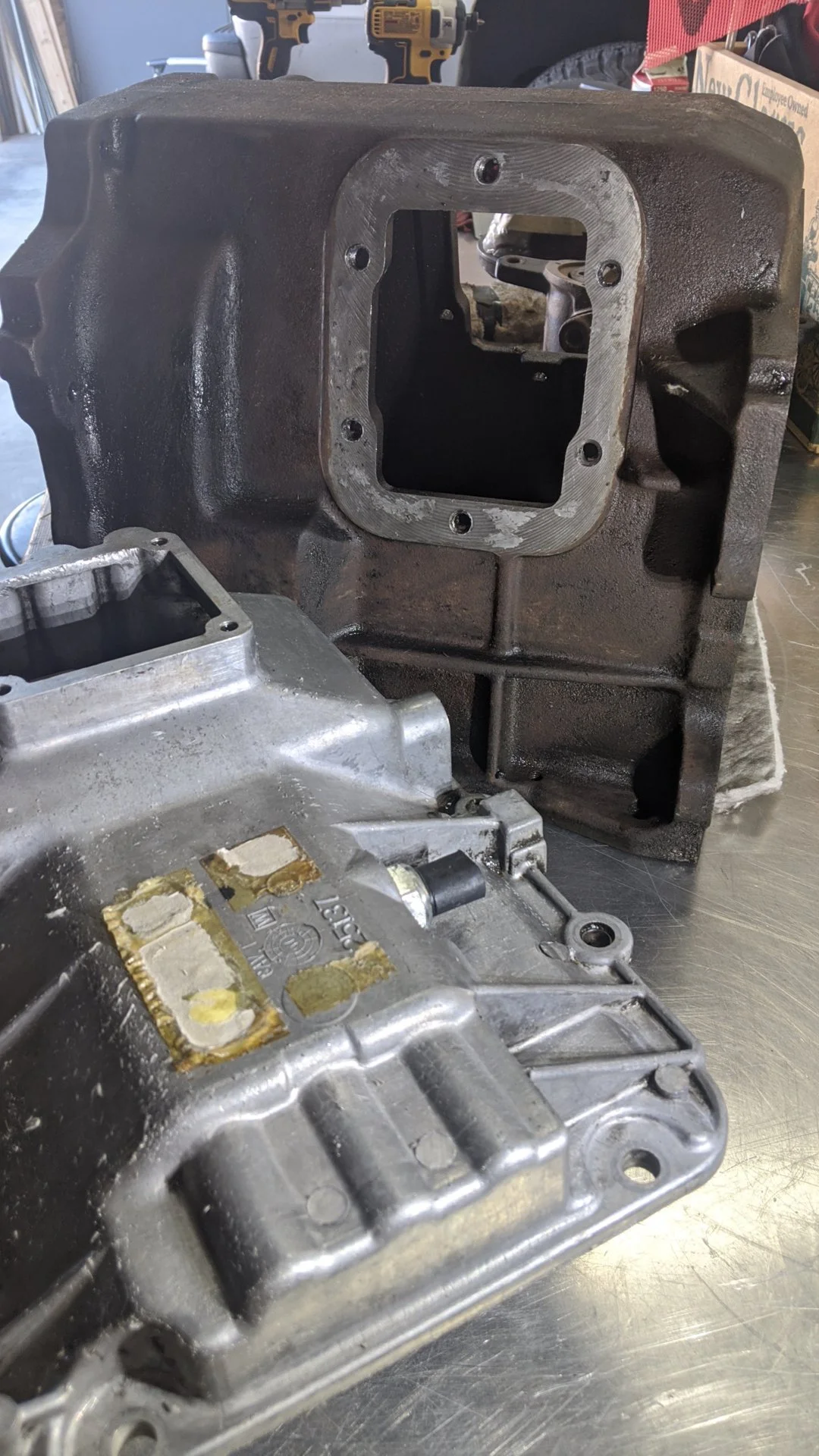

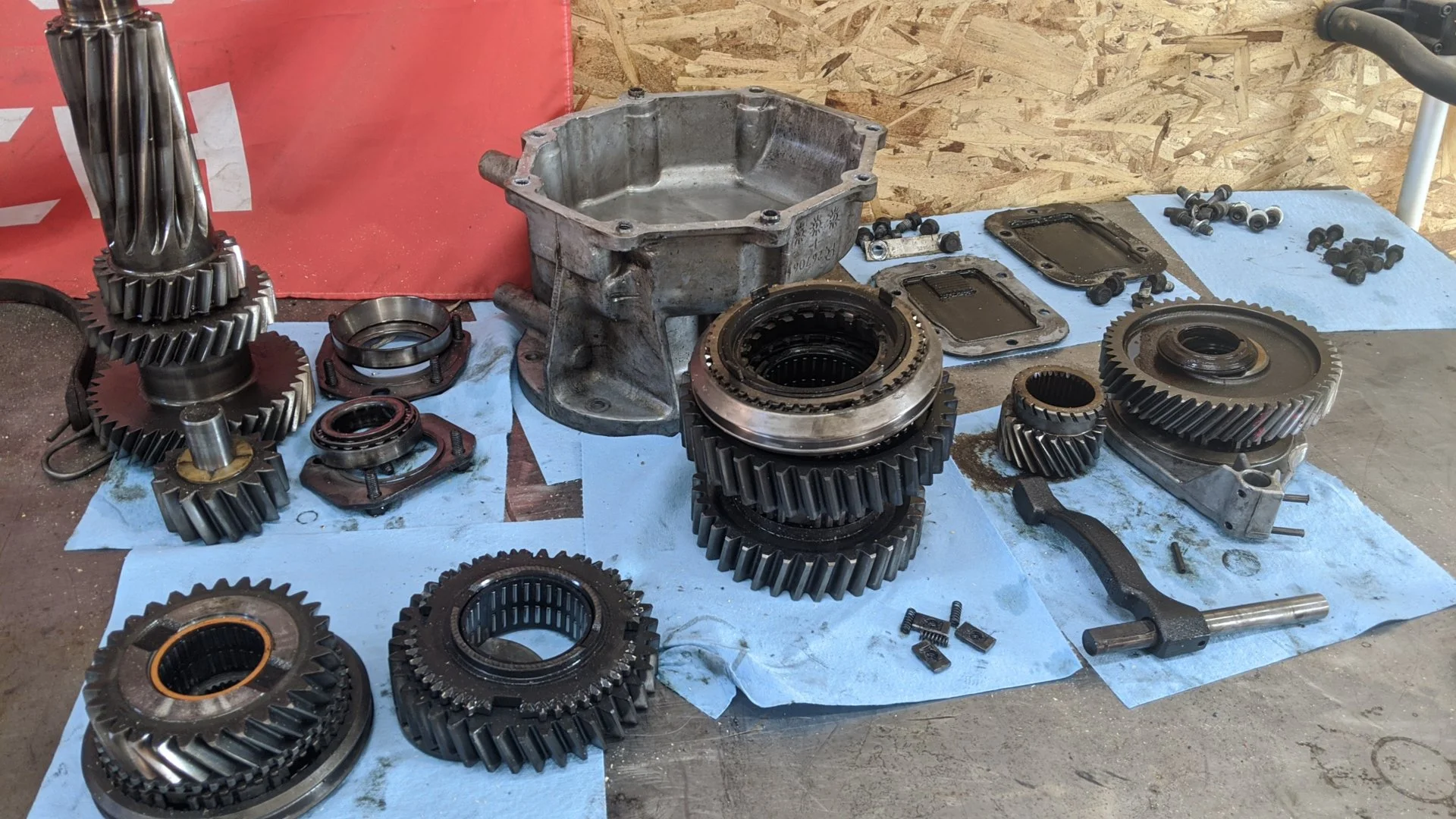

Cleaned up the top cover and case.... not perfect, but I was SURE the cover was black and not clean aluminum...lol

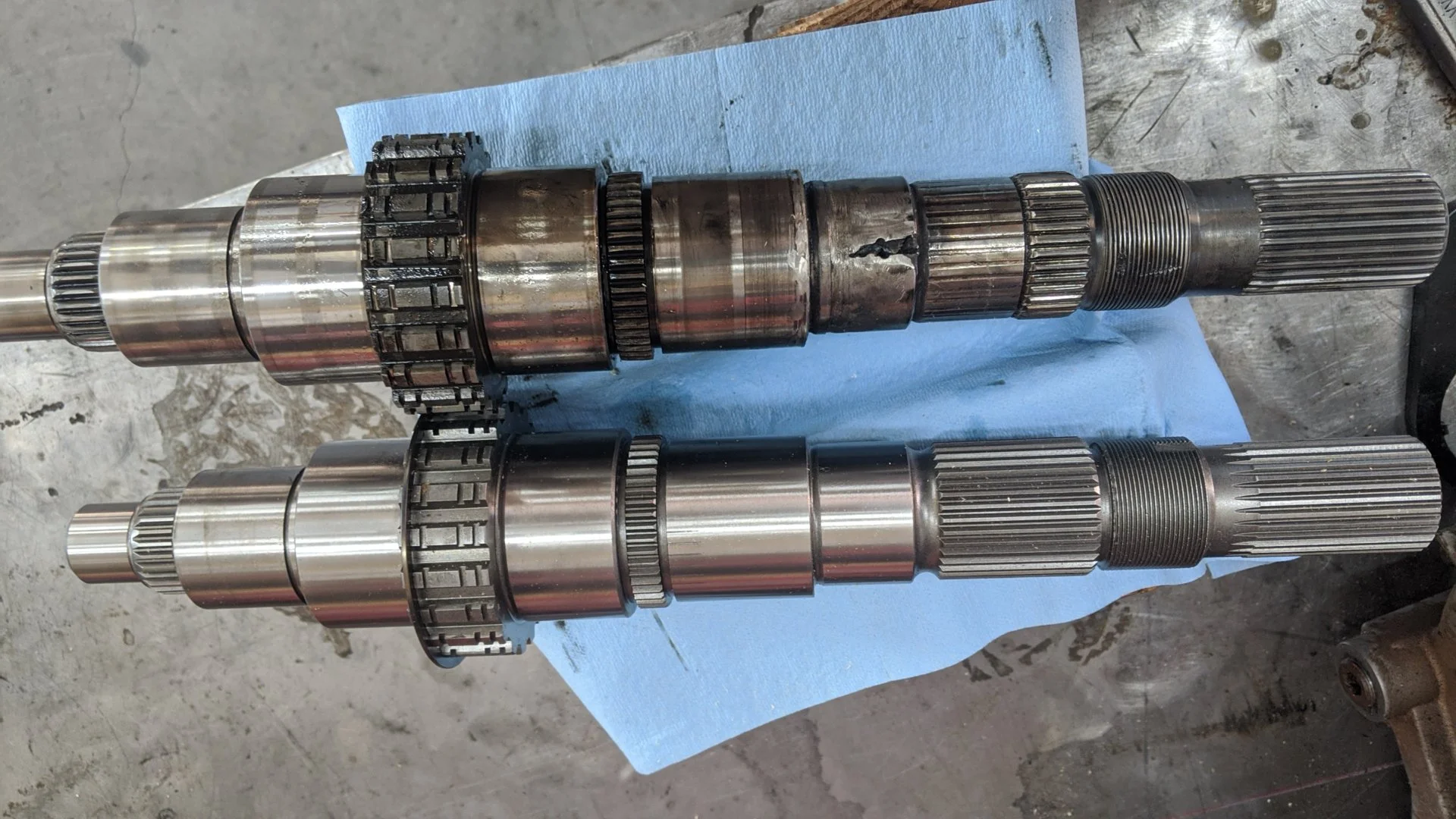

Still deciding if I should just reuse the old mainshaft.... a little Emory cloth should clean it up, right?!?
At some point, all of this stuff needs to end up inside the case.... in order... Should be fun!!

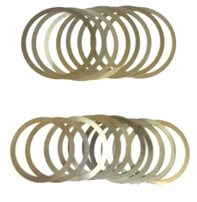

Ordered my rebuild kit from Allstate Gear...overall very complete....also ordered the replacement reverse gear AND their shim kit (BTW: order that shim kit right away...)

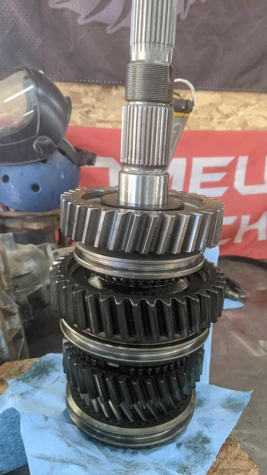

Reassembly in progress...

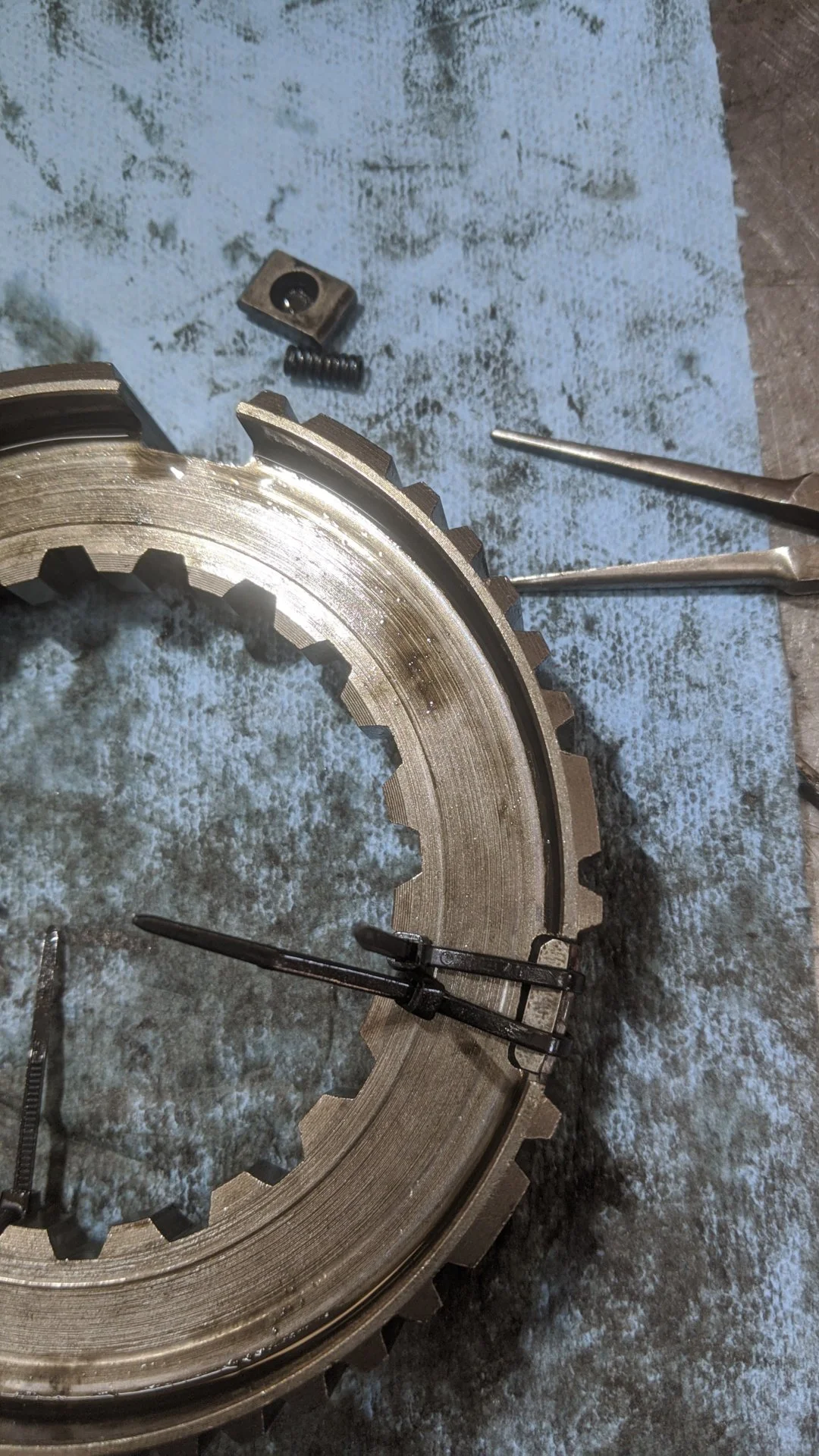

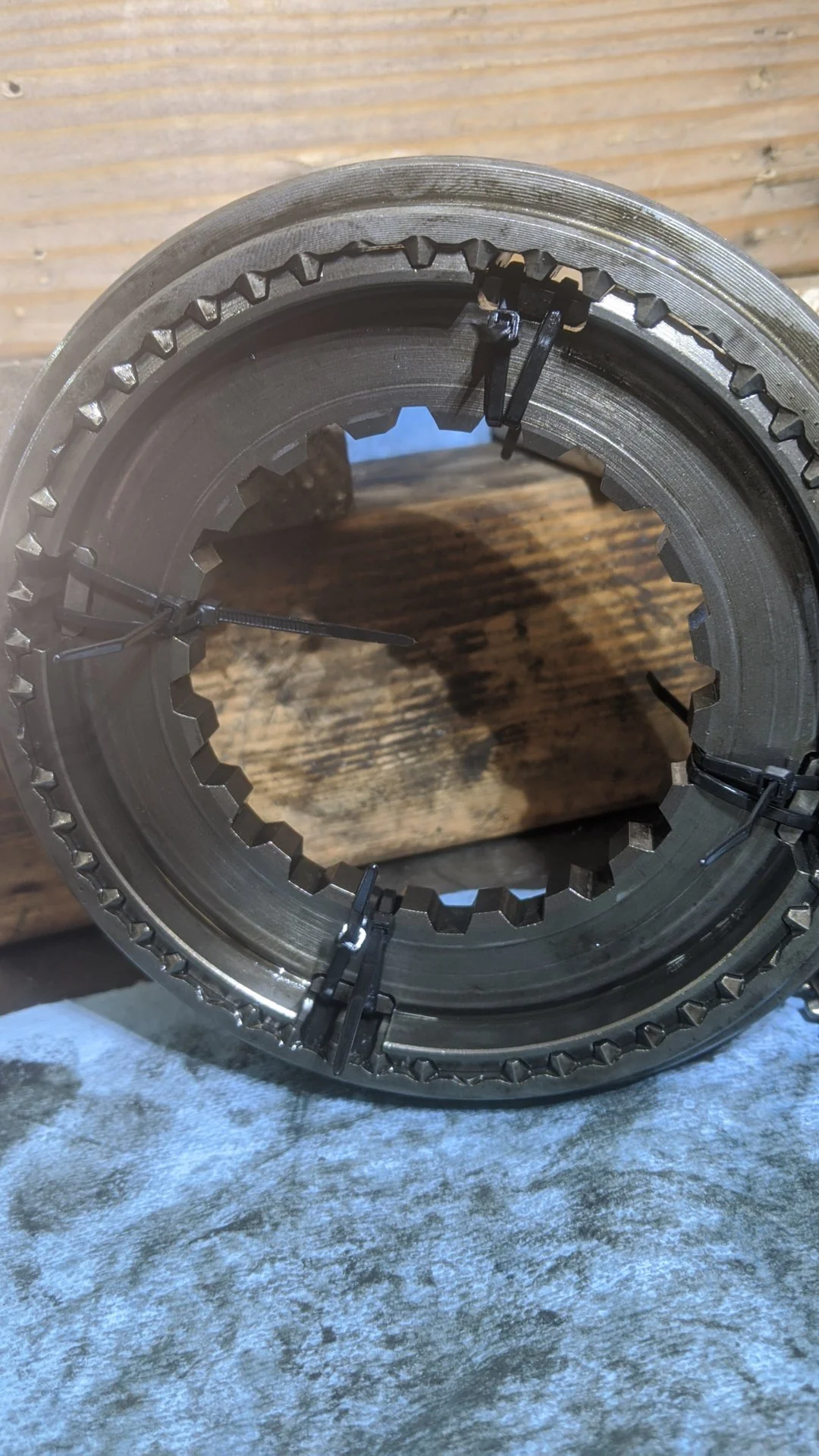

FYI, do NOT, under any circumstances, let this set of four synchro struts/springs fly out....it sucks....you then get to do this zip tie trick - of course, the springs are tiny and finding them can be a challenge too. I got lucky and nothing flew too far.
Starting to look like it might actually work....maybe....

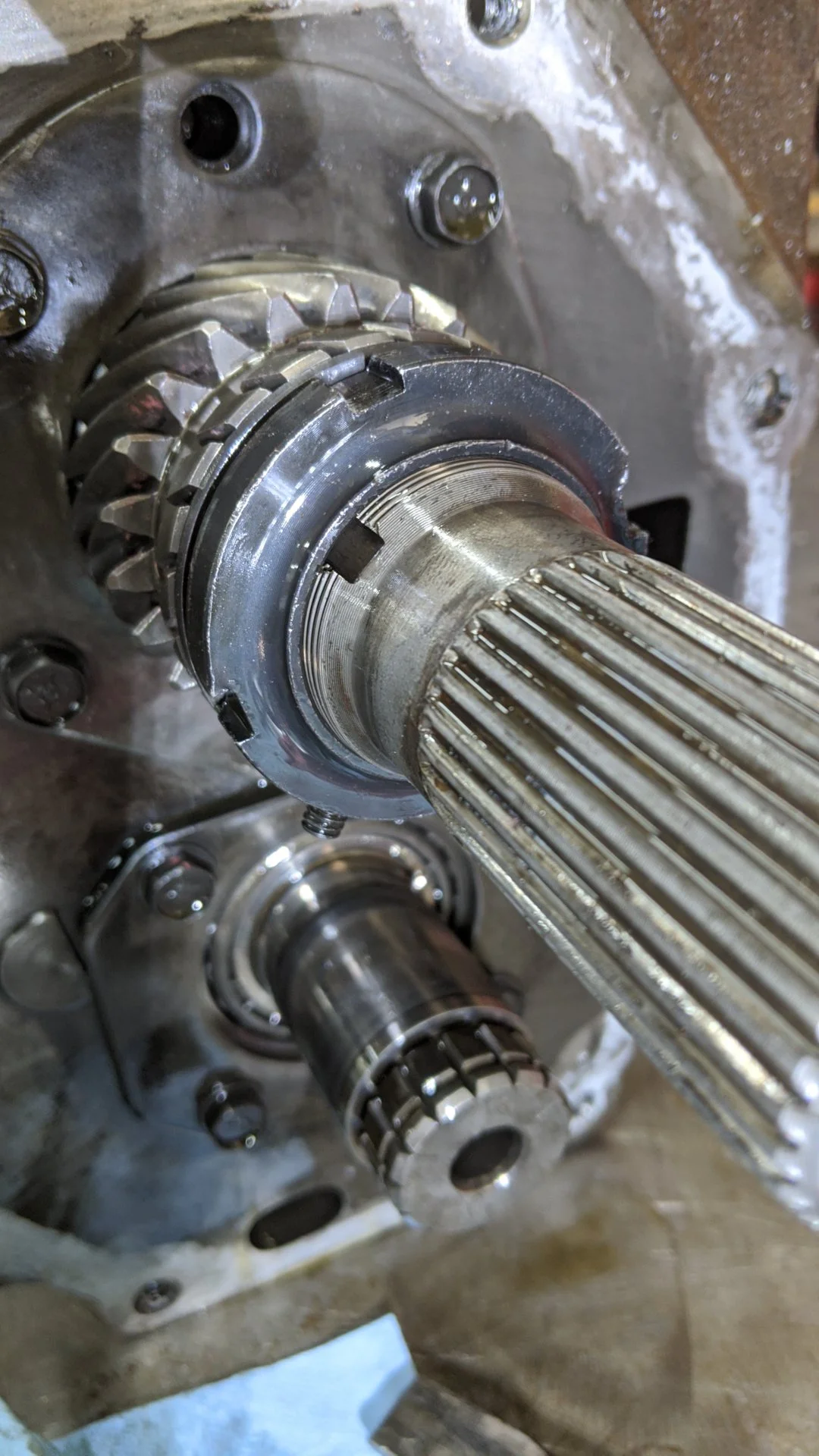

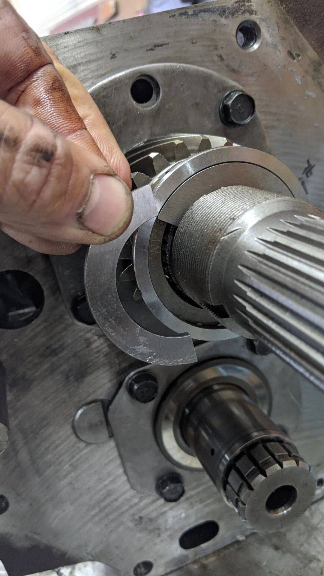

The new mainshaft and 5th gear includes a new 3 piece washer to lock 5th from wandering out. Install both half moons into the slot, then the outer ring traps them.

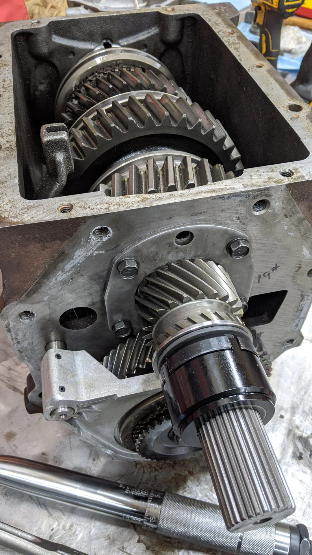

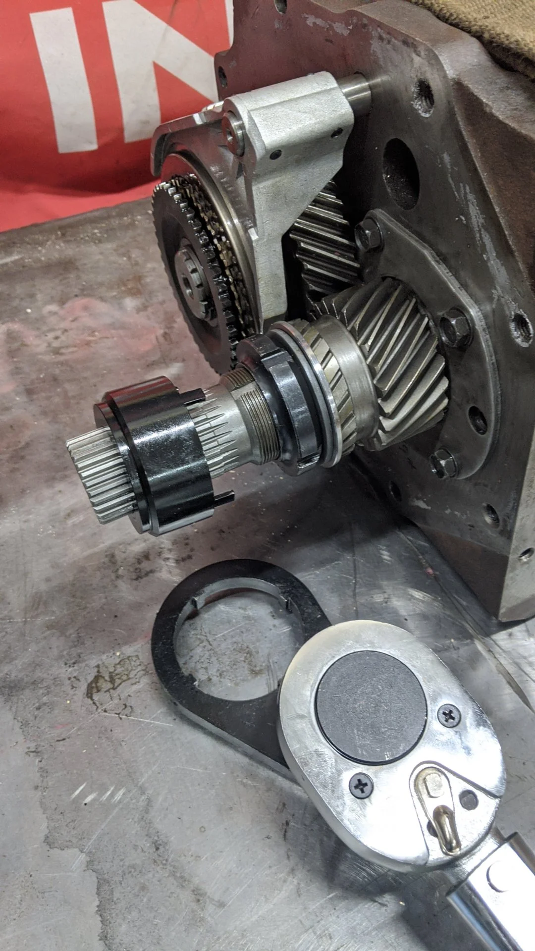

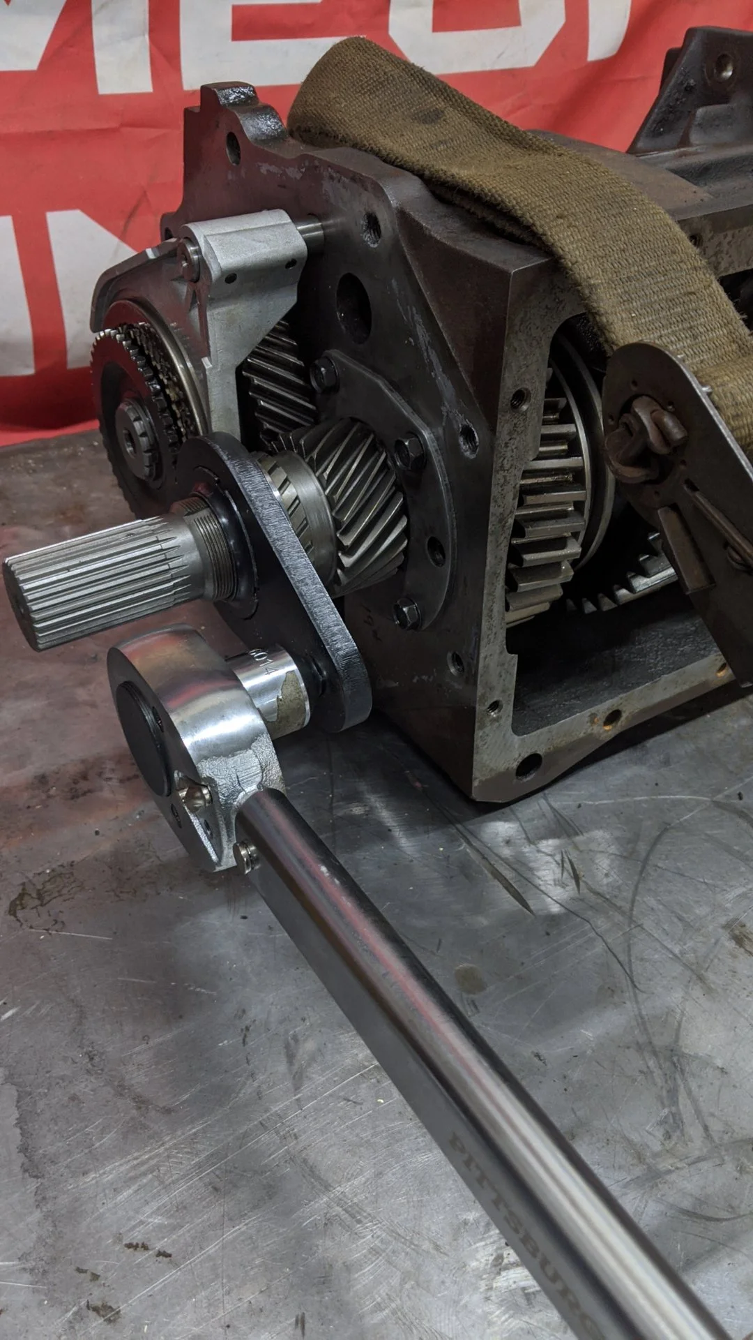

Then, jam the trans into BOTH 1st and 3rd....locking the rear output on the mainshaft. Strap that baby to your workbench, and it's torque wrench time....325 ftlbs (Factory is 270-280, my torque wrench caps at 300, so I got 'er close)
The wrench:
Amazon product ASIN B0811CTX71

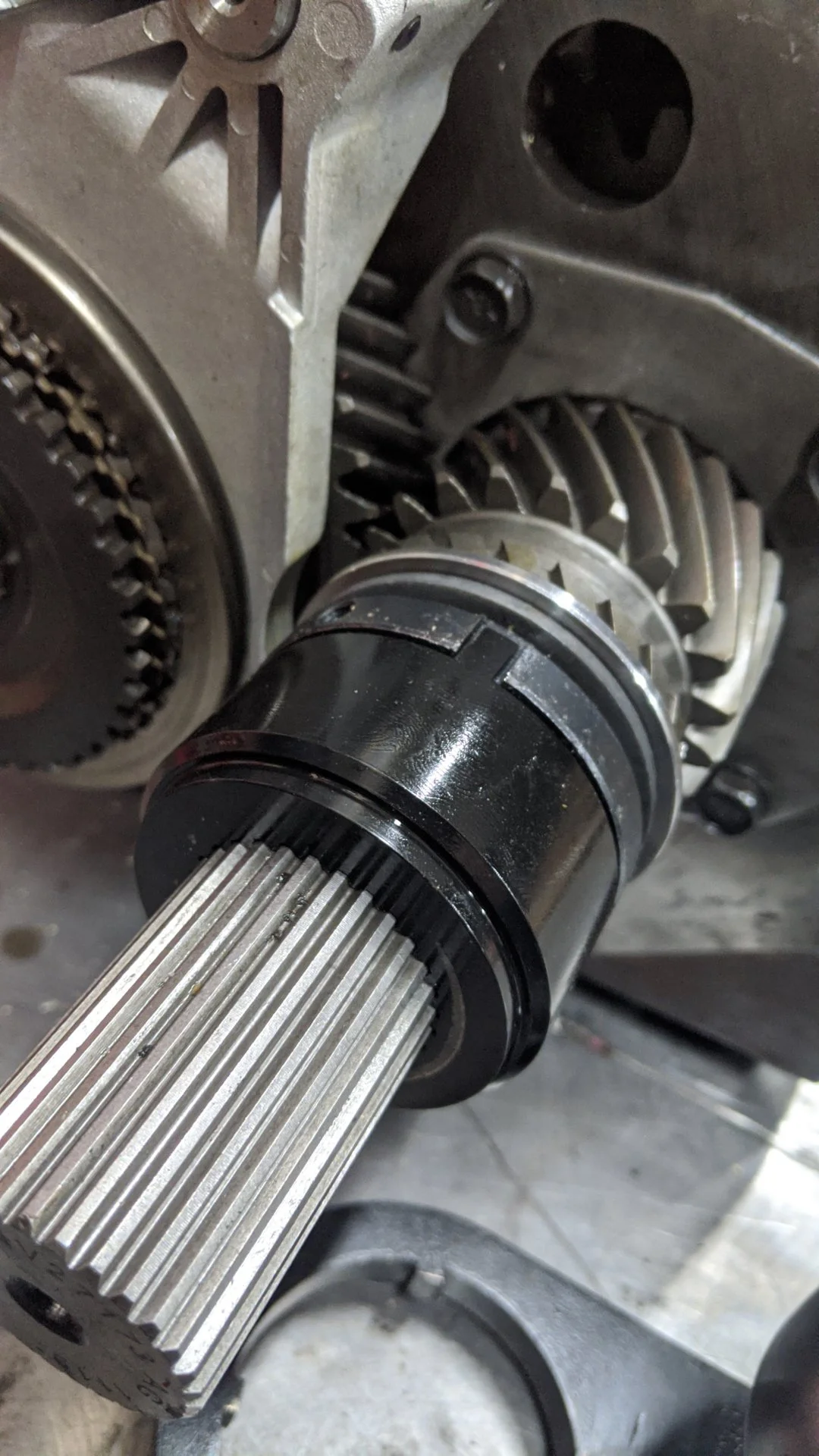

The locking nut has two small brass inserts and two set screws....AND includes this nifty tabbed/splined cap to prevent it from turning. Ideally, this is THE permanent fix for the Dodge NV4500 5th gear issues.
Amazon product ASIN B01M707LD9
The locking sleeve in place...the transfer case input will ALMOST touch this, and keep it from backing away.

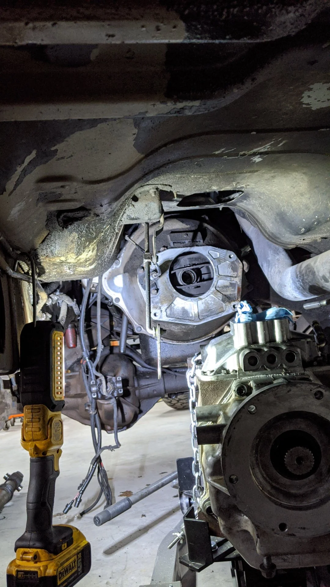

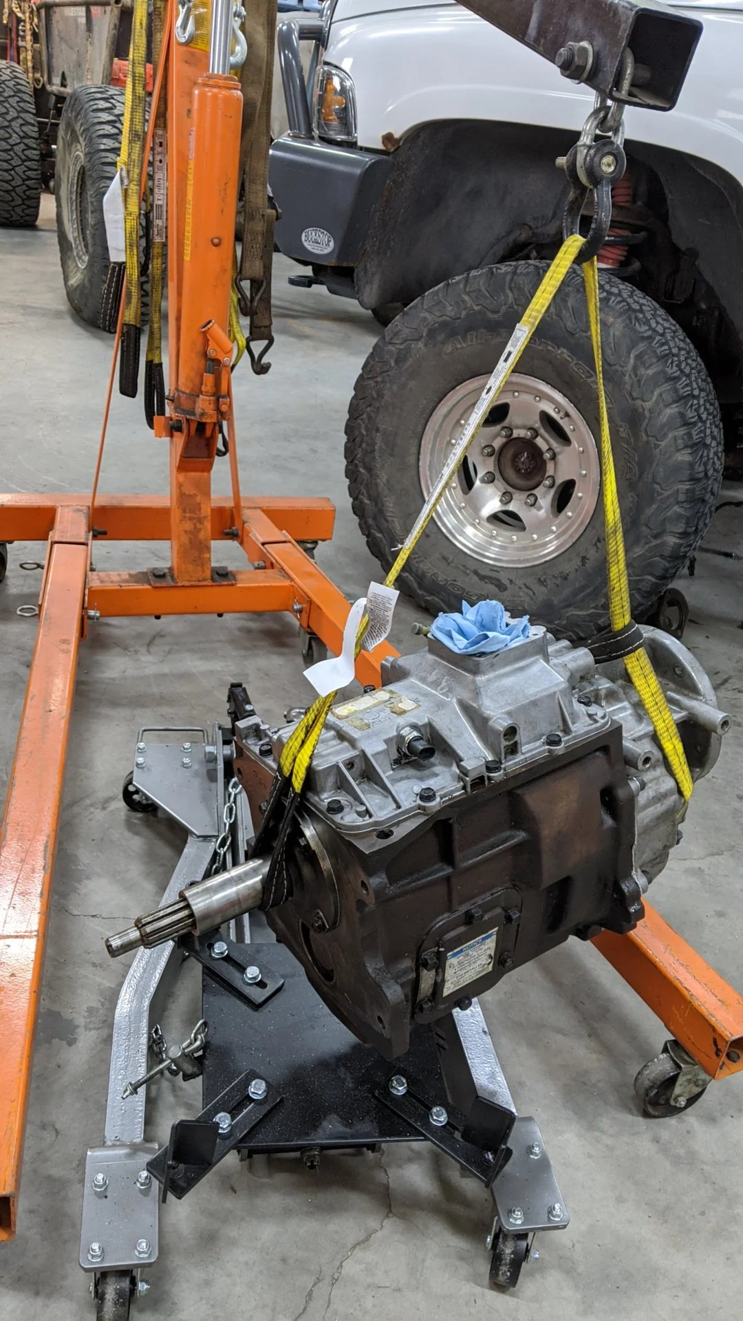

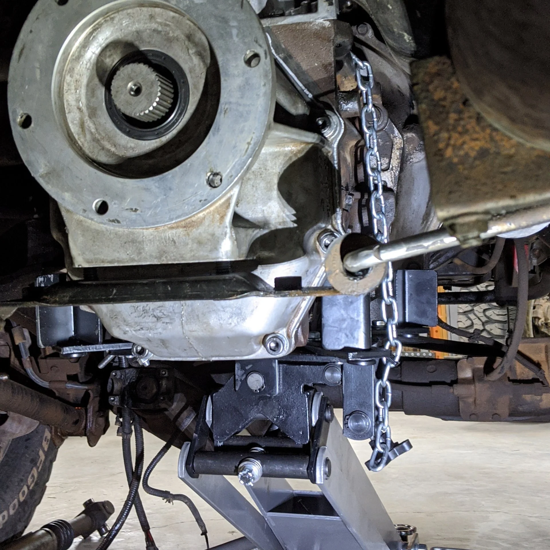

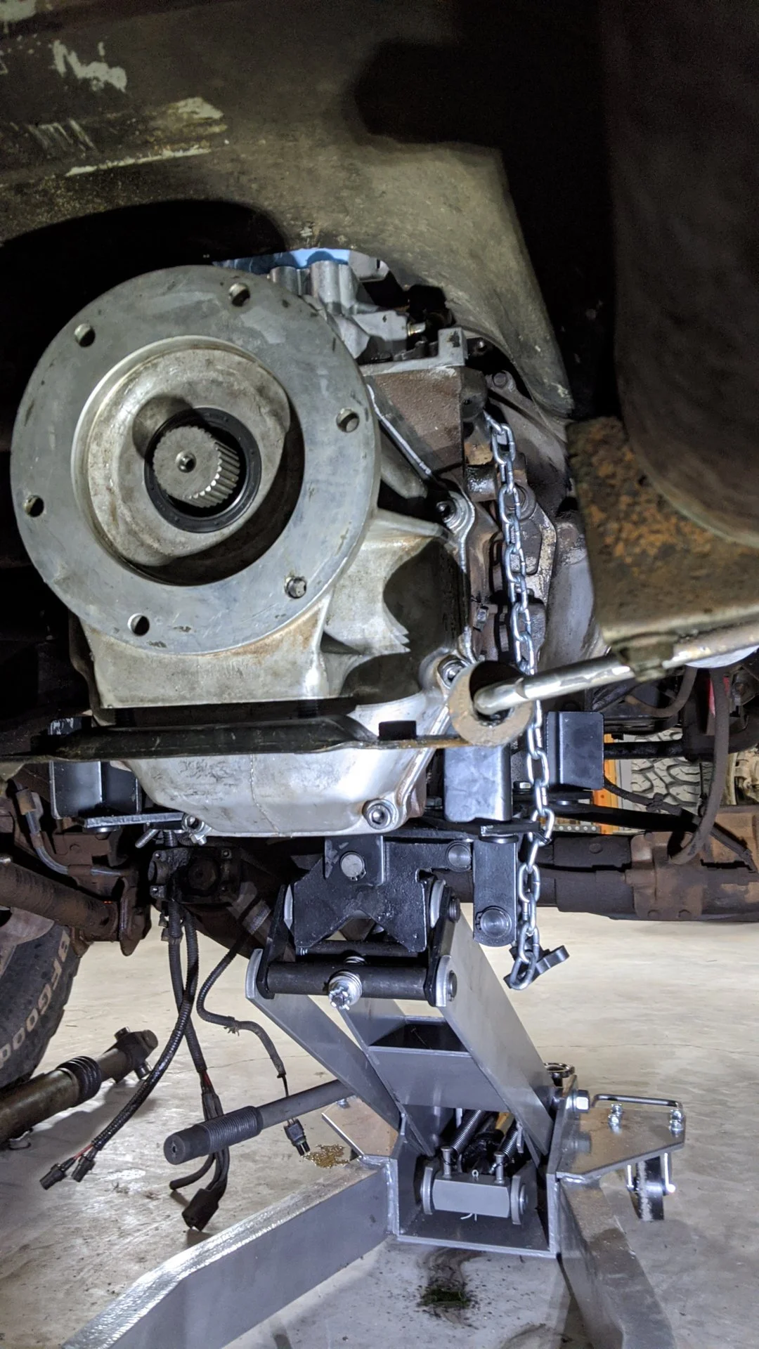

Harbor Freight engine hoist....to a Harbor Freight tranny jack....worked perfectly :)
Get in there!!
Fully expected an hour or more of wrestling....still took some cursing, but 20 minutes of wiggling and adjusting and it dropped right in.
And, it lives!! A few trips around the block (even used 5th a few times!!)....still need to button up the interior and double check fluid levels, but success!!
