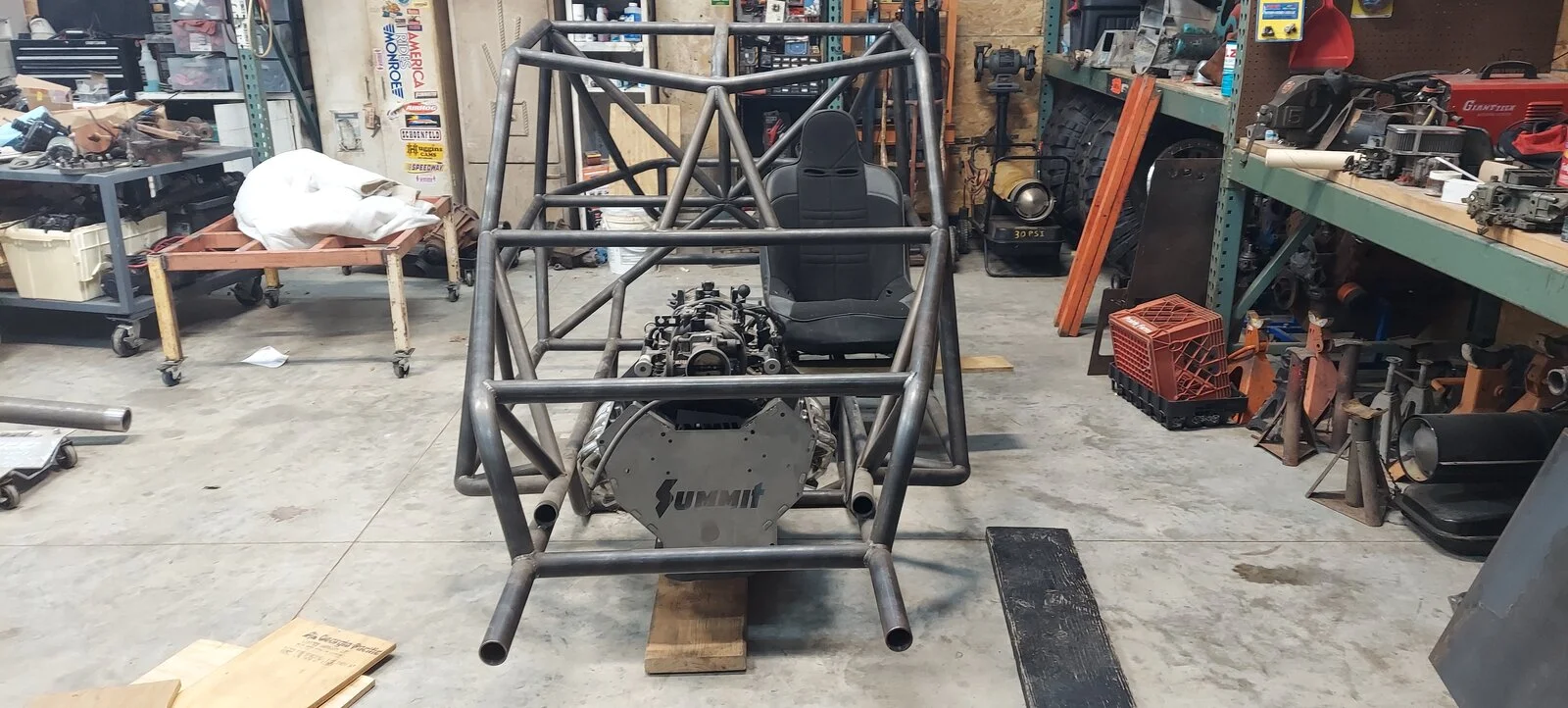

So I have been gathering parts for quite a few years for this build but life got in the way a few times Covid, divorce, my father passing but now that those chapters are behind me time to get back at it. This will be in real time so I will try to keep it updated as I go and appreciate any feedback and tech. Parts i have chassis, 6.0, T400, atlas, 18" ori, 2 drivers drop steering 14bolts, On the hunt for seats first set didnt fit to tall pics to come.

been slow going with the holidays coming up and trying to get my lil plasma up and going mostly just alot of mocking stuff into spaces and getting ideas of how it will fit and where i want the engine to sit

been trying to put a couple hrs into it every couple days after work its been hot af here but making some progress got all the link mounts fullu welded and one axle fully welded hope to mock up engine and trans soon and got a new atlas coming get that stuff in there so i can mount seats and start packing this tuna can

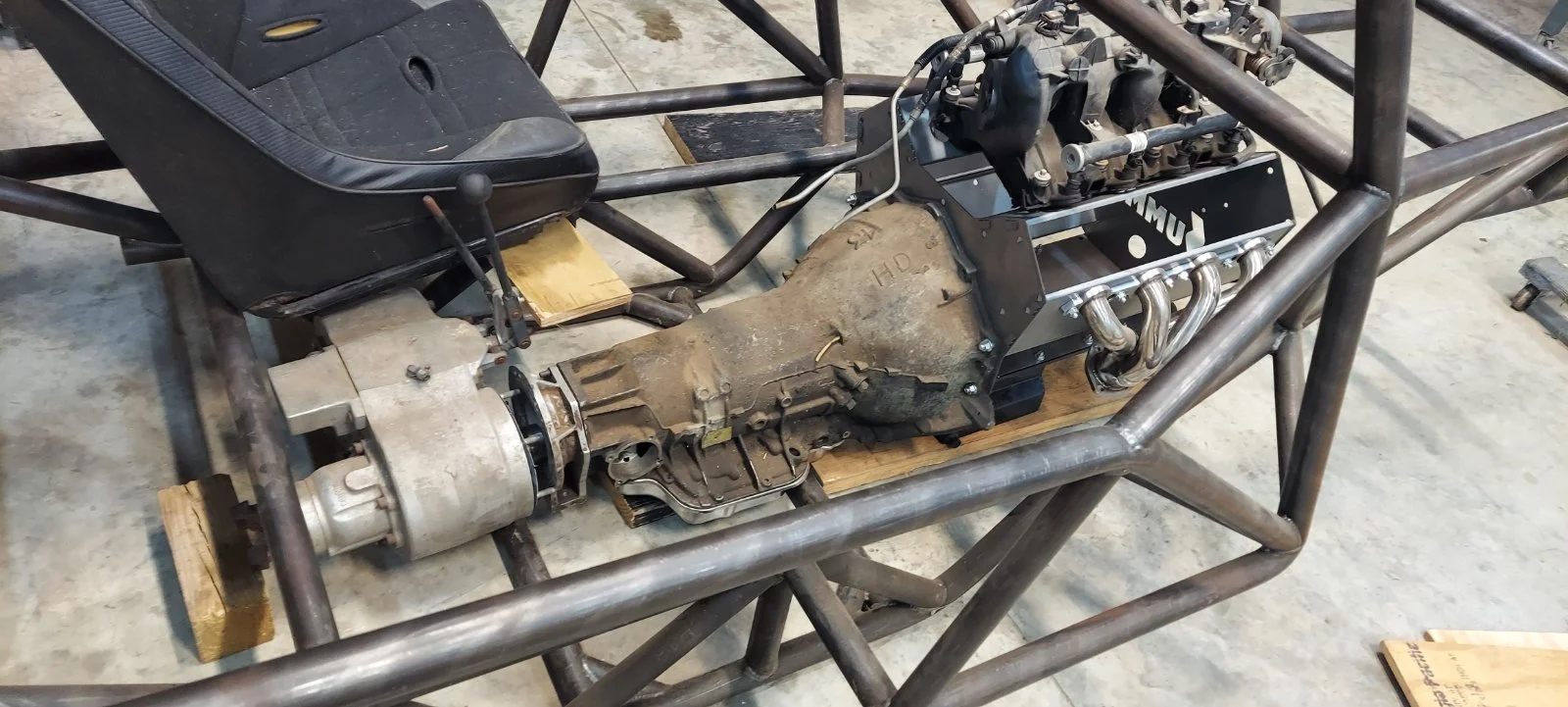

Baby steps we got engine and trans mocked up in it axles are fully welded out waiting on atlas and shocks hope to have a roller soon
