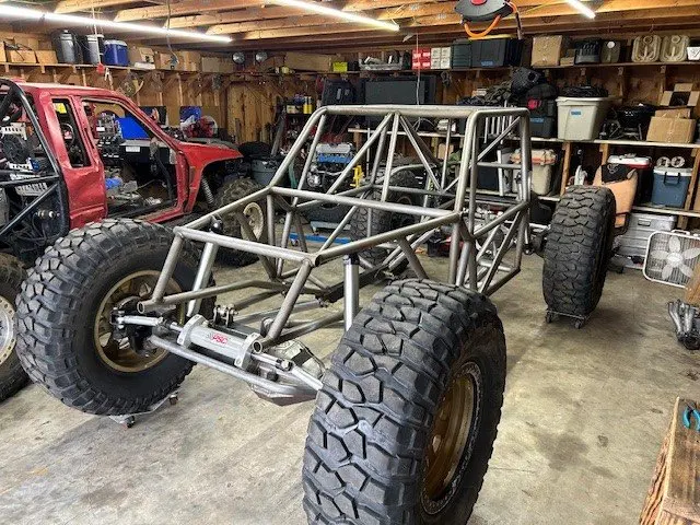

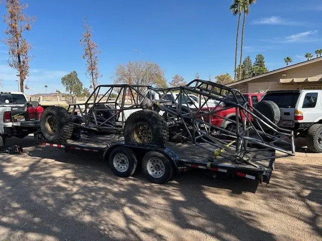

My ol 85 Truggy has served its purpose and it is time for an upgrade on visibility and capability and try not to go broke in the process(unlikely)
Looking for input along the way since this is my first true ground up build..

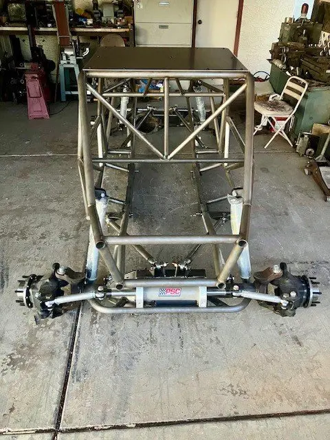

I'll be starting with a Wende XL Chassis from @Adamwende . .
LetzRoll built the axles (both diffs will be offset to the driver side) and I will pick the chassis up as a roller.
Chassis: Wende XL 115" Wheelbase
Drivetrain: 3RZ, A340, Atlas II 4.3, maybe boost it
Axles: LetzRoll Offroad LM1 Steering 10'" with Super Duty outers, Upper and Lower American Iron Ball Joint Deletes, Branik 32 spline outers and Chromoly 1550 Shafts, Gearworks 10" thirds 6.20 gears, PSC 3"x 9" Steering Rams, Radial Dynamics Steering pump, reservoir and rear steer goodies, ADS 2.5" Air Shocks 14" and 16", 2.25 7075 Lower links and 1.5"DOM Upper links
Wheels: BFG 42s on Raceline Avenger 20s, Branik Brakes all the way around.
Other: PRP seats, Winch, Switch Pros RCR12, Baja Designs Lights, rock lights, a couple fluid coolers, minimal gauges, Trail soda Cooler, Fuel Cell, Second Gen Toy skins
Just picking up the ancillary, lower cost items as I go and working on the 3rz/A340/aw4 hybrid transmission while splitting my time with rewiring the Red truck #1 and building 86/96 Red truck #2 and a car hauler rebuild.

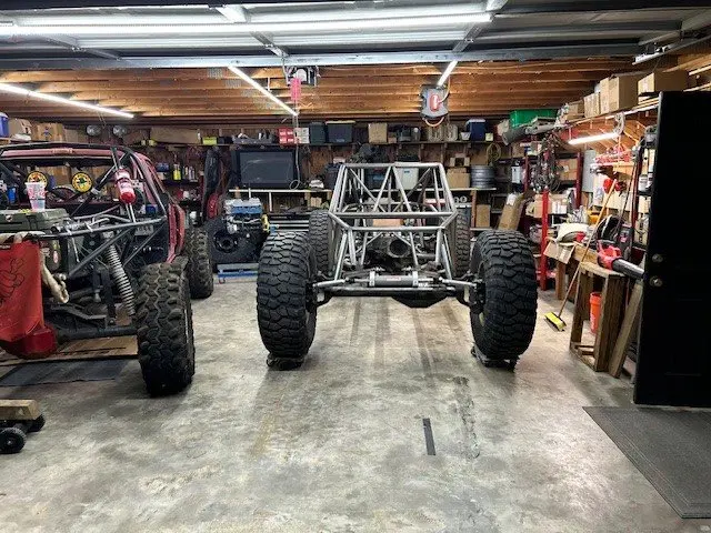

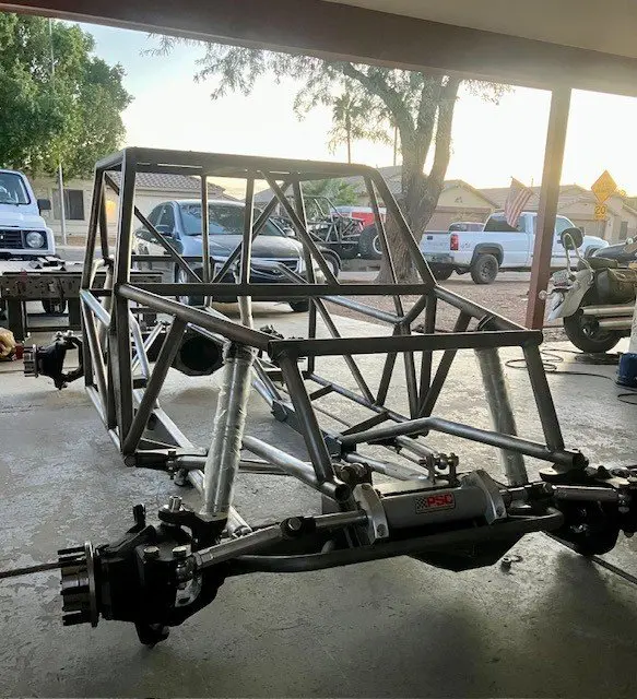

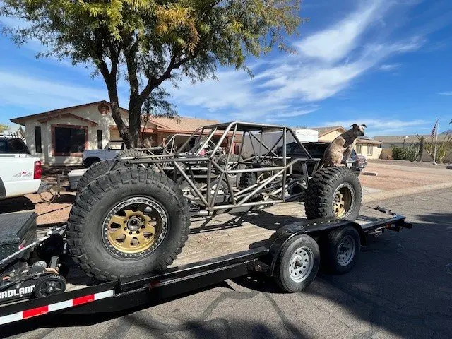

Right now it is at 115"WB, 13.75" Belly at full bump and 81.5" wide with 67" WMS axles.

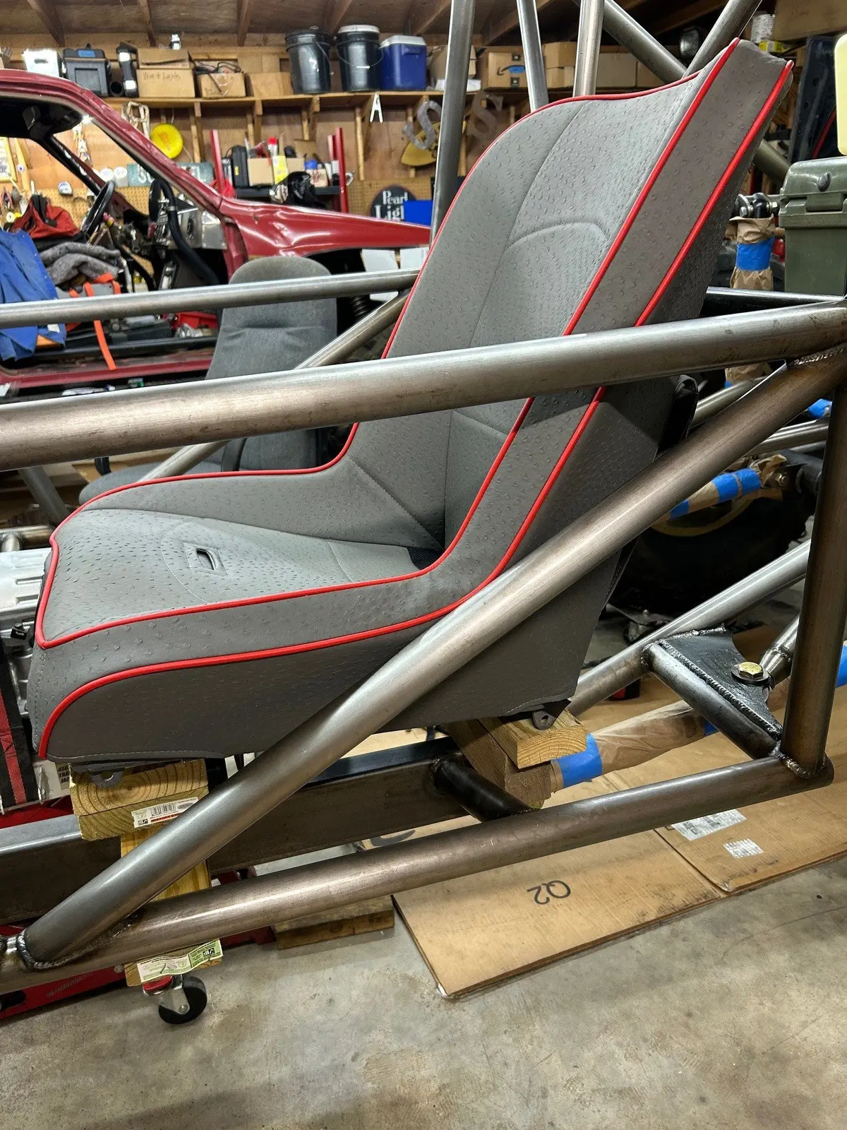

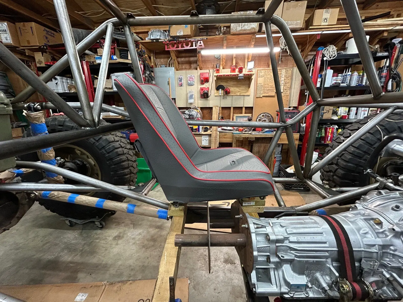

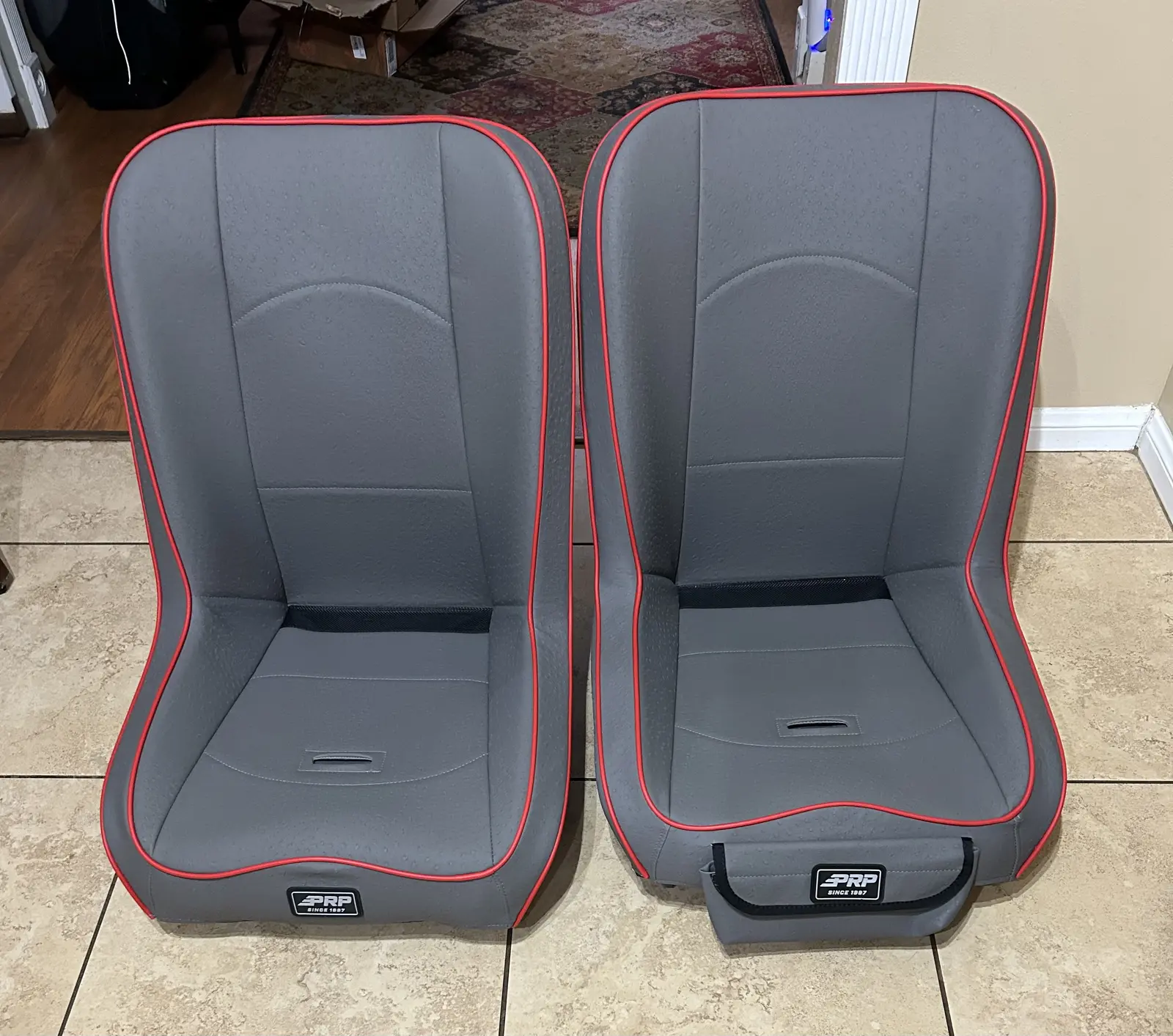

DD lowback seats came in from PRP. Black Friday specials that were 30% off. Dark grey ostrich and Daytona red trim. Added the front goggle pocket to the driver side and the rear map pocket for the passenger side. Both seats got the mesh mud drains. @DirtSquirrel and I made a quick 2500 mile round trip in 3 days to AZ to pick of the chassis from @Adamwende . We had a lot of time to discuss the build. We stopped and picked up a chassis for our buddy at Bent Fab AZ while we were in the Phoenix area. Had to get creative for the trip back home.
The Red Truck is jealous seeing his replacement...

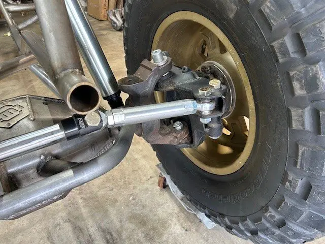

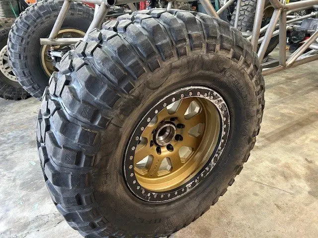

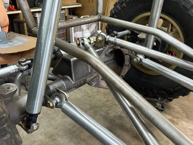

BFG 42's on some Raceline 20x10s, Timken UBs redrilled to 8x6.5

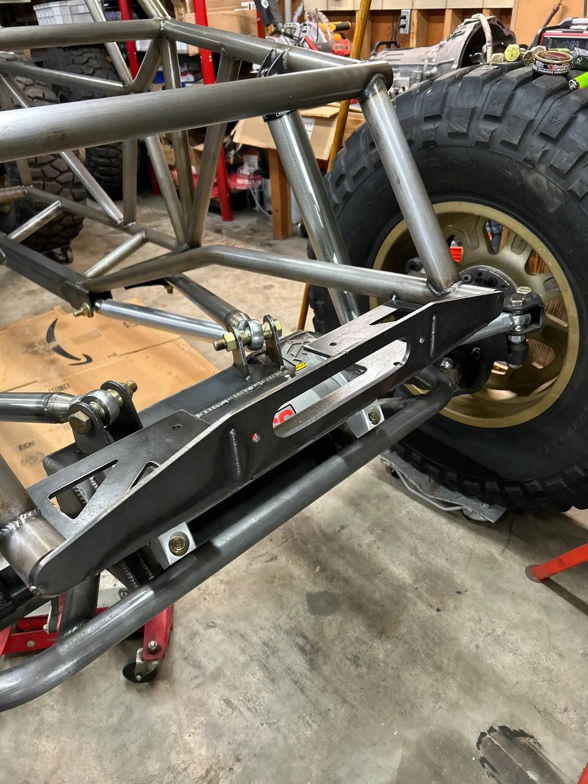

LM1 steering arms, 7075 steering links, American Iron Offroad upper and lower BJEs

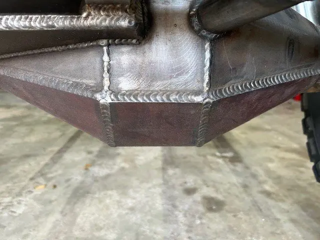

LM1 Metalworks axle housing beef. Lower Pumpkin is 1/2" thick

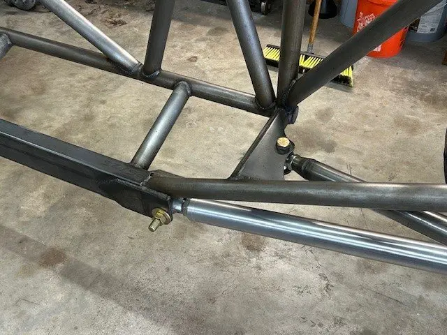

Lower link frame mounts, all of the lowers are 2.25" 775 Aluminum with 1.25" heims

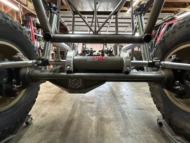

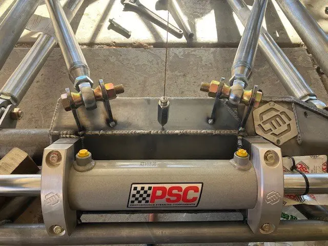

Rear LM1 housing, captured ram clamps, steering links, PSC 3x9 ram
Rear housing and links, 2.5" ADS short bodies all around 14" in front and 16" in the rear.

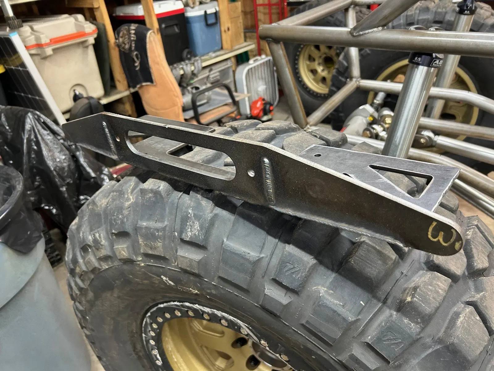

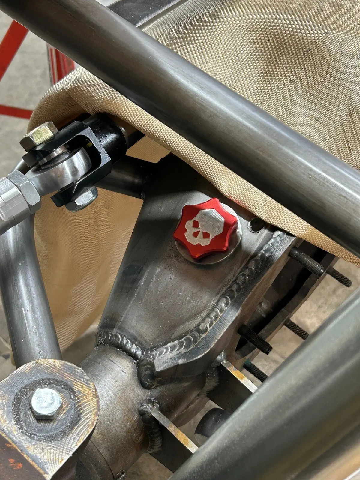

Winch Mount
Fill plugs front and rear

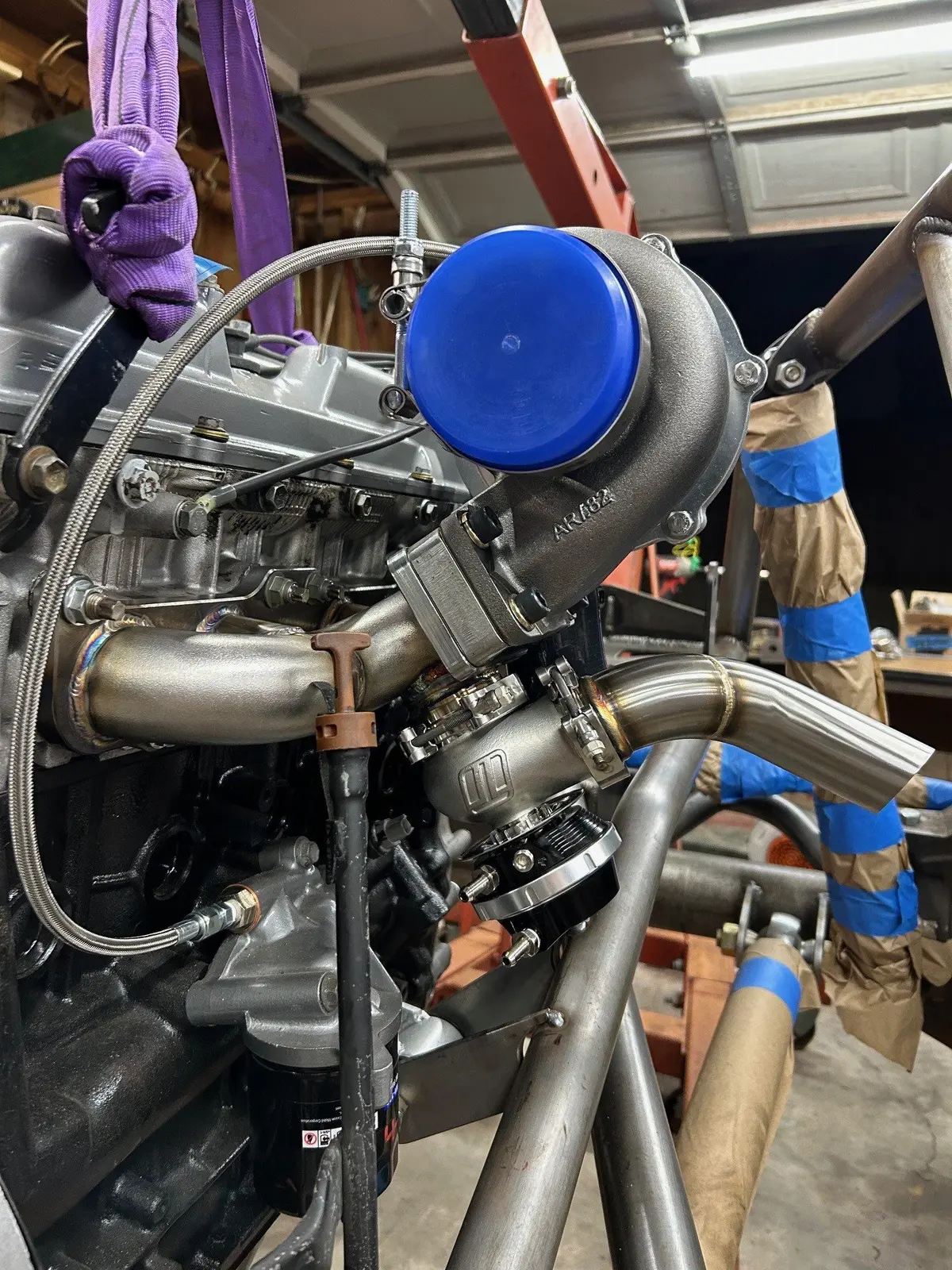

After talking with Gabe at SNP, I've decided to Boost the 3rz. Collecting more parts now.
750cc injectors, Pulsar 3067 T3 turbo, GLFab manifold, 44mm WG and all the other stuff will start trickling in.

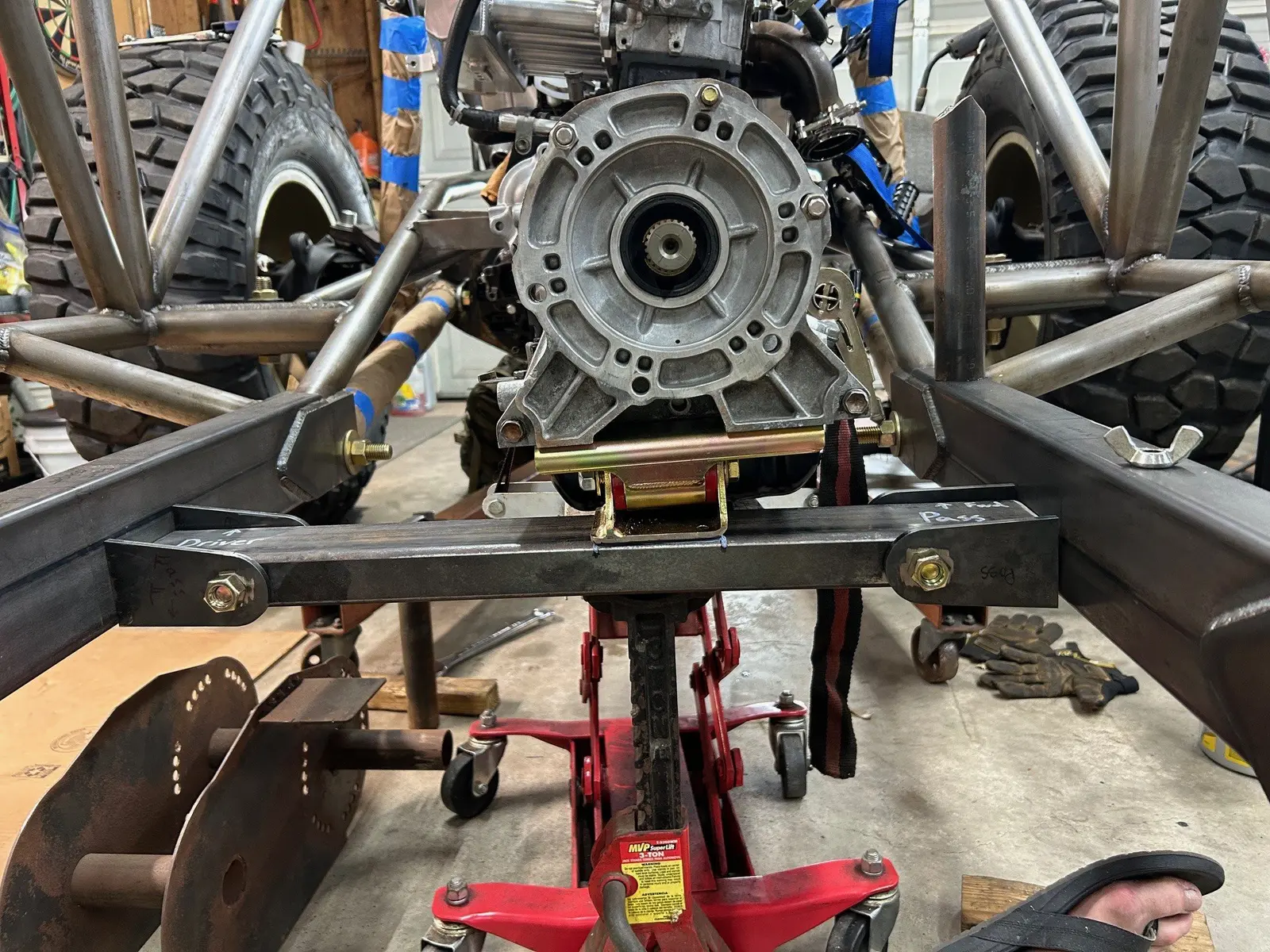

I'm still waiting on my transmission to get back from the rebuild and output shaft/tail housing swap.
I'll get that mocked up and measure my clearances for my Atlas and front driveshaft.

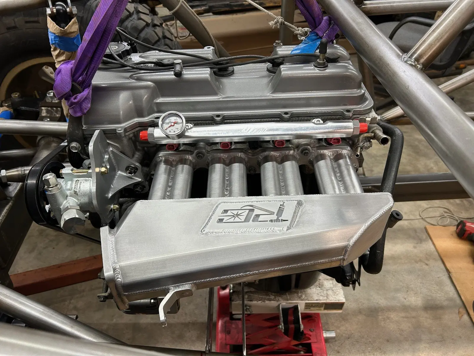

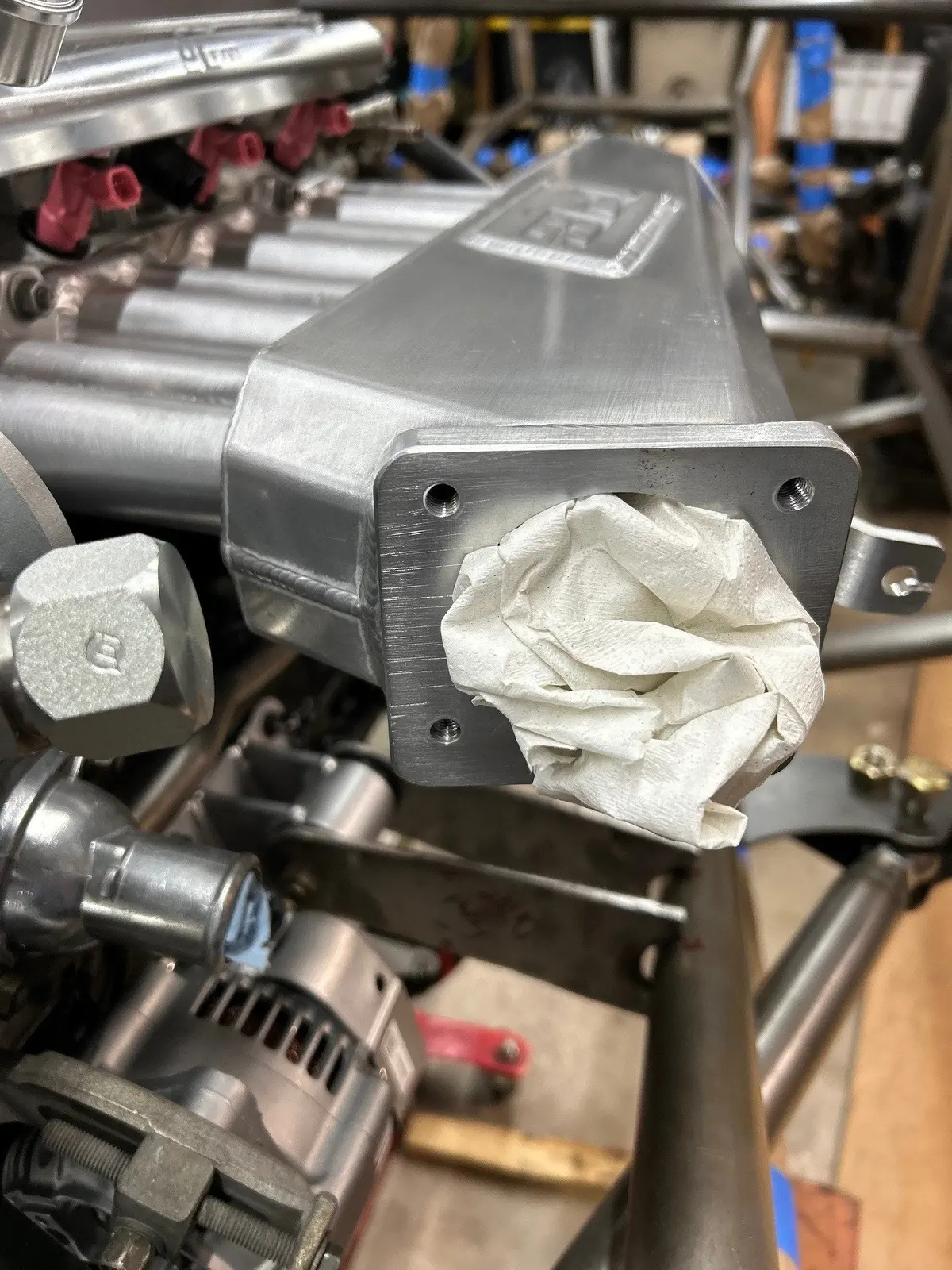

The forward facing intake showed up this past week as a birthday present (to myself) hopefully it all clears the TB.
Also shown is the Bling RZ fuel rail from GLFab.

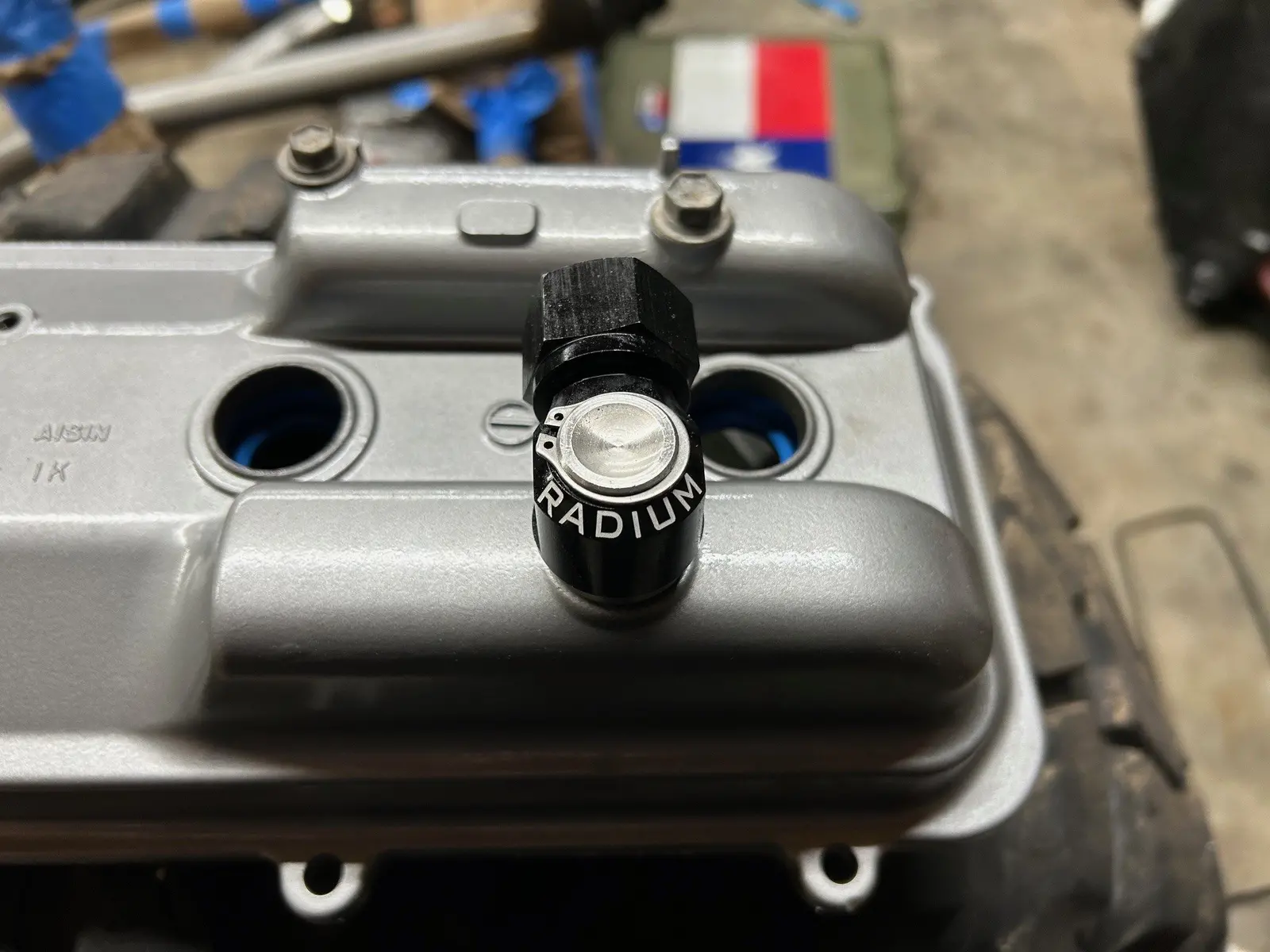

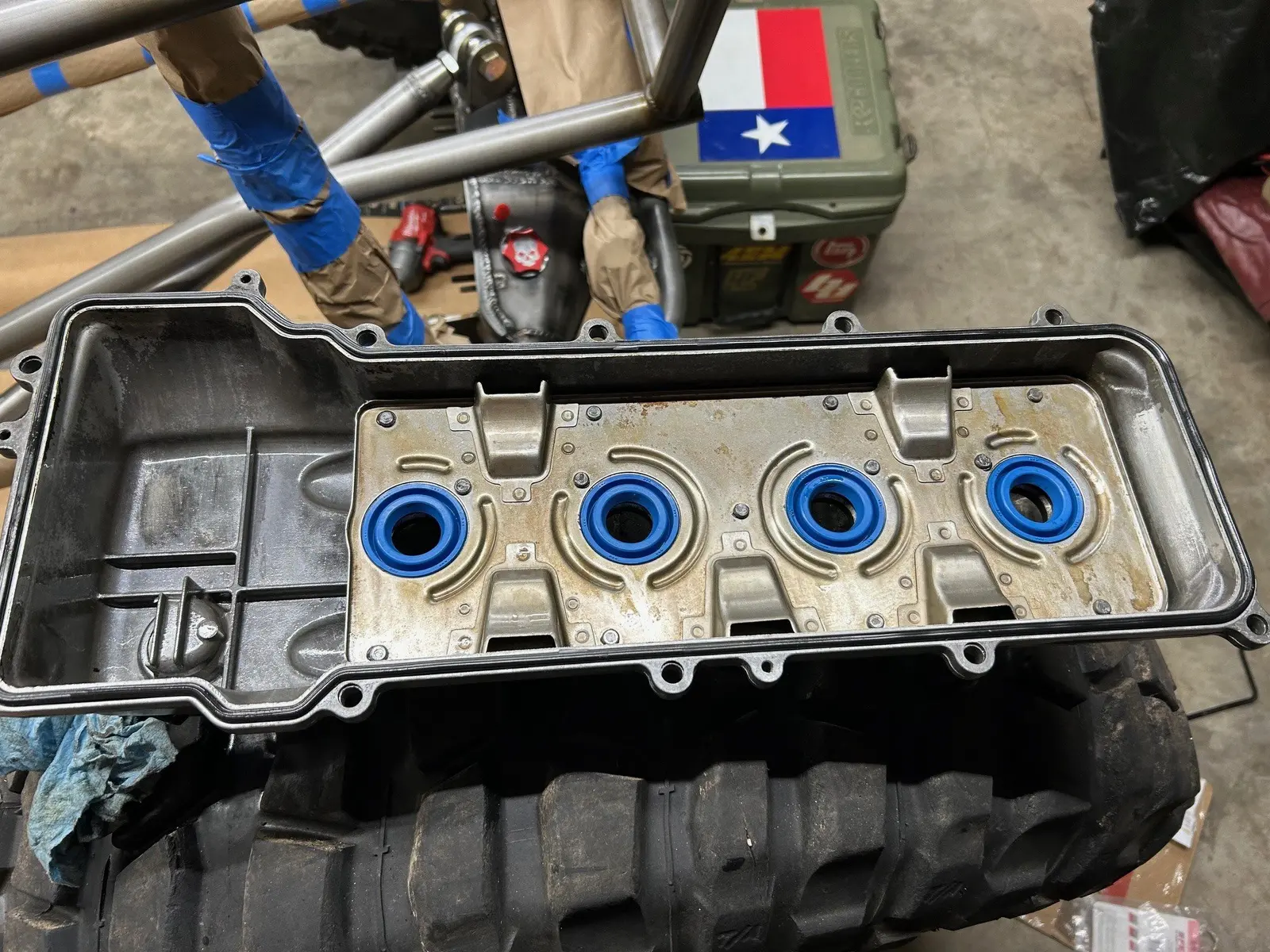

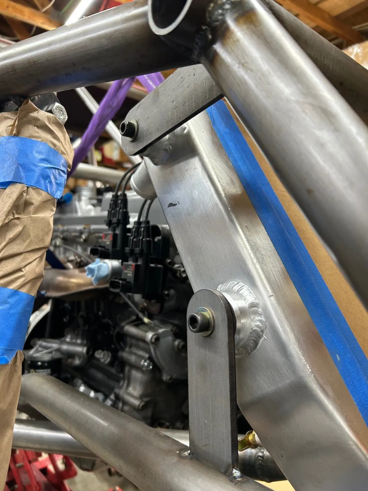

Installed a Felpro gasket, Felpro plug seals and a Radium 10AN swivel fitting on the valve cover

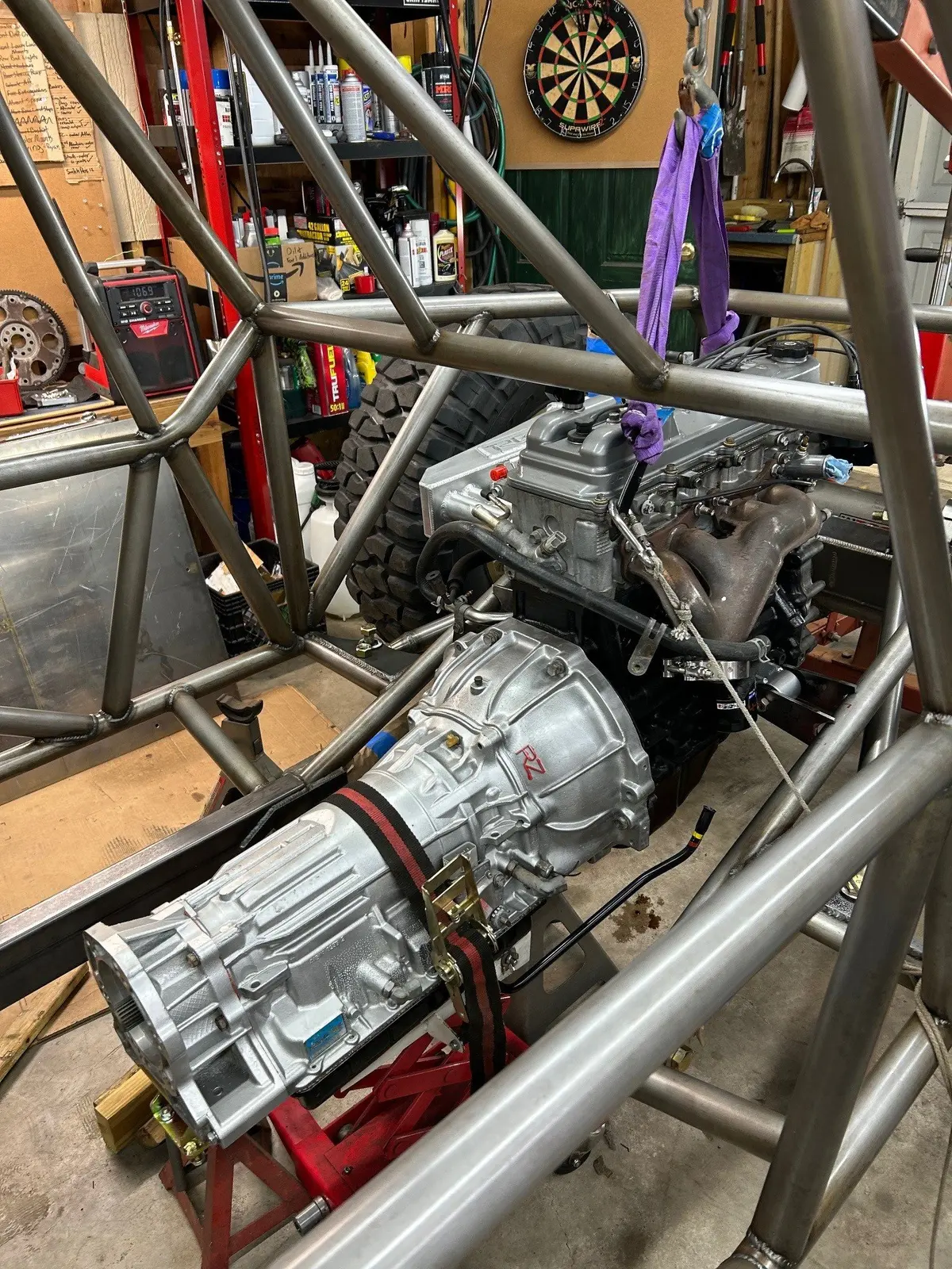

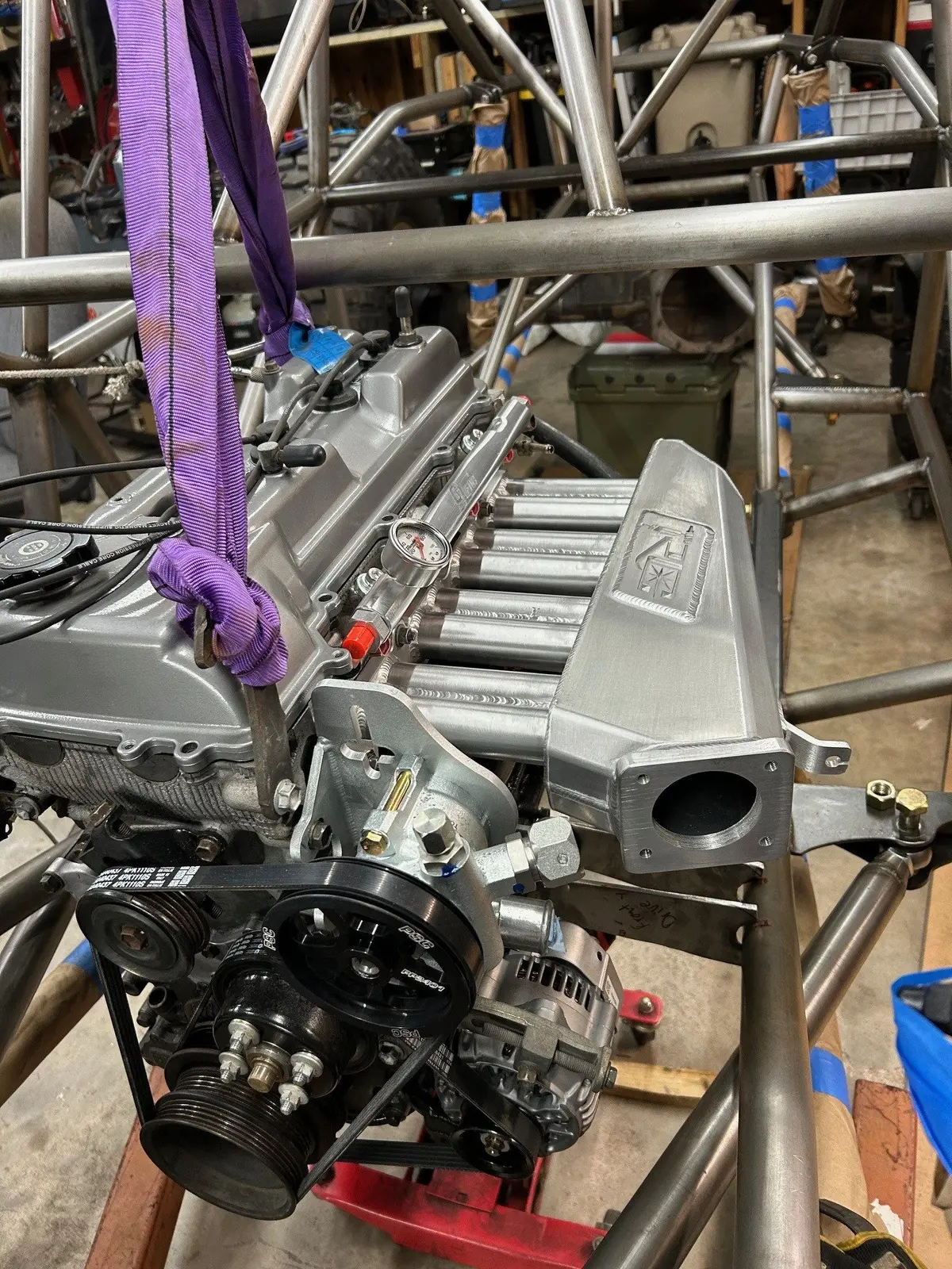

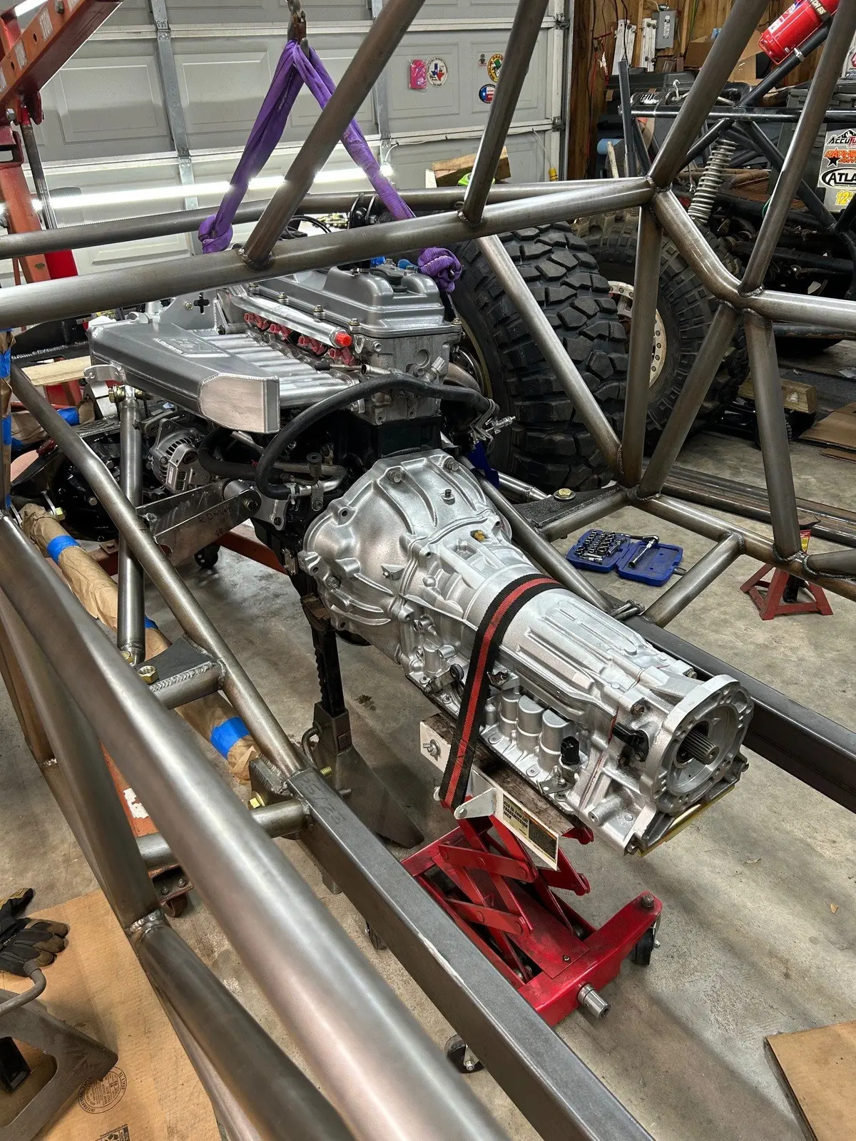

I finally got my A340/AW4 transmission back from the shop. I ended up getting it fully rebuilt along with a new Torque converter.

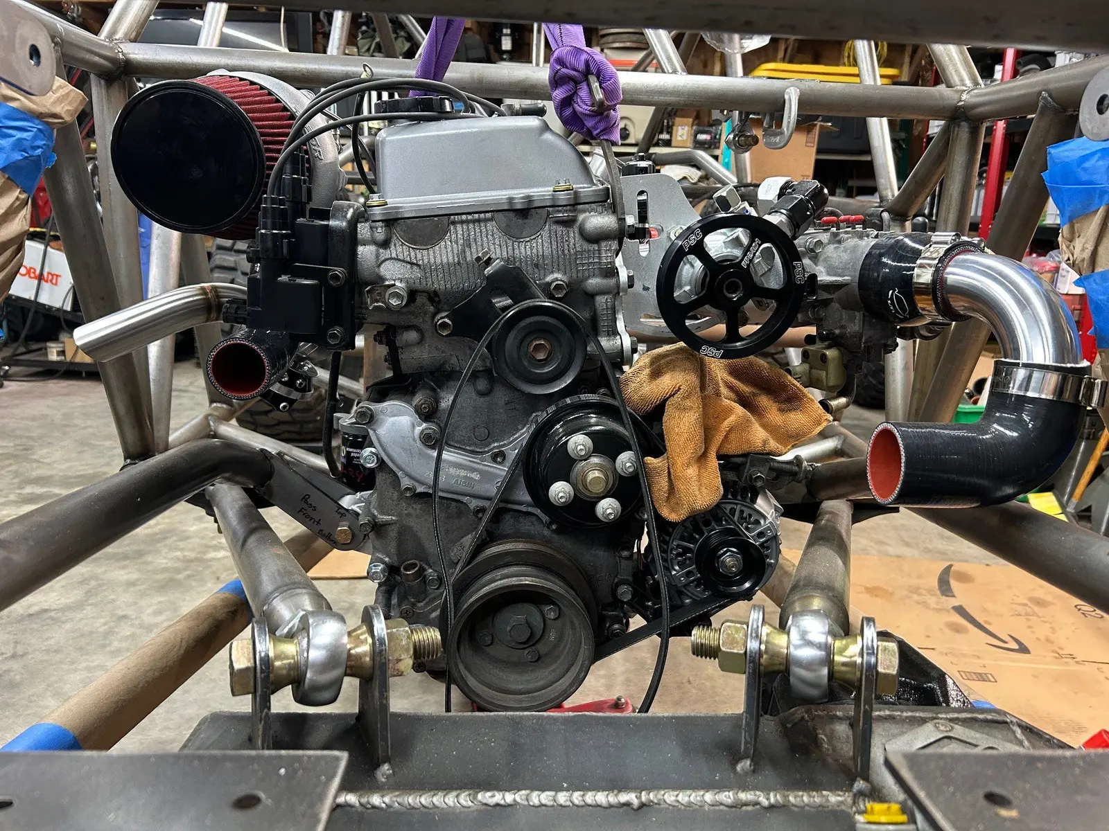

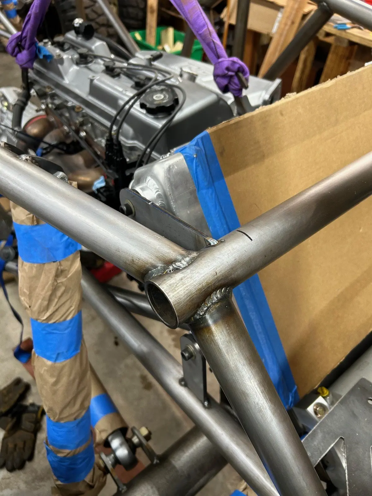

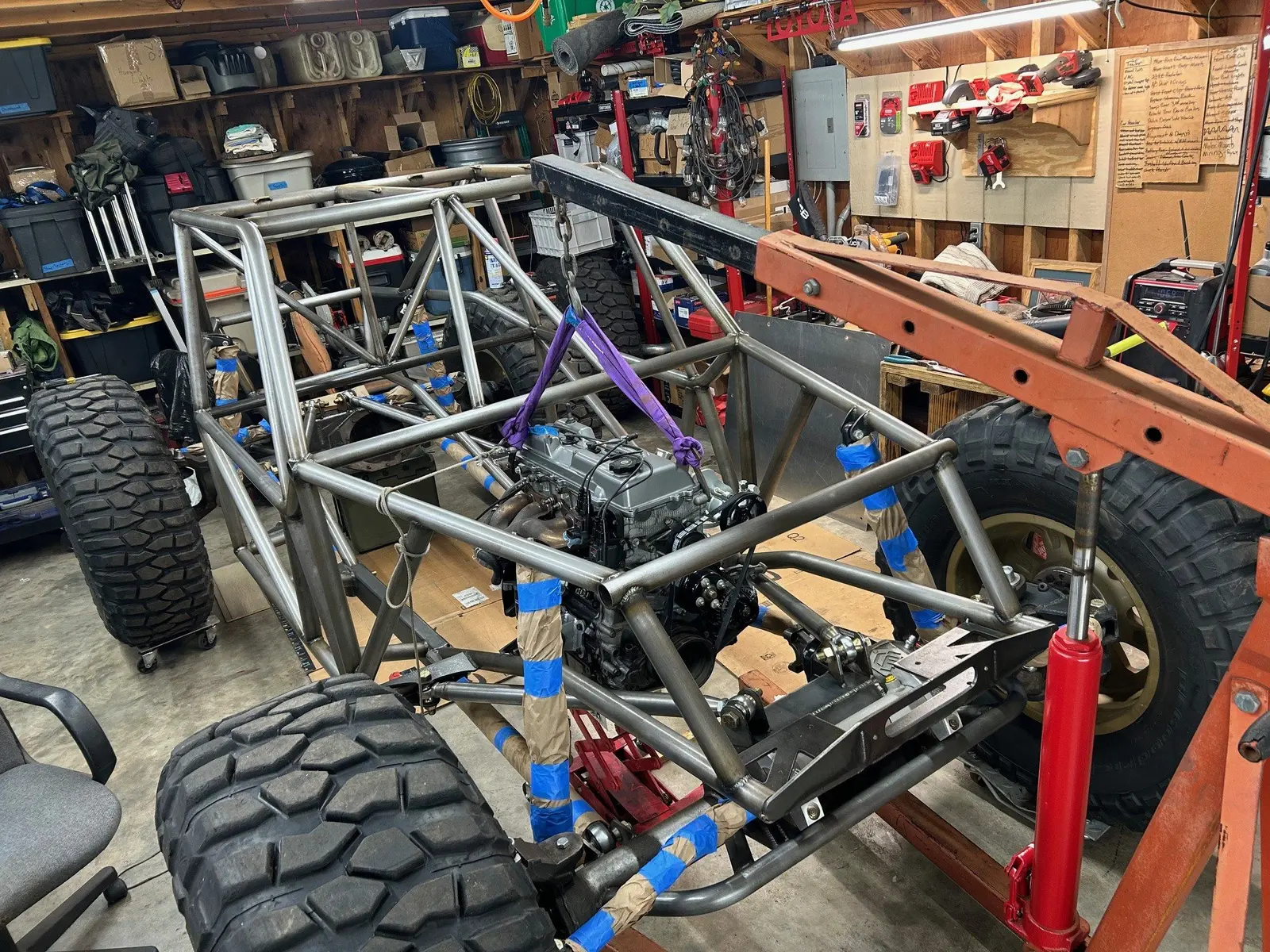

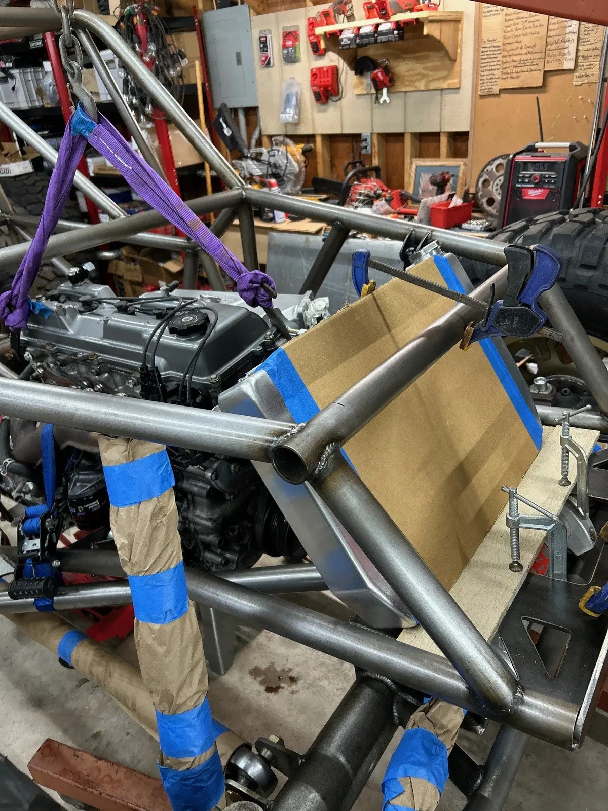

I started the mock up process last night and am pretty happy where everything is positioned. I have about a 1.5" clearance to the bottom of the subframe and adequate room to fabricate a skid for the rear sump RZ oil pan.
For those who haven't dicked with an 2/3RZ, the valve cover does not sit level in the engine bay. It took a little persuasion to get the engine cocked over about 15 degrees to level out the transmission. The bellhousing is basically even with the front upper link mount locations. I'll need to tweak my motor mount concept a little better.

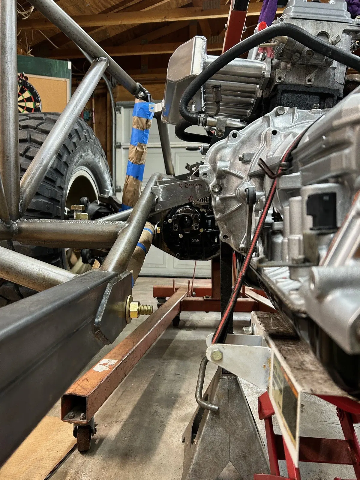

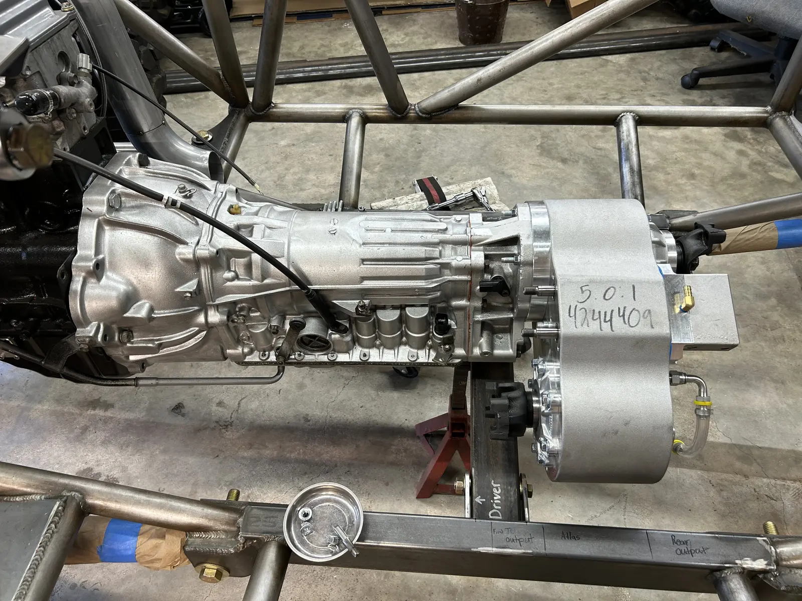

Borrowed a mock up Atlas from a buddy. Drivetrain is offset to make a little room for the Atlas.

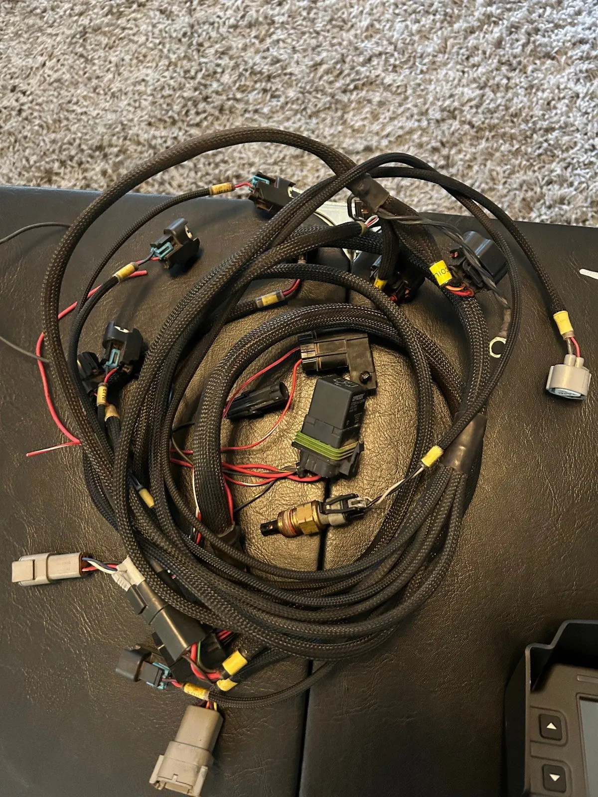

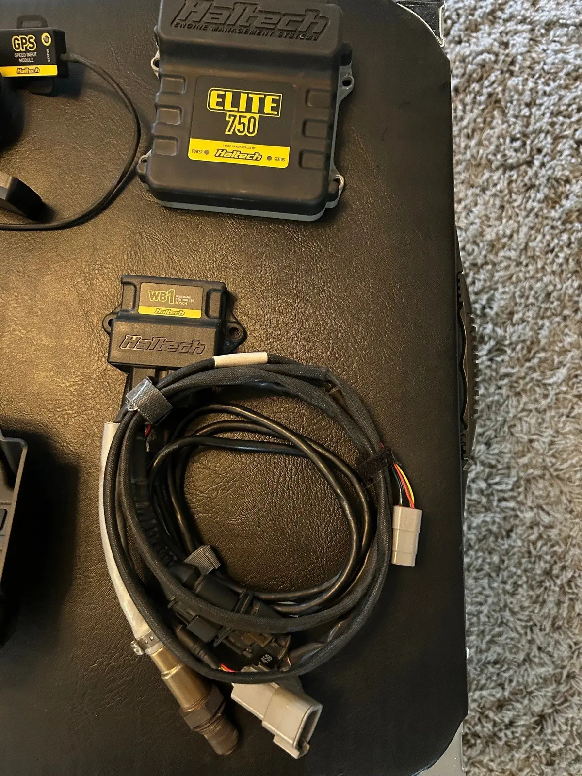

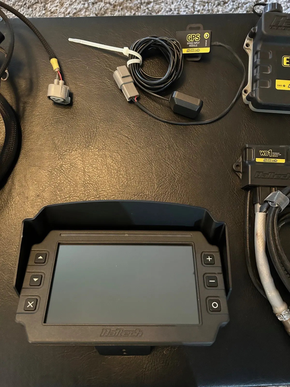

All my Haltech goodies came in this week. I bought it second hand off a twin coil setup out of AZ.
IC-7 display, Elite 750, SNP standalone Harness, GPS speed module. Going to go with Five-O motorsports 850cc injectors instead of the ones from SNP. They come flow tested and grouped along with all the info I need to plug into the Haltech 750.

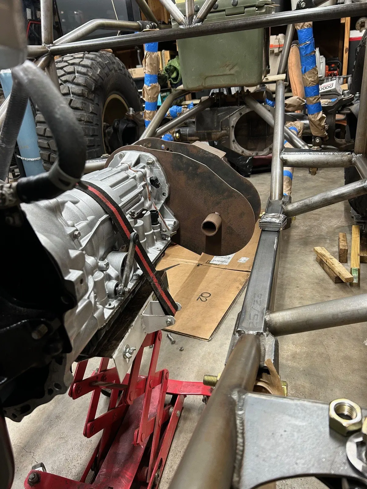

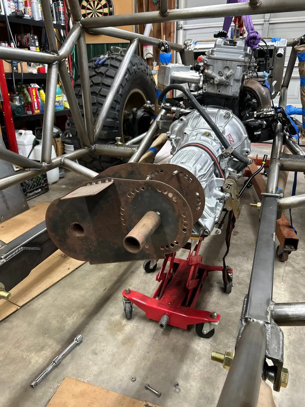

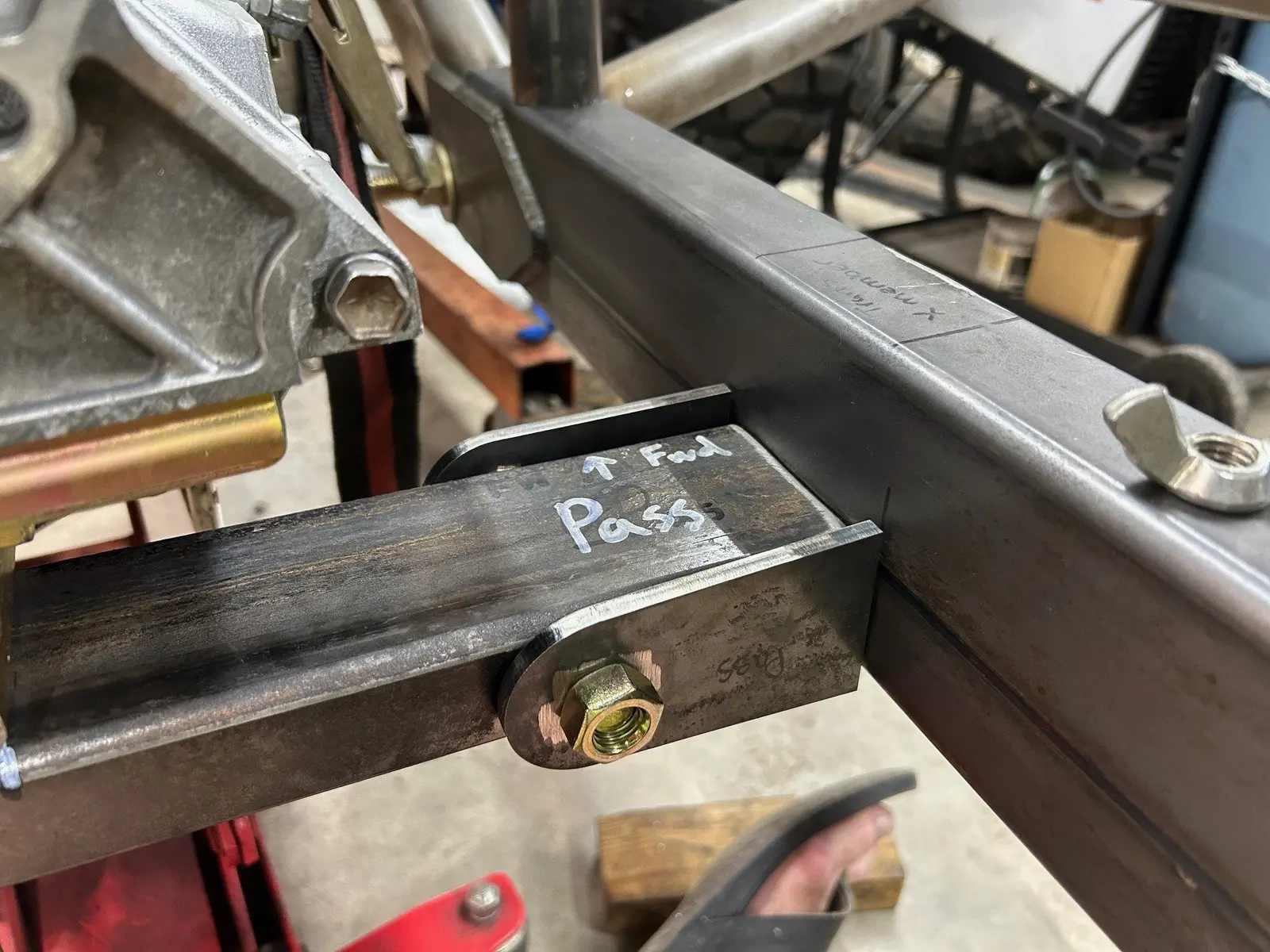

Fabbed up my Trans support. 2x3 x 0.25wt, slugged the holes and 1/4" mounting tabs sitting flush-ish to the lower 2x4 frame.
Not tacked yet but it fits.

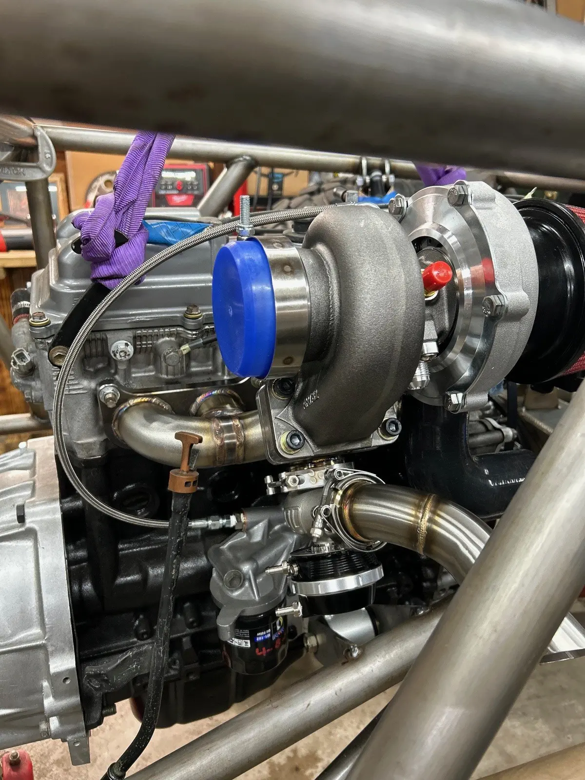

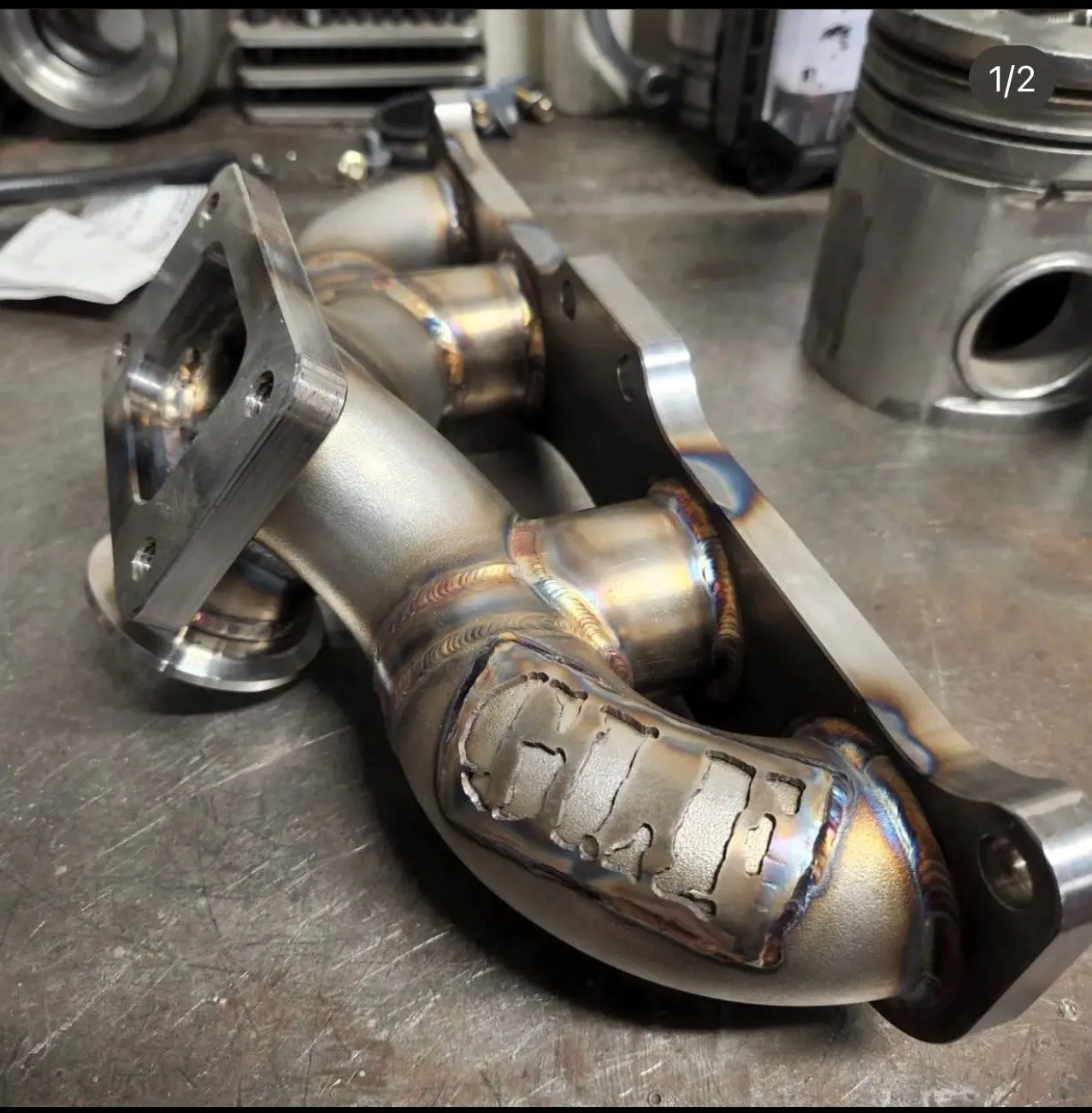

The GLFab Exhaust manifold came in last week. He really does a great job on these. Naturally I had to throw the Turbo on for good measure..
Pulsar 3071 Gen 2 - Seems these are the ones getting popular with the guys boosting 2/3RZs
For the price I gave it a shot..
I found a Turbosmart Hypergate45 and a eBay special 44mm exhaust pipe to use.. Not in its final orientation yet.
Considering a 3 port boost controller but need to look into that some more and how it integrates on the Haltech 750, If not, I'll use the manual Turbosmart on I have on the shelf that I never used for my other truck.
The T3 Spacer is on for now to buy some needed clearance for the coil packs in front of the Air filter. Those may get relocated. The spacer does buy me some room for the Turbo oil drain though. The air filter may need to be extended and routed differently, but that is where it will live for now. Now that I have a reference; I can pull the pan, install the 10AN bung for the turbo drain and plumb that up.
I also got the 4AN oil feed plumbed up from the oil filter to the turbo with a few fittings.
Air charge from the turbo is 2" moving to 2.75" at the throttle body. I hope it is able to clear the accessory drive and fan on the radiator. I still need some more parts to check that. May get my buddy to tig me up a shiny piece when its in its final configuration.

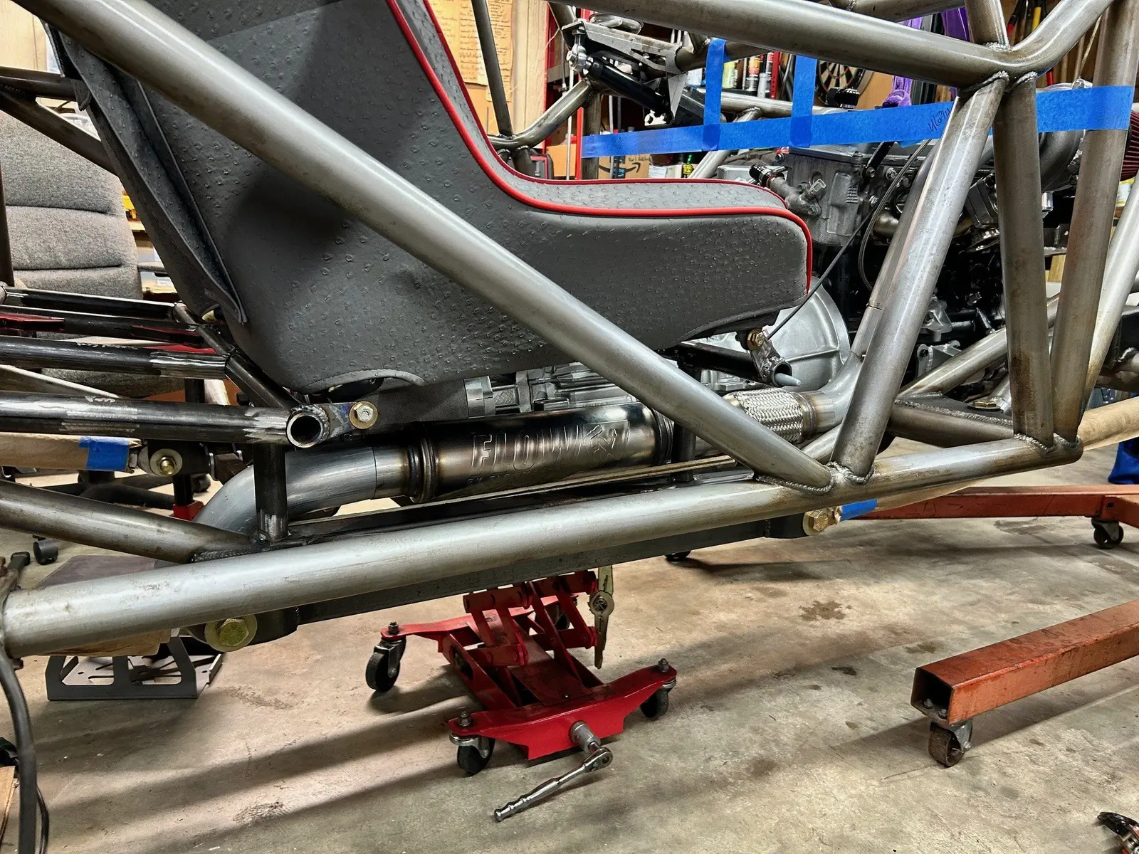

Exhaust will be 3in all the way out through a Flowmaster Flow FX muffler. It should be nice and ricey..

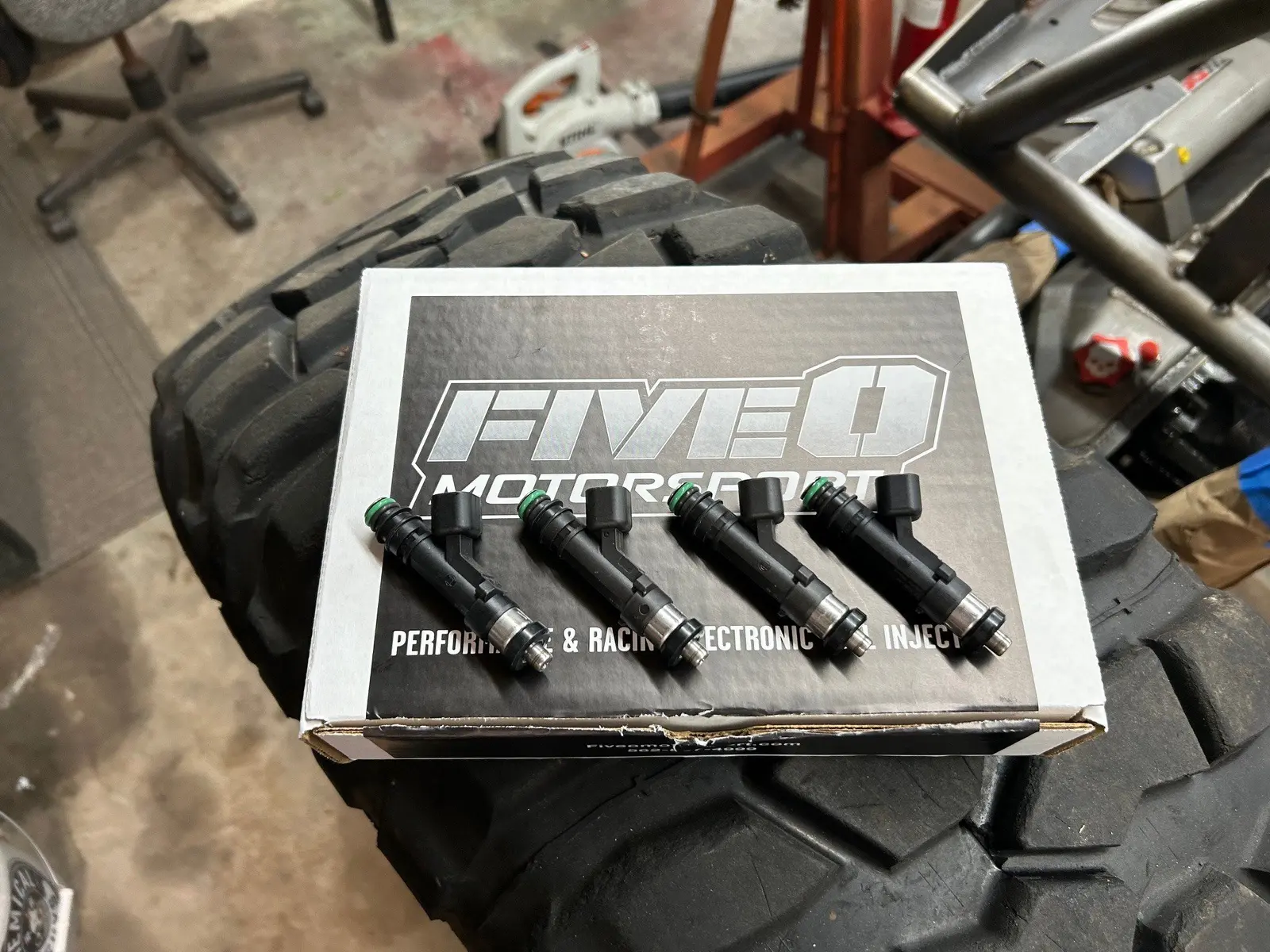

750 cc injectors from FiveO in and installed

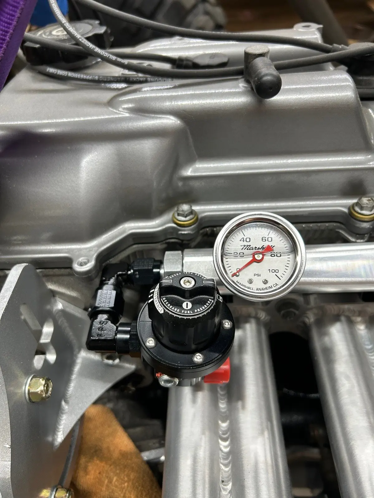

I splurged on some Radium goodies for the Fuel System
Direct fit FPR to the Fuel rail and 100 micron Fuel filter for upstream of the fuel pump.
Haltech Goodies... Elite 750 And Wideband
IC-7 Dash for all my digital gauge needs

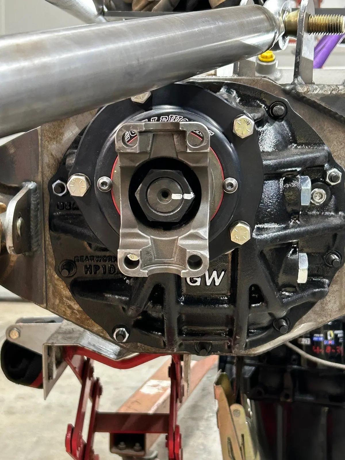

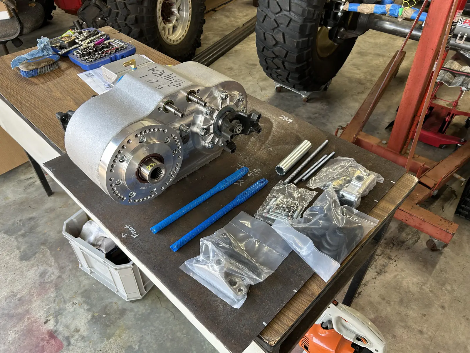

Atlas came in earlier last week and I finally got a chance to swing by and pick it up.
Promptly got it unboxed and stabbed into place.

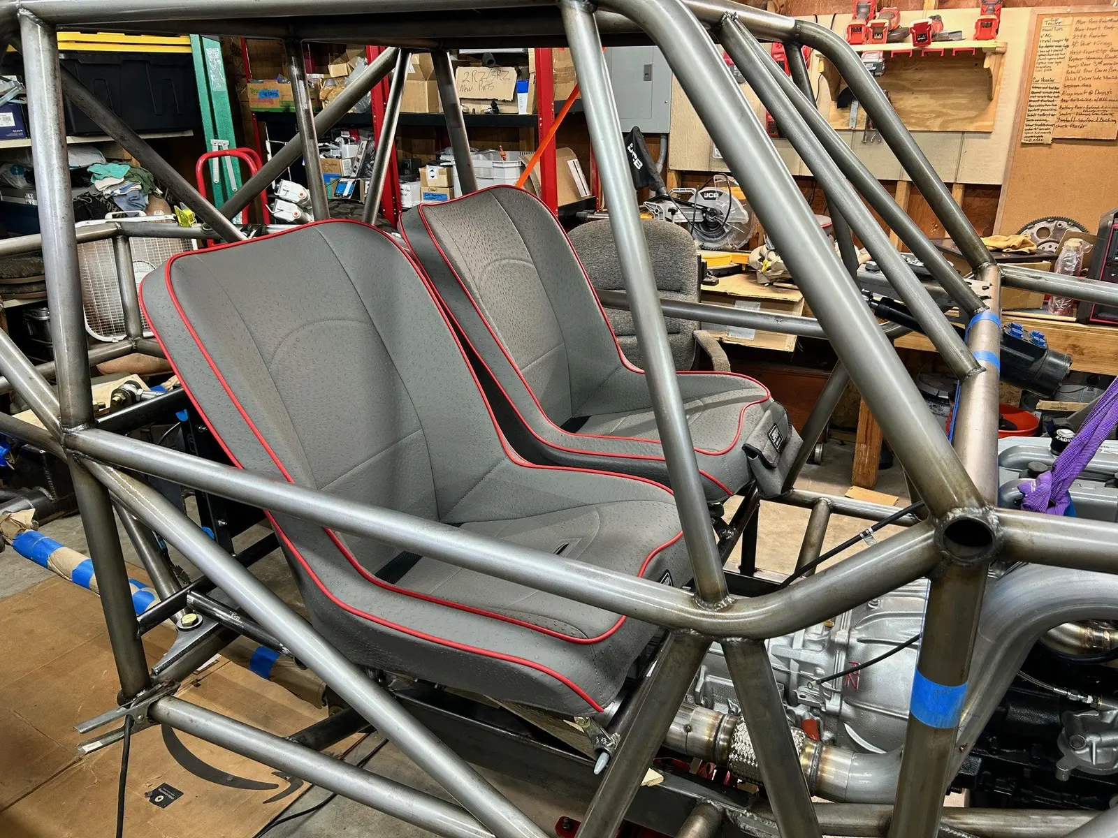

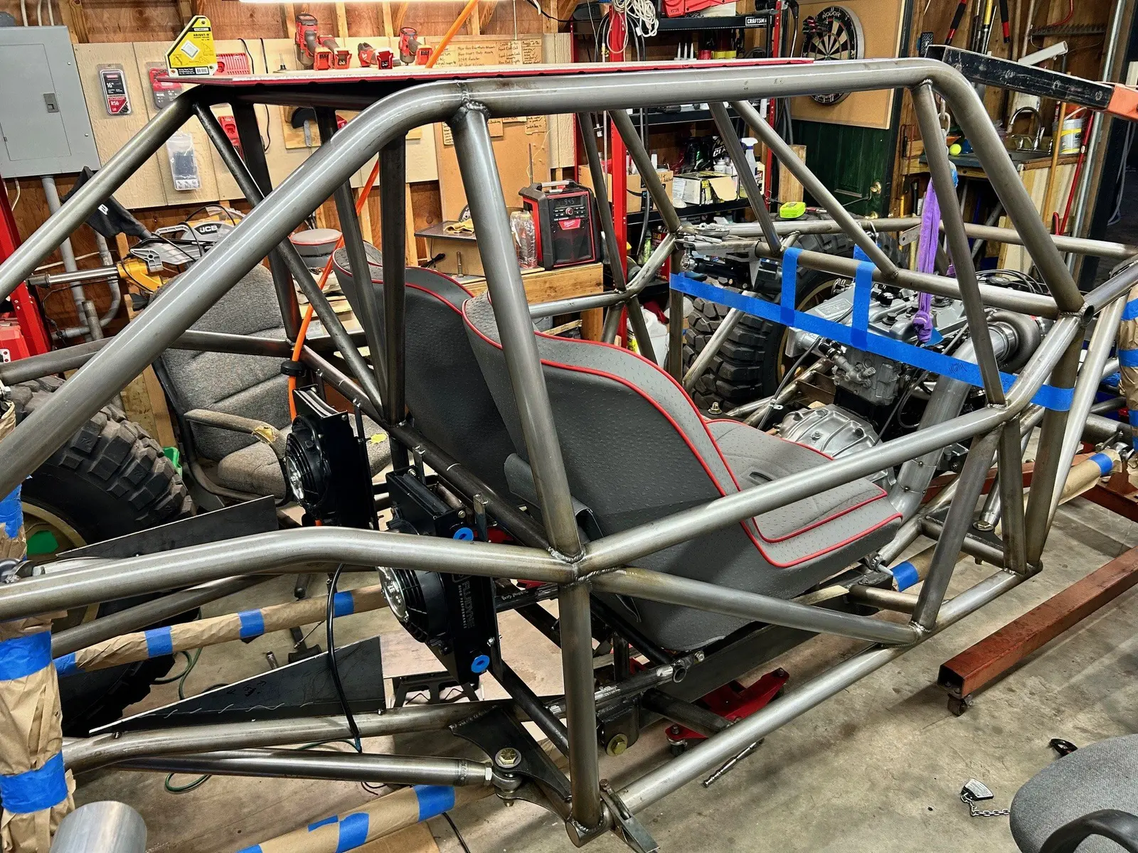

I mocked up the seats and mounts. 1st try was with 1.75 DOM tube, FAIL. I wasn't happy with the height. No pics because time and material wasted lol.
I'm going to rework my Trans Xmember and try to lower the transmission and clock the atlas almost flat. Second try was with 1.25 DOM, this seems to be the path forward. I cut the tacks last night and moved it towards the rear to get the seats down about 3 inches. There is still a little more to be had. Planning on integrating the Atlas shifter mount to the the front seat mount tube. looks like there is room and they will be easy to reach and out of the way of my right leg. .
Might as well get as low as possible. I found some rubber vibration mounts at McMaster with 12mm x 1.75 studs to thread into the tail shaft housing and will make a base with some 3in wide channel iron (or something similar) which will mount to the top of the Xmember. (Thanks Nathan) The current rear trans mount is just too tall an this will buy me another inch or so. This will hopefully get the seats in place and at an acceptable height.
Also, tacked in the orbital mount and column mount assembly just to see where it's going to live. I may need to move up to a 12in steering column from the 9.5" one I currently have or just modify the column mount I currently have.
Squish those seats in the press and you'll drop your butt down, add thigh support, and your back will appreciate it. I squished mine 3".
Finalized the seat mounts (I hope). I ended up lowering the Trans X member and using some 1.25" DOM to lower the seats in the chassis.

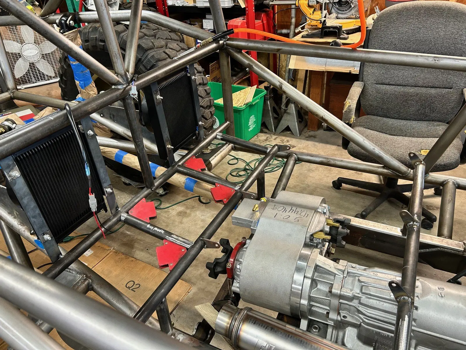

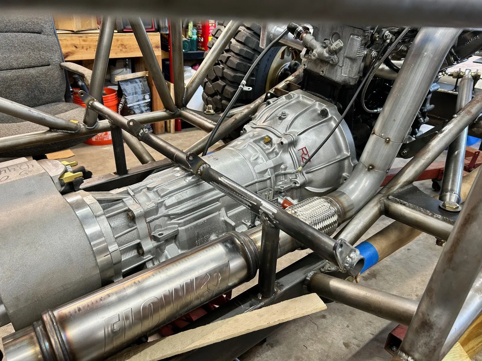

I tacked in a TMR Atlas tail shaft support with some 1.25" .250 square tube but am unsure if I like it or if its necessary.
Battery will be mounted in the tray between the seats and in front of the coolers. I may add some expanded metal on the sections each side of the battery for some additional storage areas.
Extended the downpipe from the turbo to lower the plex joint and muffler to where it should make the pass side floor a bit easier to fabricate. Muffler is a Flowmaster FX. Hopefully its not too ricey

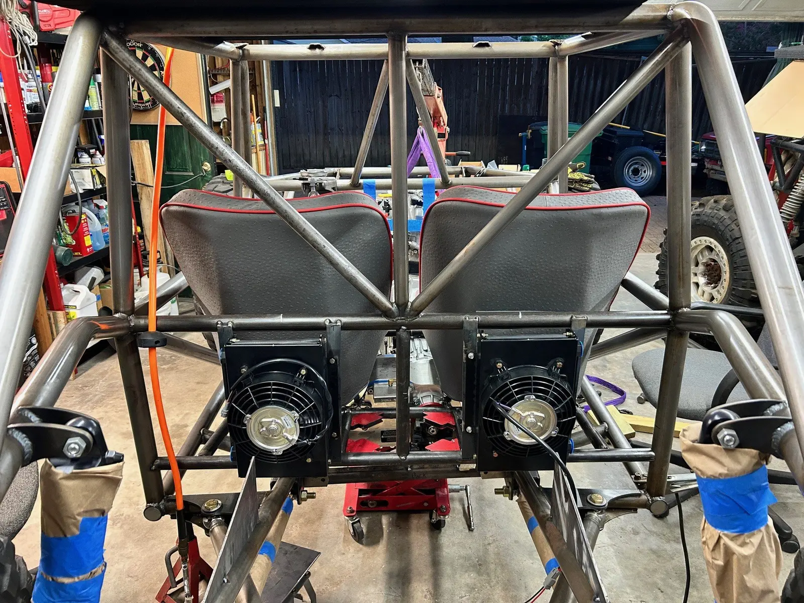

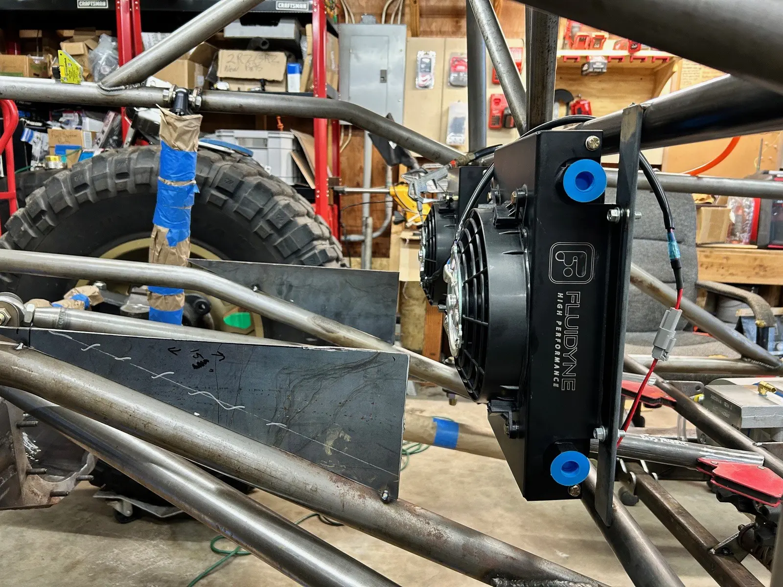

Snagged these Fluidyne E-Line coolers from summit when they were on sale. One will be for the transmission and the other for the steering.

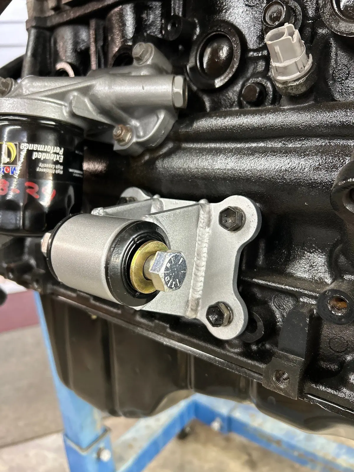

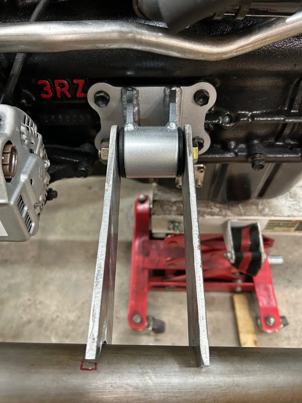

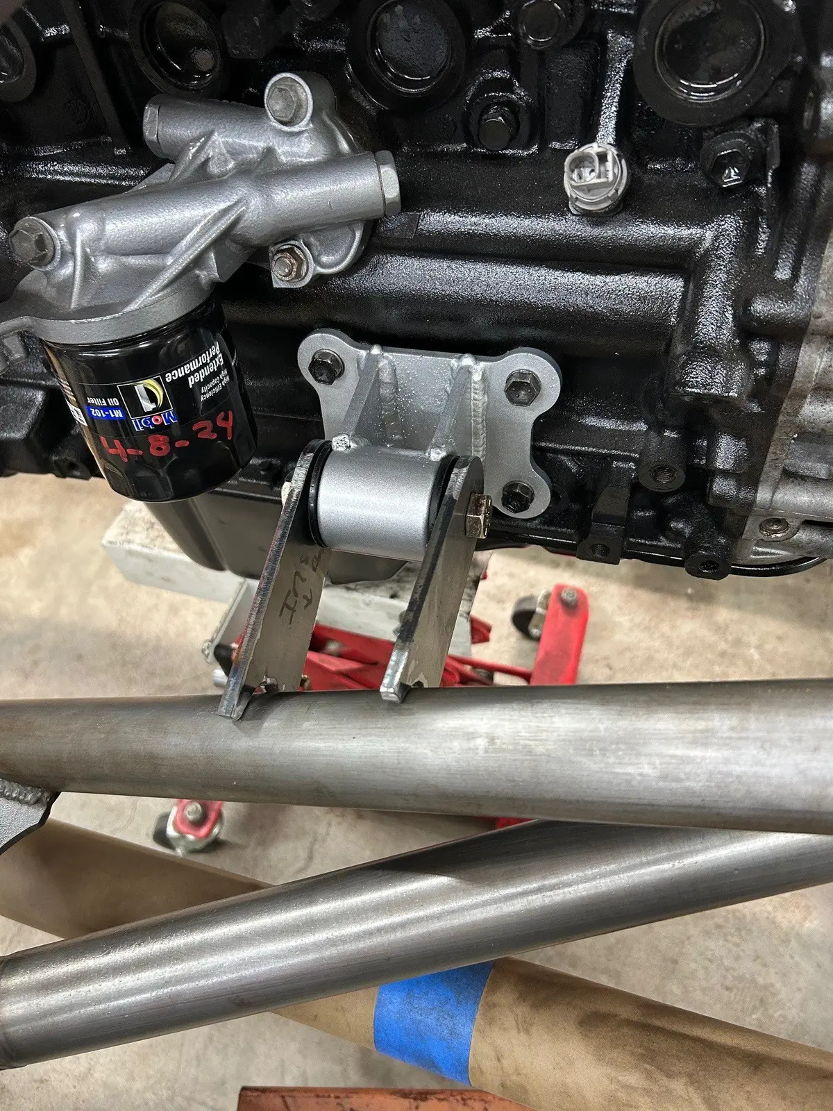

To Do:
  1. Finish welding out motor mounts. Reinstall Wastegate and turbo oil drain.
  2. Reinstall Wastegate and turbo oil drain

  8. Weld out exhaust, fab exhaust tabs and tack in place- done

Cooler is in place.
Exhaust is fully welded. Single tab in the rear on the seat mount. Flex joint is up front. I may need to massage a small area on the downpipe between the frame and the bellhousing.

Brakes are all the Branik hats, rotors, brackets and will be 6 piston all the way around.
There is a jack stand under there as well.. working on this alone I have to make sure I work somewhat safe.
MC and Resi mock up. Not sure I like this yet. The billet slider from BMR is pimp though.. The Wilwood 10:1 pedal is in a good spot. I just need to clean up the top bracketry a little better.
Atlas shifters are in the background. I may need to bend them over to the Driver side a smidge.

I got to work on a few more things..
The trays behind the seats now are solid and the accessories that will be mounted there are being laid out. Battery box will be in the middle, passenger side is still undecided and driver side will have the fuel pump/filter and rear steer controller from Radial Dynamics.
Mounted up the headrests over each of the seats. Had the covers made at 486 Motorsports out of Michigan to match the PRP colors..
Moved the orbital over a few inches inward since the steering wheel wasn't centered on the driver seat.
Worked on the MC mount and added some additional plate to completely fill the upper tubing support.. Should be pretty close to where it will permanently reside. Still undecided on it currently..
I began working on the doghouse which will have the Haltech IC7, Main Power disconnect, Switch Pros RCR 12 and RADesigns VX shifter. Initial impressions are that everything should be easily in reach.
I build the structure out of 1.25". It SHOULD be able to house the Haltech 750, Haltech WB1 module, Switch Pros module and power distribution buss bar. I need to lay that out once I have everything plated. I hope to be able to keep this area as weather resistant as possible. Ordered the VX shifter today so I have an idea of the layout for the compartment cover. I'm going to use 10 ga. plate for the cover to add a bit of rigidity.
Threw the pass seat in to mount the head rest and to test the current Atlas shifter location. Looking at it now, I may not need to bend them.
Getting some help from by buddy @SMKYTXN with a carbon fiber intake to the throttle body and a low pro oil pan for the 3rz. Muchas gracias Amigo..

Added a bump bar to the front. I tried to keep the tubes tied into the nodes as best as I could. The welds aren't as nice as Adam's but they should work. the bump bar is about 2/3 welded in currently. The winch can still be dropped in through the top. Not the best notches, but not to bad for my first try and I didn't have to start over. The Pipemaster helped out a ton!! Should help protect the winch and front lights when I get them tucked in there. I got the idea from the Wende Chassis owners page on FB. Suck down winch point also welded in place. Pretty nifty mount from Hulse Engineering and quick release pin from McMaster Carr. Keeping everything wiped down with the Fluid film has kept the rust at bay on the chassis.
