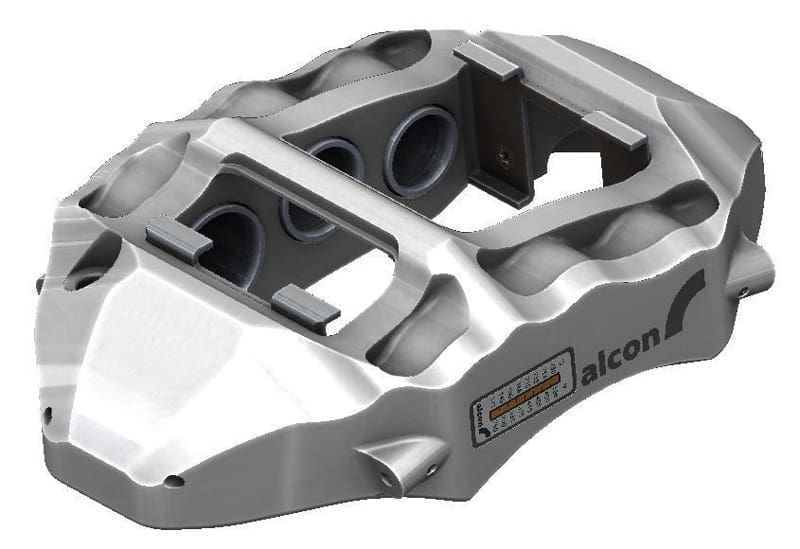

Alcon is delighted to announce the latest addition to its off-road racing range, the CAR8949AM20 caliper. Specifically designed for off-road racing, this new 6 piston monoblock caliper delivers best in class braking performance coupled with further weight savings over previous iterations of calipers. (more…)

Lightweight Trick Truck caliper | Part number CAR1249ZG06-Machined from aerospace-grade aluminum billet for maximum strength and durability.-Monobloc 6-piston radial mount caliper, large braking force, staggered pistons to allow even pad wear.-Cross-drilled stainless steel pistons with wear-resistant coating for reduced thermal transfer.-Internally ported – no external fluid transfer pipe-Bleed screws are recessed and fitted with caps for protection and to keep them clean.-Fluid inlet positioned in the underside of the housing for protection.-Central bridge with facility for cooling duct to direct air across the caliper to cool the outer half.-Runs 0.7” thick pad on a 14” discClass 1 Buggy caliper | Part number CAR8949W52-Differential piston diameters that minimize pad taper wear.
-Stainless steel pistons with wear-resistant coating.
-High Temperature seals.
-3kg anti-knock back springs.
-Hard stainless steel wear plates.
-Removable central bridge for ease of pad change.
-Internally ported, no external fluid transfer pipe.
-Pads 0.64” thick
-Disc 12.75”Heavy duty Trick Truck caliper | Part number CAR8959W10-Machined from aerospace-grade aluminum billet for maximum strength & Durability
-Fixed pad retainer bars to increase stiffness,
-Fitted with wiper seals to prevent dirt ingress
-Stainless steel pistons available as an option to reduce heat transfer to brake fluid. stainless steel pistons with wear- resistant coating for reduced thermal transfer.
-Pads 1.12” thick
-Disc 14” DiameterAbout Alcon
