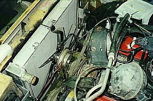

 Cooling the Dragon
 Of all the stuff we hear about how to cool a V8, let me tell you that this combo really works. My radiator is a Howe unit from Summit racing, and I have a 6 blade clutch fan from my good friend Brian. (Thanks BC!) Around town, it's hard to get the temp above 190 or so. On a recent trail ride in Vernal Utah, it ran warmer, about 210-215. It was about 95 degrees outside that day. A shroud is your best friend! So is your best friend that helps you build the shroud (thanks Paul!!).
 To keep the transmission cool, I use two coolers. The first, mounted in the engine compartment, is about 8" by 10" or so, and has a ten inch fan mounted on it. Soon, I will remount this cooler elsewhere to improve airflow. The second is a smaller cooler mounted in front of the radiator. The two seem to be adequate. I have a temp gauge on the transmission to monitor the temp.
