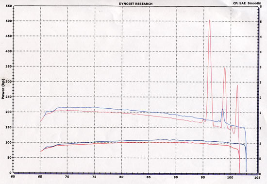

Of course,
the important tests are comparing the AEM Brute Force Intake system
to the factory system.

The results
of the dyno testing were consistent and reasonably remarkable
from pass to pass. The Jeep 4.0L is not a powerhouse and this
one connected on the dyno with the stock intake tube, factory
replacement filter and a slightly modified throttle body (not
throttle body spacer) was pulling a whopping 102 horsepower and
206 lb.-ft. of torque to the rear wheels. However, when tested
with the AEM Brute Force Intake installed our tests were also
very consistent and showed an improvement in horsepower from 102
to 111 and an increase in torque from 206 to 216 lb.-ft..
The blue line is the AEM Brute Force, the red line is
the stock intake and filter.
Note that the spike toward the end of the graph is an
anomaly created by the specific configuration of this
vehicle (it was consistent from test to test). We left
them on the graph to show actual return from the shop.
According to PFI, anomalies like these are pretty standard
and shouldn't taint the data in any manner.
The dyno results
from PFI Performance show a consistent 4.5-5% increase across
the entire power band. I would say that isn't bad for a couple hundred bucks and an 30 minute
driveway installation.

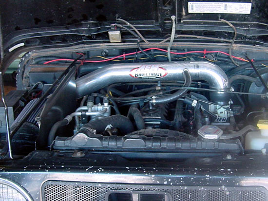

In addition
to the increased performance over the course of four months, I have
increased fuel mileage from 13.2 to 14.1 miles per gallon. I don't
know that I can attribute all of that to the AEM Brute Force system,
however I have not made any other changes that should effect the
mileage to the vehicle. The only downside (if you can call it
that) is that the air intake sound is pretty loud but not enough
for me to care about, although it can catch people standing next
to the vehicle by surprise as they generally think something is
leaking vacuum under the hood. And if the truth be told, the polished
tube looks great under the hood.
