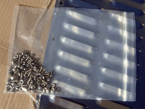

to be a bit of a pain when install time came), a bag of stainless
hardware (bolts, washers and locking nuts), a template for cutting

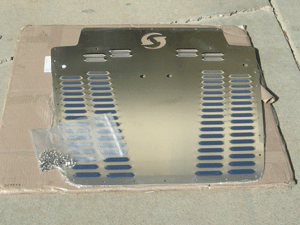

Packaging, "insert" & bag of bolts |

Cyclone logo |
Bag of Stainless hardware |
The
aluminum piece is well-made, has no sharp edges, and the Aluminum
Customs Cyclone logo built right into it. It certainly looks
custom-made. Once I took it out of the package I laid it upside
down on the carpet, put the cardboard shipping package on top
of it with some weight and took the slight warp out of the aluminum.
Enough so that I didn't ask them to send me another one (which
they said they would do if I was unhappy). Realistically, this
is the largest issue I had with the product or the install.
