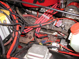

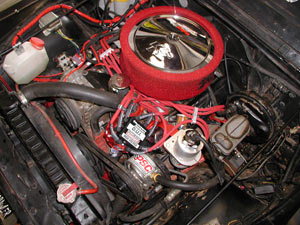

DUIOk, now on to the LiveWires.  Since the distributor cap is much larger than stock, please be patient when installing the plug wires, as it may be a bit of a challenge clearing everything in the way.  I had to slightly relocate my fuel supply line and fuel filter, but that’s all.  Don’t forget to put the supplied dielectric grease on the terminals at each end of the plug wire.  It helps to water-proof the terminals and allows much easier removal in the future.
In my humble opinion, it’s easiest to start with the #1 wire and go around the cap in firing order direction.  In this case, that’s clockwise (not all applications are, depending on distributor location, either front/rear or left/right!)  Connect each wire to the distributor cap, laying it across the engine and pointing towards the cylinder it goes to.  Since each LiveWire is marked with the corresponding cylinder number, it’s very easy to finish the job by connecting the spark plug terminal end.  Once this is done, complete the install by installing the Billet Aluminum Wire Looms.  Check out the photos. Not only are they functional, they look absolutely awesome too!

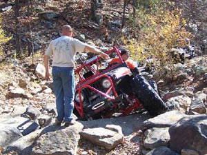

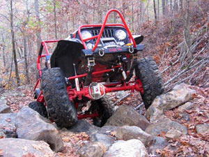

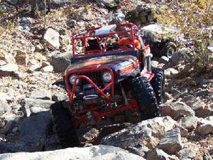

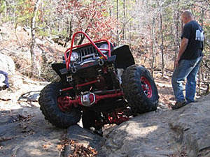

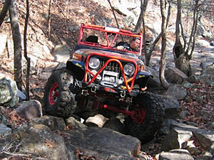

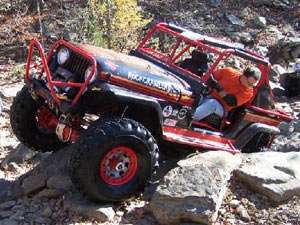

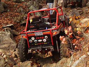

My new favorite trail has got to be Black Sheep Boulevard at Green Acres.  This ‘X’ rated trail is not extremely hard for big-tired rigs, but it is challenging.  The entrance is somewhat intimidating, but actually fairly easy when it’s dry.  Only three rigs attempted the trail, and we all completed it with no breakage or winching, but it was a great workout for my taller and a little narrower rig, really putting every aspect of it to the test.
DUI
DUI
DUI
DUI
The Davis Unified Ignition system performed flawlessly, whether the Jeep was nearly on its side or pointing to the sky.  I’m certainly happy with this upgrade, and have no reason to expect it won’t continue to work flawlessly for years to come.  It has definitely simplified that part of my rig, and if I’ve learned nothing over the years, I’ve learned simple is good!
