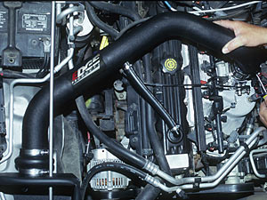

The Trail Jammer’s intake tube installs easily using hose clamps at each end.
Edge Trail Jammer

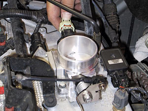

The throttle body simply bolts and you reconnect the harnesses.
Edge Trail Jammer

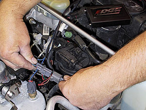

The Edge module connects in-line to the stock harness. Easy!
With the new filter clamped in place, the air tube was attached to the filter baffle and throttle body. Now the valve cover breather hose was connected with its hose clamp.
Finally, the Edge Trail Jammer Electronic Module was positioned in the driver’s fender well with Velcro, and the interconnecting plugs were attached to the corresponding factory harness.

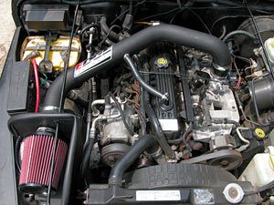

Finished! Open a cold one.
Edge Trail Jammer

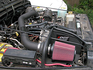

Completed install in a third TJ - this one a '97 Sahara
Edge Trail Jammer
Edge Trail Jammer
