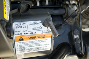

So did you catch that part about the clutch engaging itself? Yeah, that's right. Just hit the IN button and "flick" - the semi-automatic clutch lever engages. How cool is that?

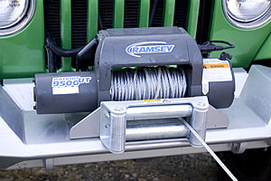

The Ramsey 9500UT (Ultimate Technology) electric winch is the latest in the tried-and-true Patriot line. Based on the very successful Patriot 9500, the 9500UT has an updated look, including the new solenoid and gear housings, and better seals throughout to better protect the winch from the elements.

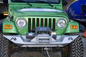

The Ramsey 9500UT mounted on a FabFours bumper.
Ramsey 9500UT Electric Winch
This bumper allows for very low mounting for extra air flow.

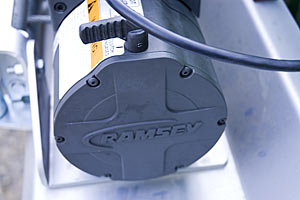

A new side plate shows the new Ramsey styling.

The semi-automatic clutch rocks and is very easy to use.

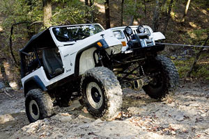

Putting the 9500UT to the test in Hot Springs.

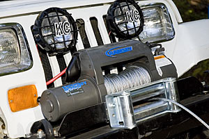

This winch is mounted to the YJ with an additional winch mount.
