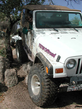

The next place we stopped was a location that is 850 acres of granite called Katemcy Rocks (or more formally, Kruse Off-Road Park). Katemcy Rocks is a great place to pretend you're on the Professional Rockcrawling Tour or just have a great time with your friends.
Getting the hang of the new suspension was easy. |

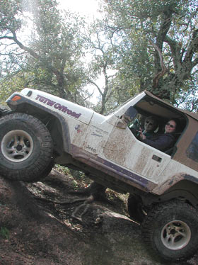

You can see here that it's reasonably flexible, even in off-camber and downhill situations. Nothing to worry about and plenty of clearance for those 35" tires. The owner however did experience "tire pick" (when a front tire picks up off the ground while making a sharp turn) on a number of occasions. |
Even though it's stiff riding, it provides enough flex when needed. |

Again, our biggest concern was tire pick, which does seem to be somewhat amplified when using this kit. Off-road there are times when you must make a sharp turn while pointing uphill, and it is at these times when the wheel-pick can get a little scary. The feeling is controlled and stable but certainly does provide a moment of concern - at least until you get used to it.
