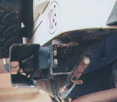

How To Mount Tow Hooks on
your TJ
Not much to say, other than the rusty bolt is
the one that came with the tow hook and fit in an existing hole in the
frame. The other I drilled. The angle works great as they never hit.
Departure angle is not an issue at all. Been used a ton of times and
have worked out great.
