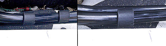

Notice how
the bow ends moved almost 1/4" within the mounting tab. That
adds up to a lot when you have all four ends like that!

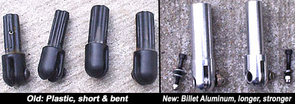

The difference is obvious between the old and new ends.
The first thing
you'll notice when you get the Turbo City bow ends is that they do not
come with any instructions. None. Nada. Zilch. Print out this page so
you have a reference when you go outside to do your project. When you're
done, write us a letter on the back
and say hi. Or, don't. You can recycle it or line your catbox with it.

The new bow
ends did not cure our movement problem 100%. In the photos, above,
you can see that there is still some movement if we pull on the
bow end a little bit. However, that is, like we said, with us
pulling on it. There was a little bit of play in two of
the new ends up at the bracket. By the time that slight degree
of movement gets to the corner of the bow, it is exagerated a
bit. There is also some play where the brackets, themselves, mount
ot the sport bars, which, of course, is out of Turbo City's hands.
