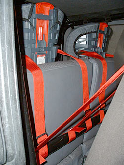

In my particular case, I couldn’t fold and tumble the seat forward and leg room for the rear passengers was limited to 7 year old-sized legs, due to the custom roll cage harness bar behind the front row for mounting harnesses, so I “tweaked” the installation a “little.”
I decided that since it was difficult for my kids to access the second row from the front with that harness bar in the way, that I would flip the seats around so they faced rearward. It was a lot more work than the regular install but my kids love it. They think it’s so cool to look backwards down the road while driving and they now have much easier access to the rear seats. They can get to them via the rear door when the soft top is up or they just climb up the sides when the soft top is down. Plus, it may even be safer for them in the event of a front-end collision since their heads and backs would be supported by the seats.
TwinSeats for Jeep TJ
As an additional safety measure, I took advantage of the harness bar behind the front row and now behind the rear row, as well, and used it to mount the same 4-point harnesses I have for the front seats. Now my kids or anyone riding in the rear would have the same protection and harnessing that the front seaters have. The cherry on top was the cool booster seats I picked up that had provisions for dual shoulder harnesses and the height of the harnesses and head support was adjustable.
