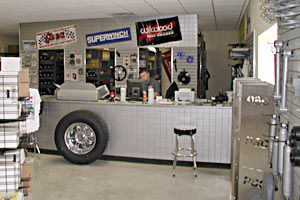

PSC
PSC Motorsports parts counter and showroom

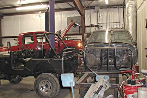

Vehicles in progress in the shop

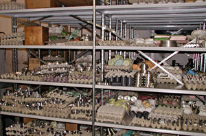

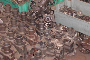

Steering gear and pump cores are received in bulk from several reputable suppliers.  After initial inspection, each one is disassembled, thoroughly cleaned, and then inspected again to insure quality of the housings.  Any question or concern and it’s scrap!
PSC

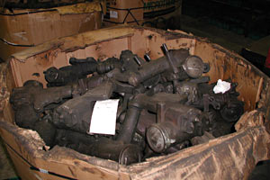

Box of cores, waiting to be cleaned
PSC
Cores in process
PSC

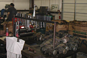

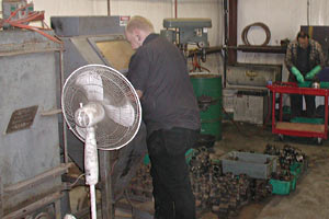

A worker cleans each core
PSC
Cores ready to be turned into PSC boxes

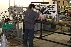

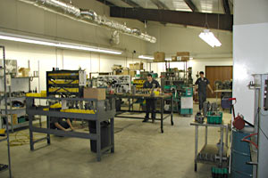

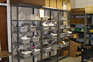

Once clean, the parts are sorted and stored, waiting for an order.  Tom says he utilizes the “just in time” manufacturing process for most parts, mainly because of the variety of applications, but also in order to reduce inventory of unnecessary parts.  When the order comes in, the machining and modification process gets put into motion.
PSC
PSC machining and assembly area
PSC
A gear box being built

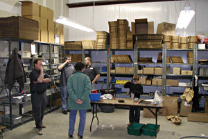

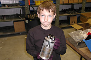

Once all of the individual parts have been assembled, the guys in shipping take over, putting everything into kits for boxing up and shipping out.  While reviewing this part of the process, Tom’s young son, Josh, assembled a cutaway reservoir for us. Like father, like son!
PSC
Parts in bins waiting to be shipped
PSC
The gang hanging out in the shipping area
PSC

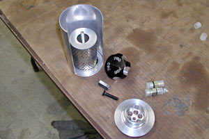

A cutaway reservoir for us to have a look at
PSC
Josh holds a cutaway reservoir
