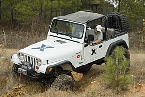

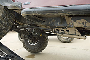

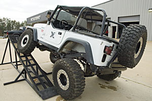

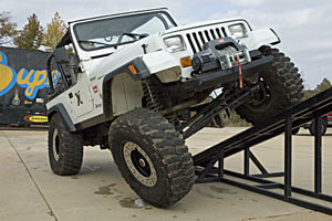

Indeed it was not. As I circled the ramped YJ, I peered underneath to see what was afoot. Providing about 9 inches of rear travel were good ol' leaf springs with three military wraps around the bushings. In addition, an anti-wrap bar ran from the rear axle to the custom belly pan. Up front, things looked a little more familiar. Since Superlift owns Black Diamond, the front end is based on the XCL kit - thus the X2 name (as in Generation 2).
Superlift Suspensions
One glance and you know this isn't the same old YJ kit!
The rear flex from these leaf springs was amazing.
The front end is a coil-over shock setup with long control arms - far from the standard leaf spring setup. The Black Diamond logos on some components do hint that this will be part of that lineup.

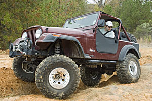

One after the other, I was handed the keys to both the YJ and the CJ and took them out back for a whoopin'. Running along the backside of the building is a rather deep drainage ditch. I was able to play for a while going across it and through it at various angles in order to feel the suspension work.

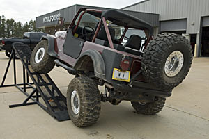

The CJ was just as impressive on the ramp.

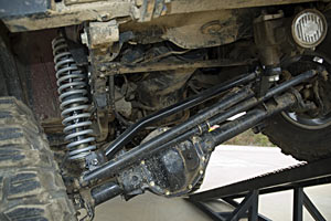

A good look at the front suspension arms.

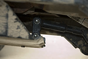

A shackled anti-wrap bar is attached to the rear axle.
It was immediately evident that the setup, though still in the design phase, was on the right track. Like a TJ, the Jeeps flexed out and followed the terrain wonderfully. But, since they utilize leaf springs in the rear, the Jeeps didn't have the tendency to flop over on side grades like TJ's sometimes do. The feeling was of complete control at all times. I even took the ditch lengthwise and had the Jeeps way over on the driver side without them ever going over. As I exited the ditch, the Jeeps came back to level ground safely without any surprises.

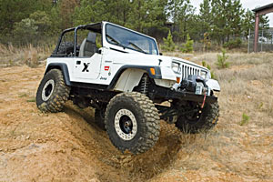

Kevin and I took the YJ out back and had fun playing in the ditches.
The YJ felt stable in control at all times.

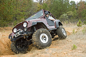

The CJ was just as much fun to play in the dirt with.
The suspension was compliant and felt right at home.
