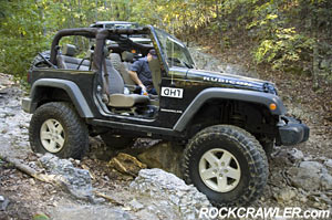

We spent the whole afternoon on our first day in the JK and the better part of the second day, as well. Pete Trasborg from JP Magazine and I swapped out time in the driver seat while the other took photos. I knew on the second day that Pete was an ok guy when I saw him yanking the top and doors out of the Jeep first thing in the morning (it was in the low 40's).
A JK on 37" tires looks massive. Already larger than any previous Wrangler, the JK's just look awesome lifted. Their extra length and width tend to make them more stable on the trails, as well - especially on side hills.

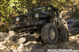

This JK did awesome all weekend. Though the factory auto swaybar disconnect almost felt like cheating, it was great have. Disconnecting it allowed the front end to flex out and be more compliant as we tromped over the rocks and ledges. On the side hills and long, steep ascents, reconnecting it lets you feel that much more comfortable on-the-fly.
The suspension worked very well and the ride was comfortable (really). Our kidneys all stayed in place and we experienced no bleeding. Time, settling and abuse will soften up the springs a bit and that will be a good thing, as well, allowing a little more flex on the rocks.

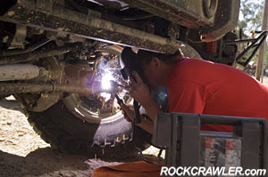

OK, so that's not really the whole story from the trip. No 'wheeling trip would be complete without some problems. We did have some that we may as well report here. Please note that they had absolutely nothing to do with Superlift!
While parked at camp, Trent McGee from Superlift was one of the first to discover that Jeep in their infinite wisdom has not fixed one of the biggest issues four-wheelers have faced with the TJ Rubicons. That's right, the front axle joints still use half circle clips. What's that mean? It means that under real off-road conditions they tend to walk and once they walk far enough, the joints come loose and next thing you know you've got a busted axle shaft. Trent noticed our mule's clips a-walkin' and we had our good friend, Mark Hinkley tack weld them back into place so we could go have more fun on the rocks. Thanks Mark!

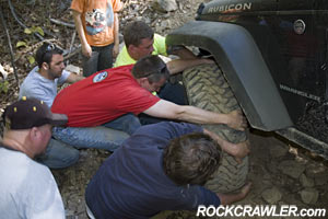

Of course, it wasn't too long before Mark was put to work helping me out again. Alright, now he who hath not aired down too far and peeled a tire off the bead may cast the first stone. Yup, off the tire went with the Jeep aiming downhill. Oh boy, what fun. Thanks to everyone who jumped in to reseat the tire - especially Russ Baer from Baertrax who laid underneath the Jeep and took a nap. Actually, he was helping by putting pressure on the back side of the tire with his feet.
Superlift JK Suspension
The crew reseats the tire after it came off the bead.
