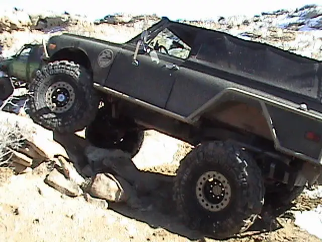

Here is my old 71 k5. Had a 454, th400, 203/205, Dana 60 front, 14ff rear, 43s. Was big, heavy, and not spectacular at any one thing. I had 52" rear springs in the front and shackle flip rear, likely 4-5" lift ish. You will definitely want a 60 or equivalent front and would do a late model LS based engine nowadays for sure.
