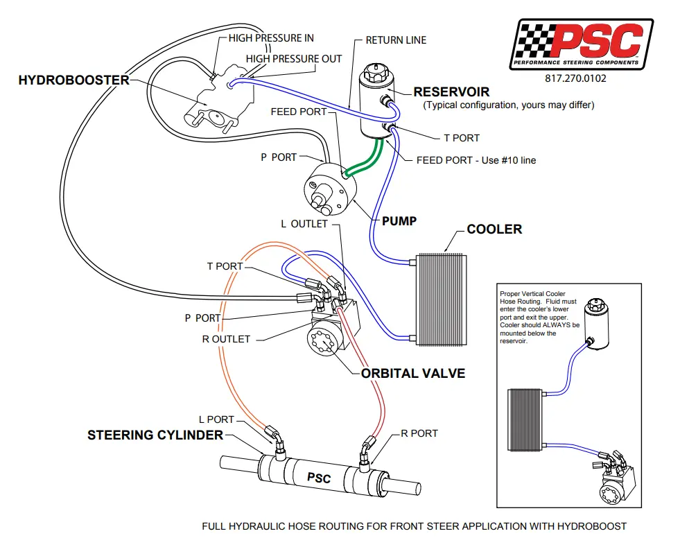

New to this and have no idea how this works. So I have a full Hydro Trail Gear steering kit. I am running toyota axles with disc brakes all around and the larger brakes up front. I was looking into getting a toyota hydro boost brake setup with the 1 inch bore master. Please correct me if i'm wrong but from what I gather I would just plumb pressure hose from PS pump to hydro brake booster then out of booster to the pressure side of the orbital valve then normal plumbing from there? Will this be the best way to plumb and run it. Is there a better or more effective way? Thanks For any help!!
