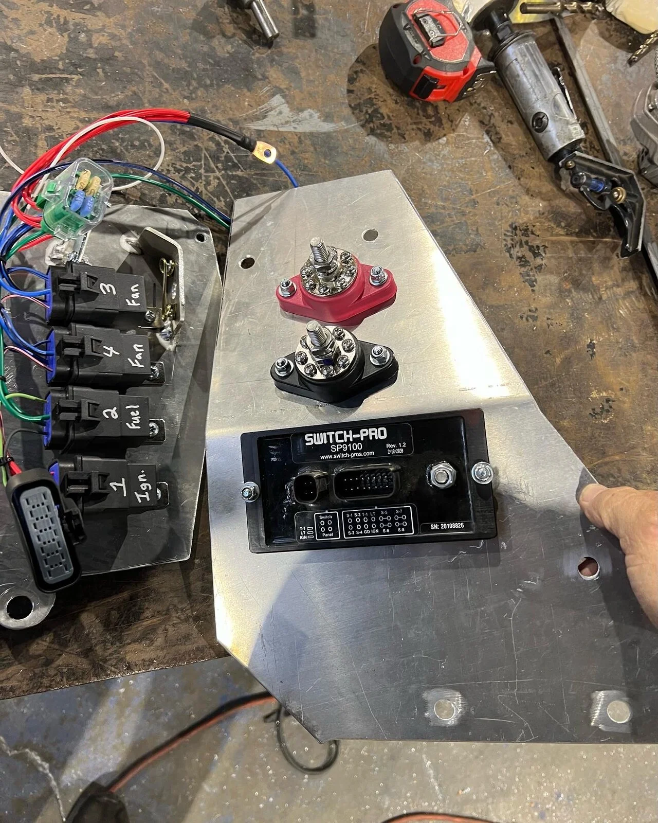

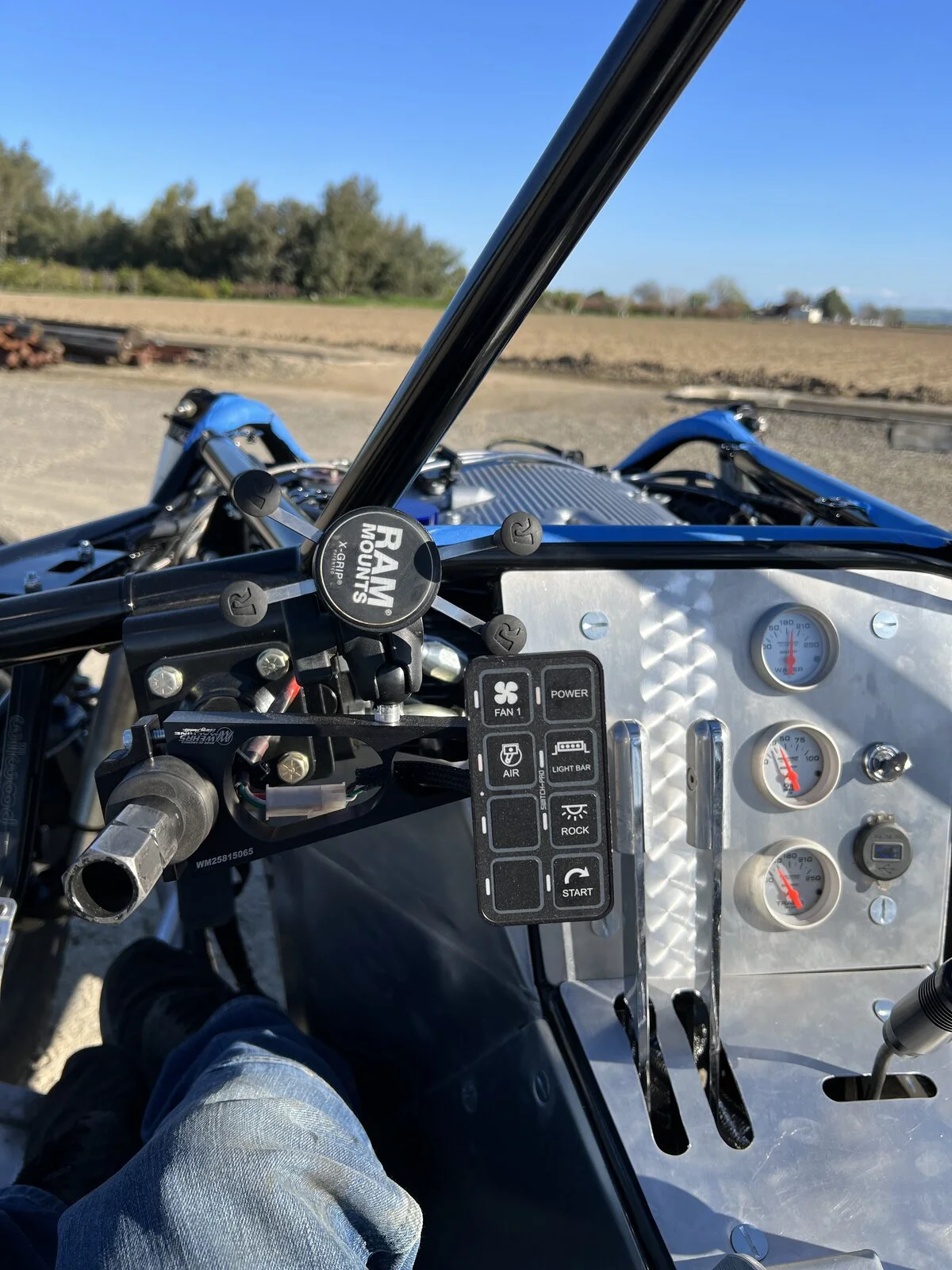

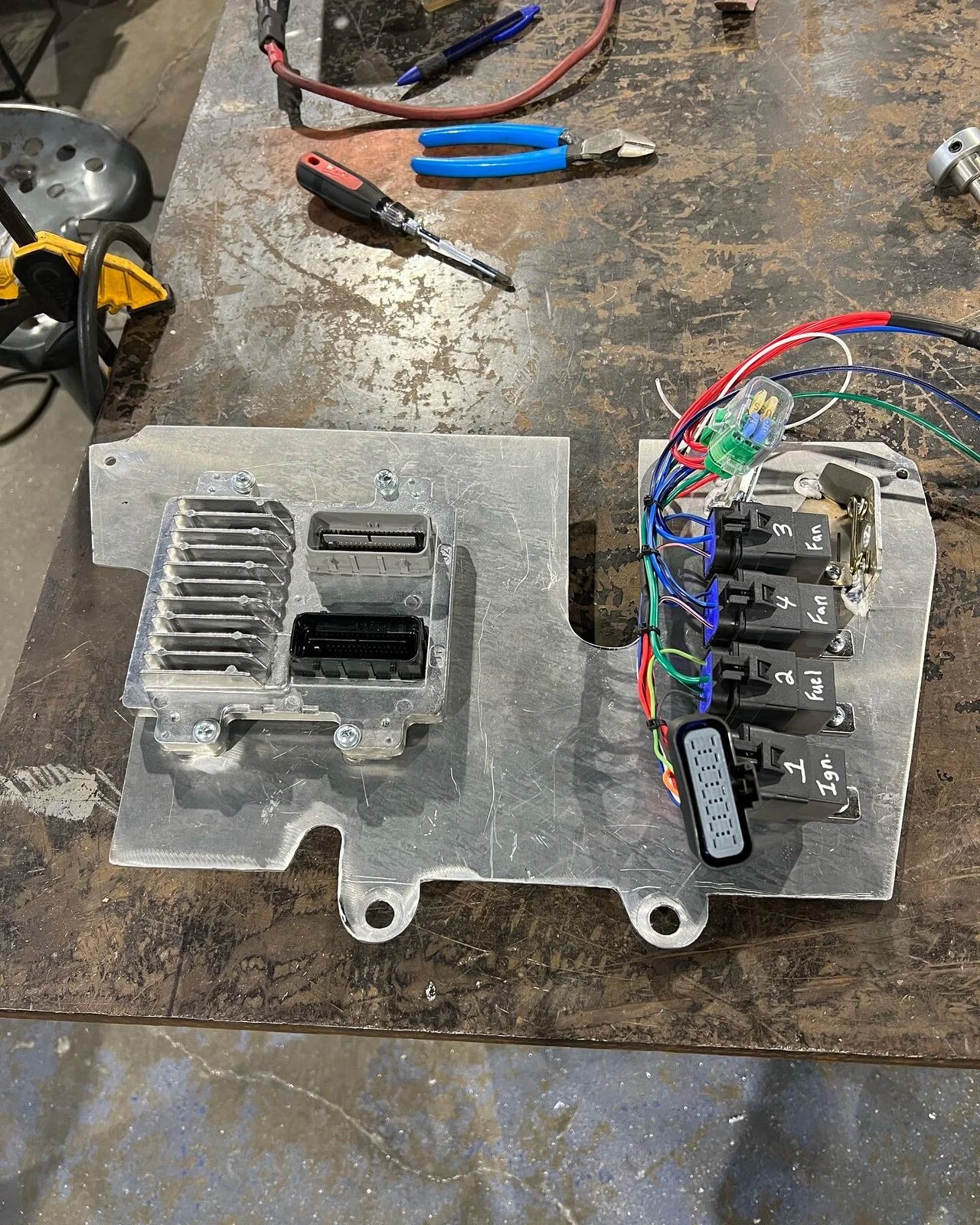

I have the switch pro 8. It is very neat with adjustable amps and self resetting circuit breakers. Very easy to install. I have a key that powers the switch pro. I programmed the power button to turn on the ARB and ignition and computer and fuel pump. Then I hit the start button. Power button kills engine but lights, ARB. I have a fan override switch that can remain on after power button is pushed. Key is only for security and turns everything off. If it malfunctions I am screwed
