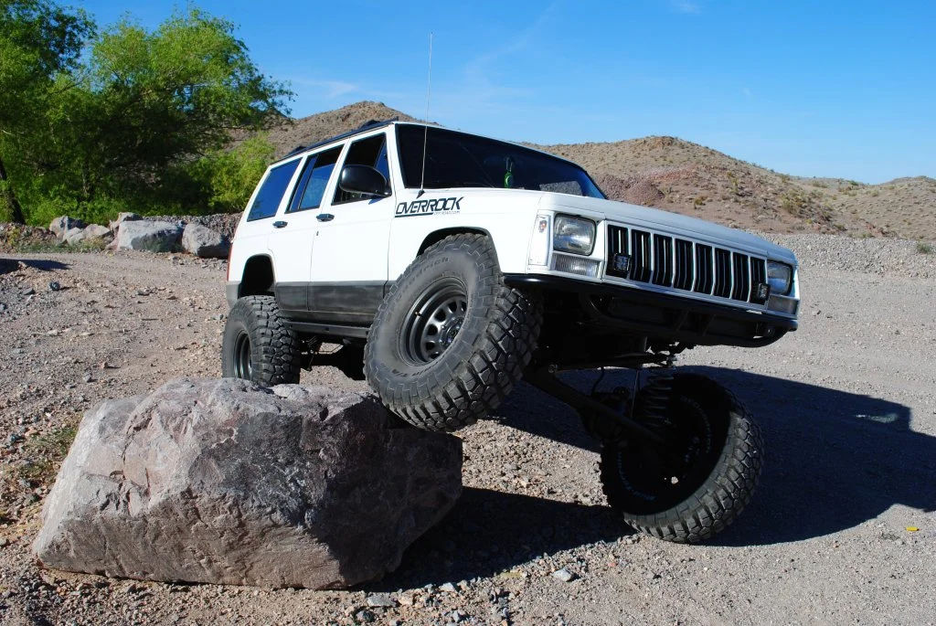

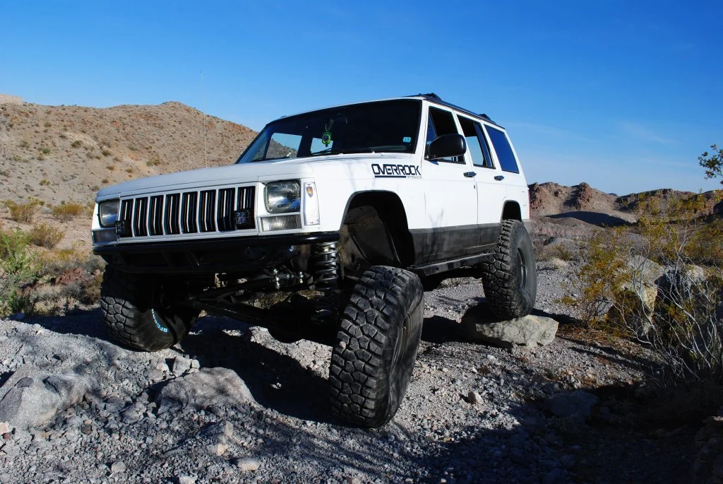

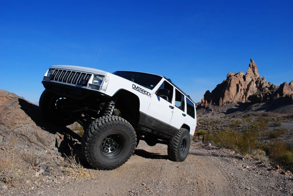

This is my old XJ. I had a 4.5" Rubicon Express lift on it. I used the 4.5" coils and leaf springs and then bought the long arm upgrade. Its on 35/12.50/15 KM2 with 15x9" steel wheels. I trimmed just along the fender line and bump stopped it.
Most use 6.5 or 7.5" lift on their XJs to clear 35" tires but I think it makes them too high. Just my opinion
Also on the gearing I ran 4:56 gears on this XJ and I had a XJ before this that I had 4:88 gears with 35" tires. Both worked great, I had a D44/30 combo in the old one and Ford 8.8/D30 combo in the white one above.
