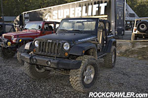

Superlift is offering three kits for the JK. The first is a 2″ spacer kit (part # 5702) that will clear a 33″ tire. This was not yet available for our visit. The other two are essentially the same but differ by an inch. Under the Superlift brand will be a 4″ kit, while their Black Diamond brand will get the same kit but with 3″ springs. We were in Hot Springs to drive the 4″ Superlift kit so that’s what we’ll talk about here and show you photos of.
The 4″ kit will be available under two part numbers. K920 will fit 2 door JK’s while K921 will fit 4 door JK’s. The kits include springs all around, Urethane bump stops to handle compression, shocks, an adjustable front track bar, rear track bar bracket, alignment cams, rear extended swaybar links and assorted hardware bits. Optional parts include swaybar disconnects for X and Sahara models without the automatic swaybar disconnect, steering stabilizer, extended brake lines and adjustable control arms.
The kit we saw was already installed on a 2 door Rubicon model. If you’ve followed the JK into production, you’ve probably seen articles showing the JK’s in Africa. This particular Jeep belongs to Jeep’s Skunkwerks team and was one of those mules abused in Africa. Now it has come home to live with Superlift for a while.
Looking carefully at the parts list, you’ll notice that unlike TJ kits, the JK kits do not include any control arms. Why? Because from the factory, the JK comes with mid-length lower control arms. They are a good bit longer than TJ arms, though not technically “long arms.” Because of this, you can stick a 4″ spring in without greatly effecting caster. The JK does not have alignment cams from the factory, so the kit includes them so you can make minor caster adjustments to dial in the alignment once installed. If you feel like you want a little more flex and more adjustability you can order up the optional Rockrunner control arms. Our tester Jeep did not have the Rockrunner arms. In fact, it didn’t even have the alignment cams, as they were not ready yet.
The JK on-site was sitting on 37″ x 13.50″ x 17″ Toyo Open Country M/T tires. Superlift’s official materials say that you can fit a 35″ x 12.50″ tire underneath with notes saying that you can fit a 37″ with some modifications. This Jeep had been modified. The front bumper had been spaced forward about an inch and the rear edge of the rocker had been trimmed – both in order to clear the tires. The wheels, having deep stock backspacing had Spidertrax wheel spacers (part # WHS-010) to push the wheels out a bit. These modifications were very unobtrusive and we might not even had noticed them if they didn’t bring them to our attention. The bumper spacers may become a production optional part. Chances are, though, that you would not need these with an aftermarket bumper installed.
One other thing of note is the driveshaft angles. While the Jeep was on the lift it was apparent that the JK’s fixed yoke shafts were about at their operational limits. The style of C/V joint used is not made to take the abuse of more severe angles found on lifted Jeeps when used off-road. Why Jeep used them, nobody seems to know. While we didn’t notice any binding or problems during our trail testing, time will tell whether they will hold up long-term. Tom Wood and JE Reel are already working on JK conversion kits to use traditional C/V joints. Understand that this angle issue is inherent to the JK and is a problem that every suspension manufacturer will have – not just Superlift.
