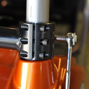

Install is a bit of a pain…but honestly, the LAST thing you want in a safety product is a loose fit.  Step one is to remove the 8 allen bolts and the A-pillar assembly entirely.  I additionally needed to loosen the 3 bolts that hold the drivers side bracket (things fit that snugly).  Those are accessed from the fenderwell and from under the dash and a 1/2″ combination wrench and 1/2″ gear-drive wrench are perfect for this.

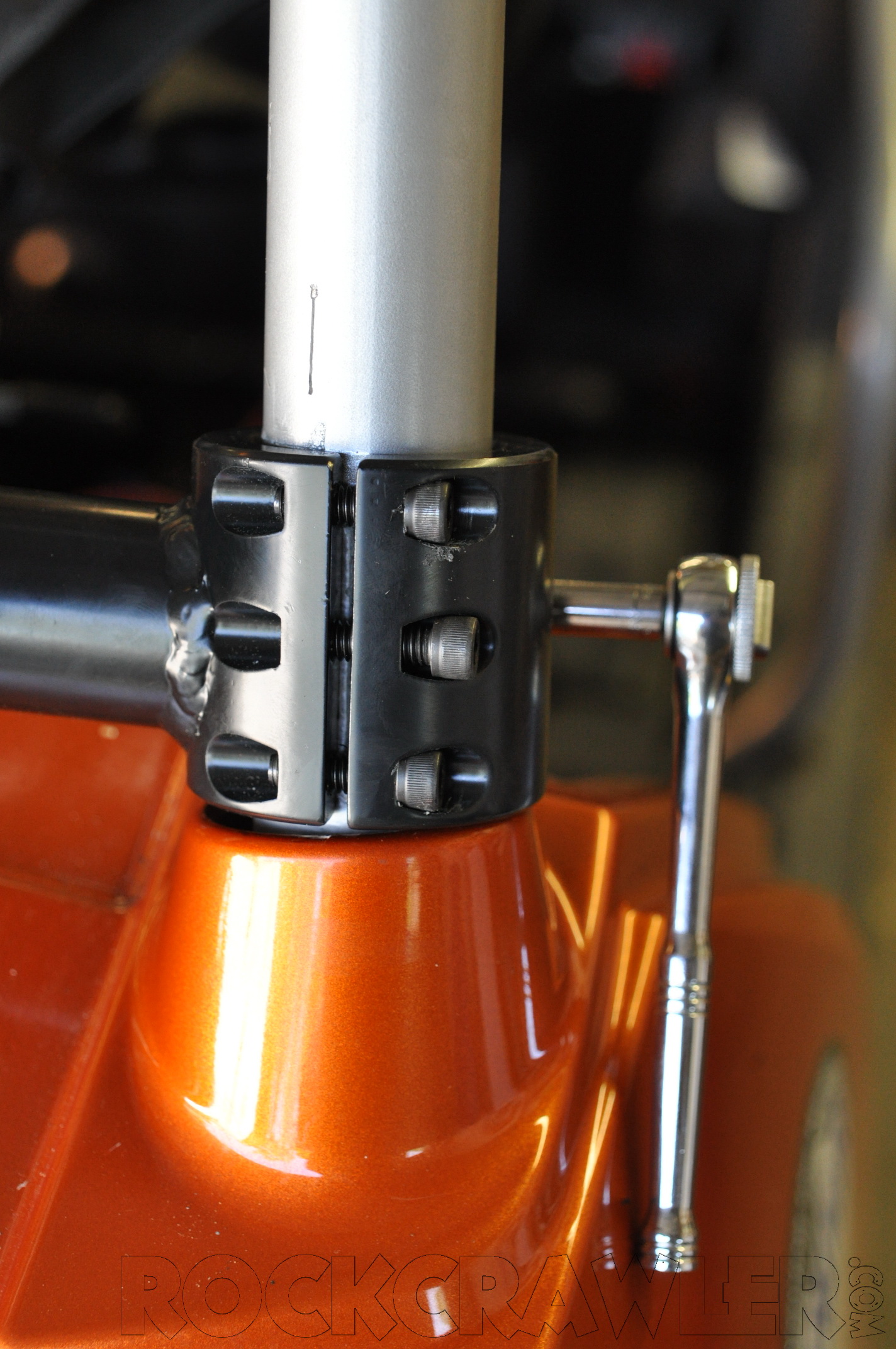

Once everything is disassembled, ensure the Dash Bar clamps will clear the Polaris welds…mine did not, and required a little sanding with a 120 grit disc on my angle grinder.  I found some silver wheel paint and it matched pretty close to the LE cage.
Alignment is simple…but FIRST remember to set the nylock nuts back into the mounting slots for the A-pillar.  These need to be already positioned, since there is little room to squeeze them in once the Dash Bar is in place.  With the Dash Bar over the  mounts, you can then re-install the A-pillar.  I installed all the bolts loosely at first to make sure everything aligned.  As you check the photos, you’ll see where I used a small welders pick to align the top nut on the dash mounts…very little room to work with here.
I tightened bolts in the following order:  1> drivers side bracket, 2> Dash Bar clamp at the top of the V, 3> A-pillar bolts at the dash, 4> A-pillar center bolts, 5> Dash Bar bolts at the dash.  This seemed to be the correct order to ensure no gaps between the new Dash Bar and the OEM Polaris A-Pillar.
