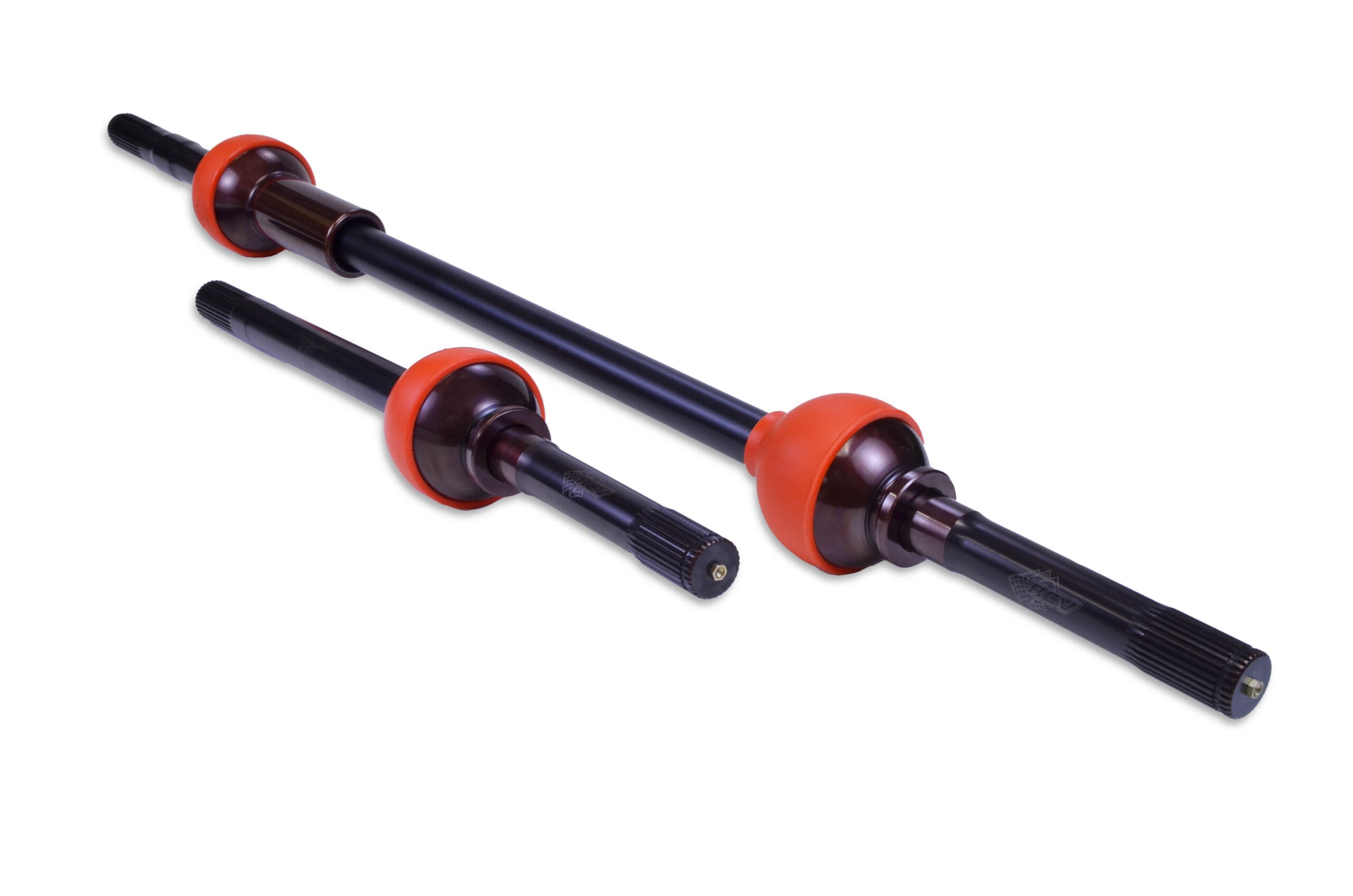

In 2012 RCV Performance Products began offering their Ultimate Ford TTB CV Axle Set for Bronco, F150, and F250 as a solution to racers and off road enthusiasts experiencing breakage problems with their Ford Twin Traction Beam axle shafts. “RCV CV axle shafts were designed to easily replace the u-joint axle shafts of the Ford Twin Traction Beam axle” states Sean Carlini, Director of RCV Product Development. “Our Ultimate CV Axles have been tested to be twice as strong as original equipment shafts, whether at straight or highly articulated angles”.
“RCV Ultimate Ford TTB CV Axles incorporate RCV’s DD Difference: Design and Durability” continues Carlini. “With the RCV high strength CV joint engine torque is spread over six bearings, rather than the two bearing cups of a U-joint. Thereby distributing force over a larger surface area, and making our CV joints intrinsically stronger than u-joints. Also, as the steering wheel is turned the operating angle of an axle shaft joint becomes tighter, which can cause a u-joint to bind and break due to the geometry of the design. The design of the CV joint allows it to always assume a position that makes equal angles with the input and output shafts, which eliminates binding. The RCV CV joint design also provides a greater range of motion than the TTB u-joint design, which is ideal for trucks with lifted suspension. The result is high strength and smooth power delivery without steering wheel shimmy” states Carlini.
“In the case of our Ultimate Ford TTB CV Axles all u-joints are replaced with our ultra-high strength CV joints that are manufactured with aircraft quality high alloy steel for high resistance to bursting and fracture, and the joints are protected by our patented Spherical Sealing Technology. This feature incorporates a cast polyurethane cap to provide resistance to punctures and tears, rather than using a rubber boot that’s susceptible to damage. Our axle shafts are made from aircraft quality high alloy steel as well, and utilize our race proven slip spline design” Carlini concludes.
