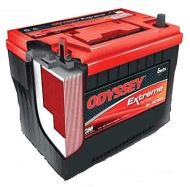

#2 Check the battery cables at the battery. Wires can get corroded and may need to be bent or manipulated to break up corrosion.

Jeep Cranks Slow
A slow crank means you are not getting enough amps through the starter, through the cables, or the starter is failing.
#1 Same as above, check the battery cables at the battery. Wires can get corroded and may need to be bent or manipulated to break up corrosion.
#2 Check for burns – the shielding on the cable can get burnt.
