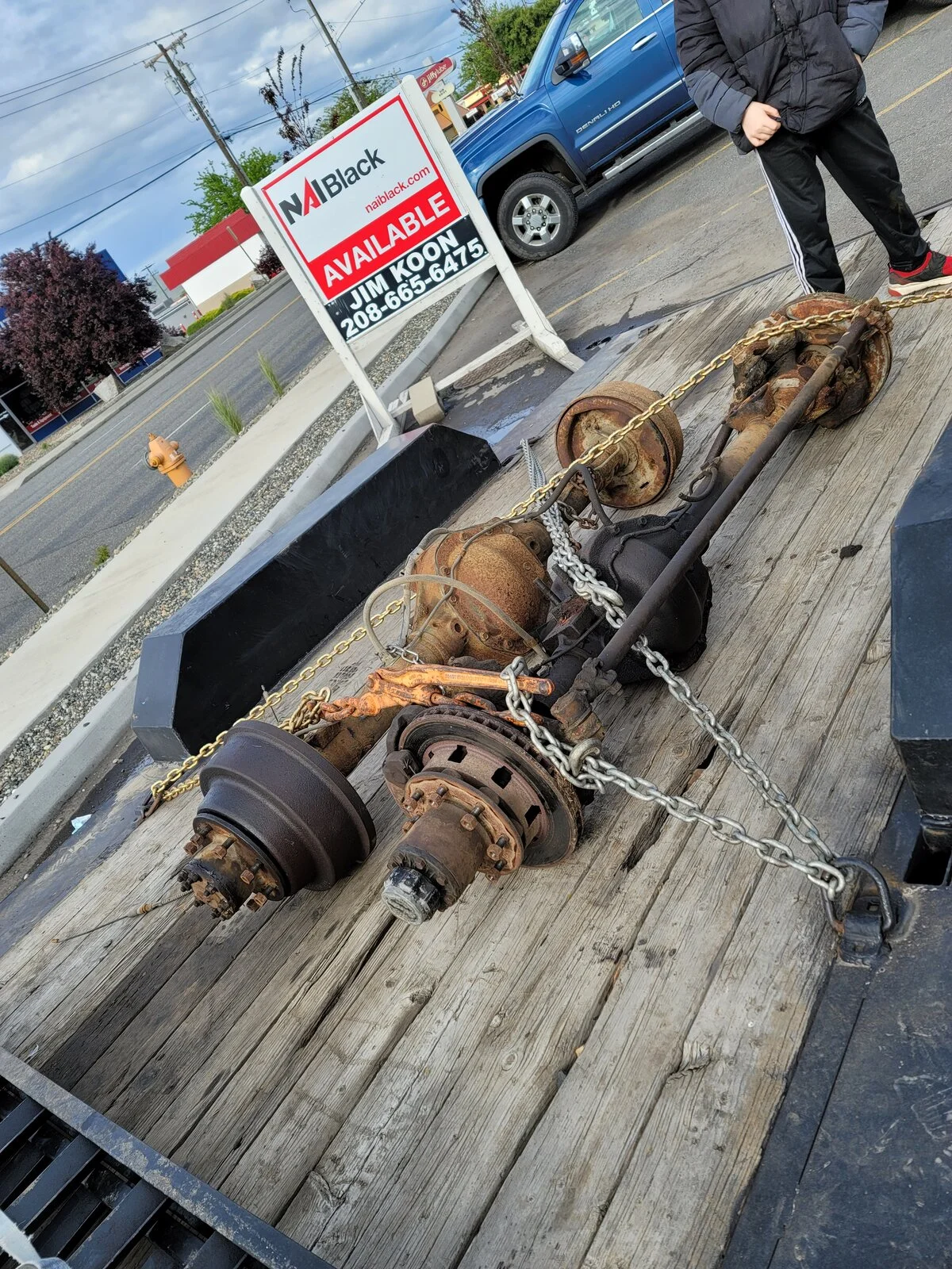

Was able to pickup a matching pair of axles from an 89 cummins. Dana 60 front, dana 70 rear. $800. Goal is to 4link the front (which I've never done) and leaf the rear with the 63s that came off the gmc. To keep my budget happy for now. I was also going to follow my friend's advice on welding the rear and locking the front. However, I was just reading a different thread that said selectable or nothing for the rear. Open to learning here, keep in mind I want this bearly road worthy for the hour drives to local wheeling. Also on the hunt for 35 outers. Debating drive slugs or hubs... want to go selectable in front. Oh, I have a line on a used eaton E locker for the 60 at $800. I think it's steep, thoughts? I was going to shoot for arb.

A bit late to the party but definitely want a selectably or open for the rear for best control. It would be better to spool the front and use locking hub for street use.
Man, it's been a while since I posted anything.... I had a heart attack that really light a fire under my butt. Let's see, 345 is out 6.0l is in. tcase mounted, dana 44s out and sold, dana 60 and 70 turned out to be a 61 and 71. Sold those, baught a dana 60 and 14 bolt. Then found a smoking deal on detroit for the 14 bolt. ($150) and a yukon grizzly for the front ($400). Installed those with the 4.10s currently. (Want 513s later).... I've been working on leaf spring hangers front and rear. Eventually going 4 link front, but the budget is keeping that to a phase 2. Chevy 52s up front 63s out back. I did get some half worn out 38.5 tsl sx and H1 wheels. Last Friday I was cutting the body to get the atlas up as high as I can for a flat belly. I am less than a half inch from flat belly.
