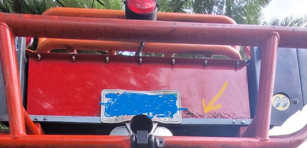

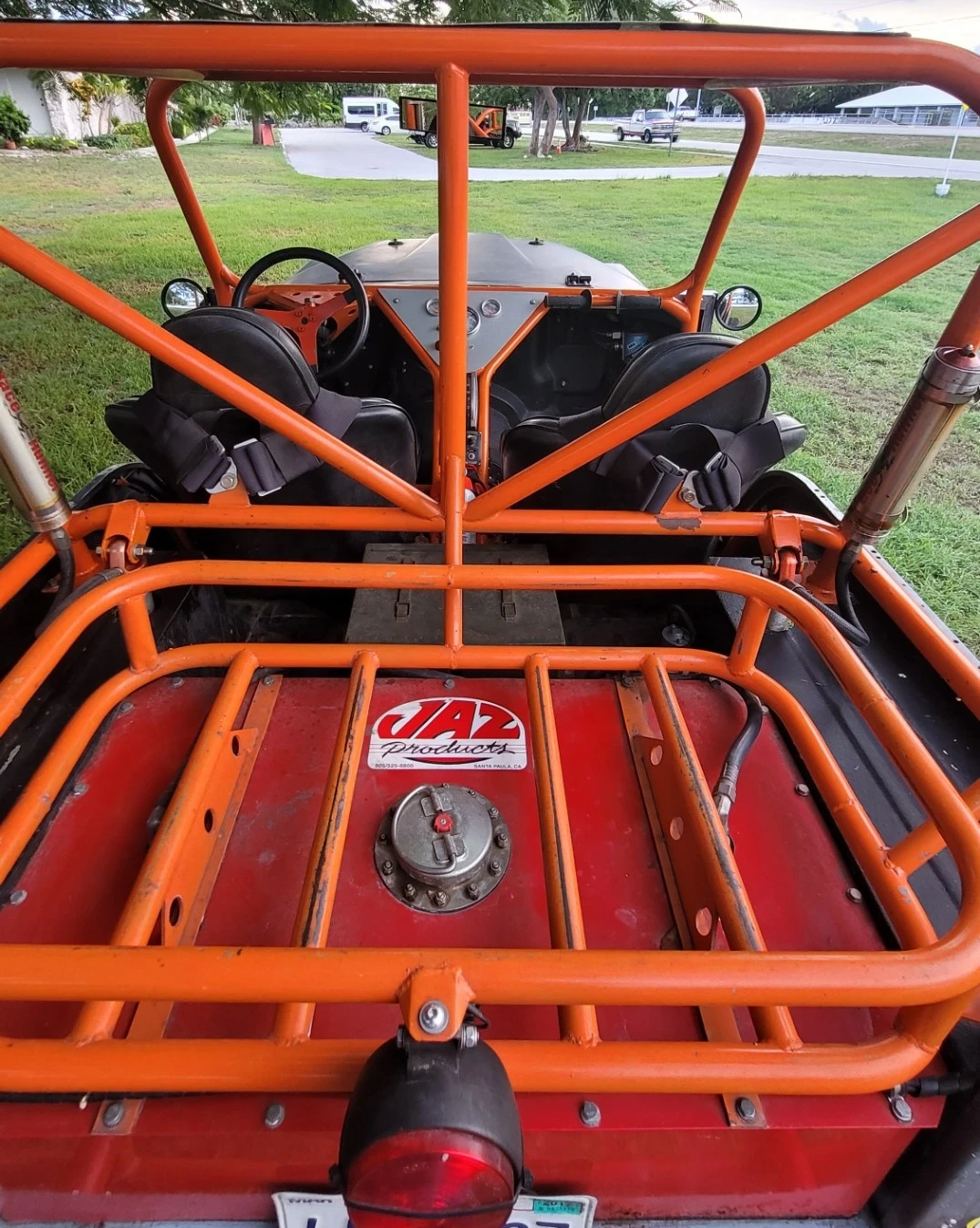

I bought my rig and it has this 22 gallon JAZ fuel cell. The outer steel container that encases the internal bladder is rusted. It is about 20 years old. Do you think the internal bladder is still good? Do I buy new or have a new container built for it or just get a whole new fuel cell?
I was also wondering if this setup is better or should I just have an aluminum tank made to fit? Not sure benefits of an aluminum tank vs the current fuel cell setup that is in there/ What do you all use in your buggy builds?
