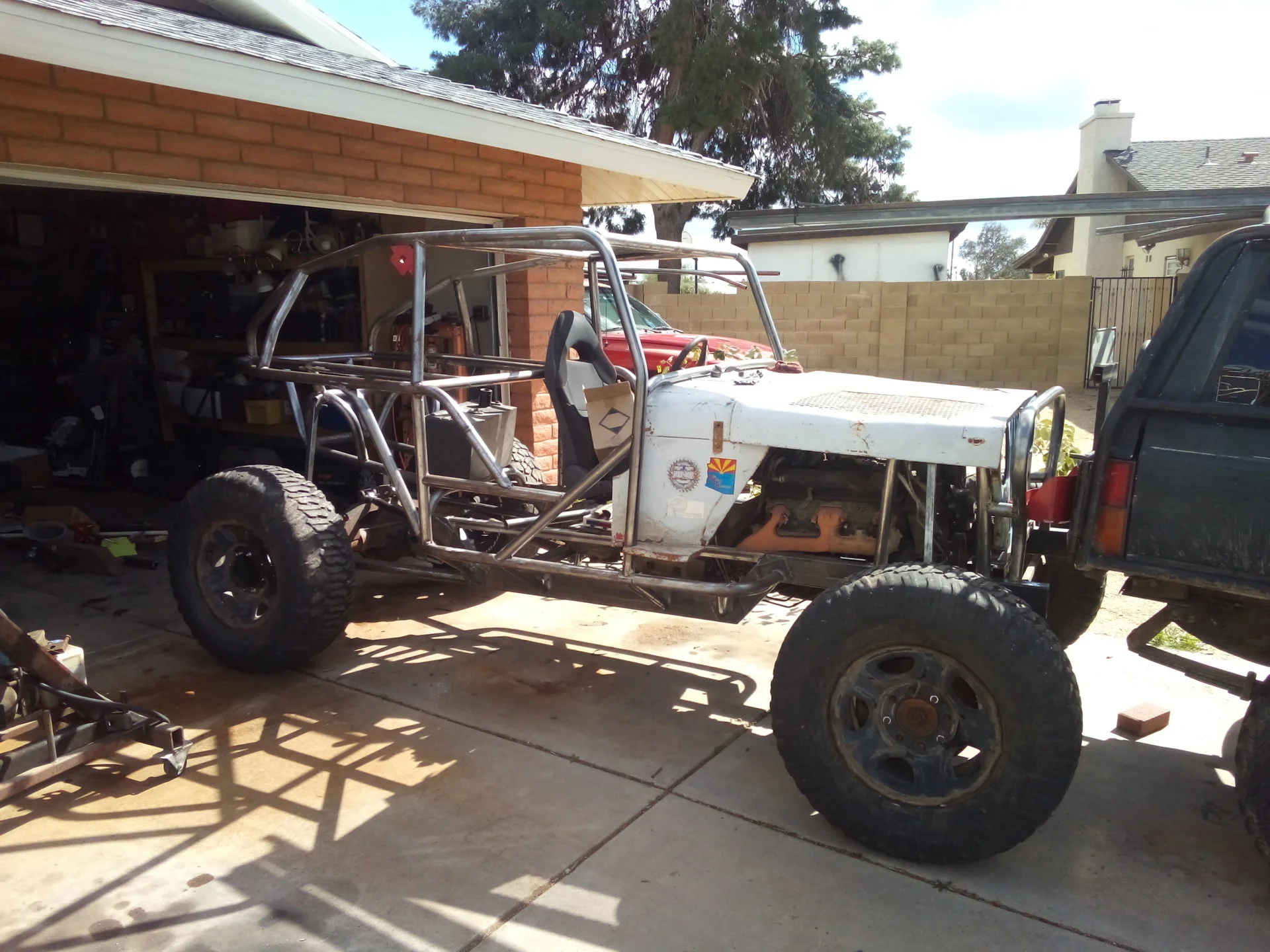

I've been wheeling most of my adult life about 35 years. Last few years I have been building and using my 89xj. Now I'm in the process of building a 46 Willy's buggy.

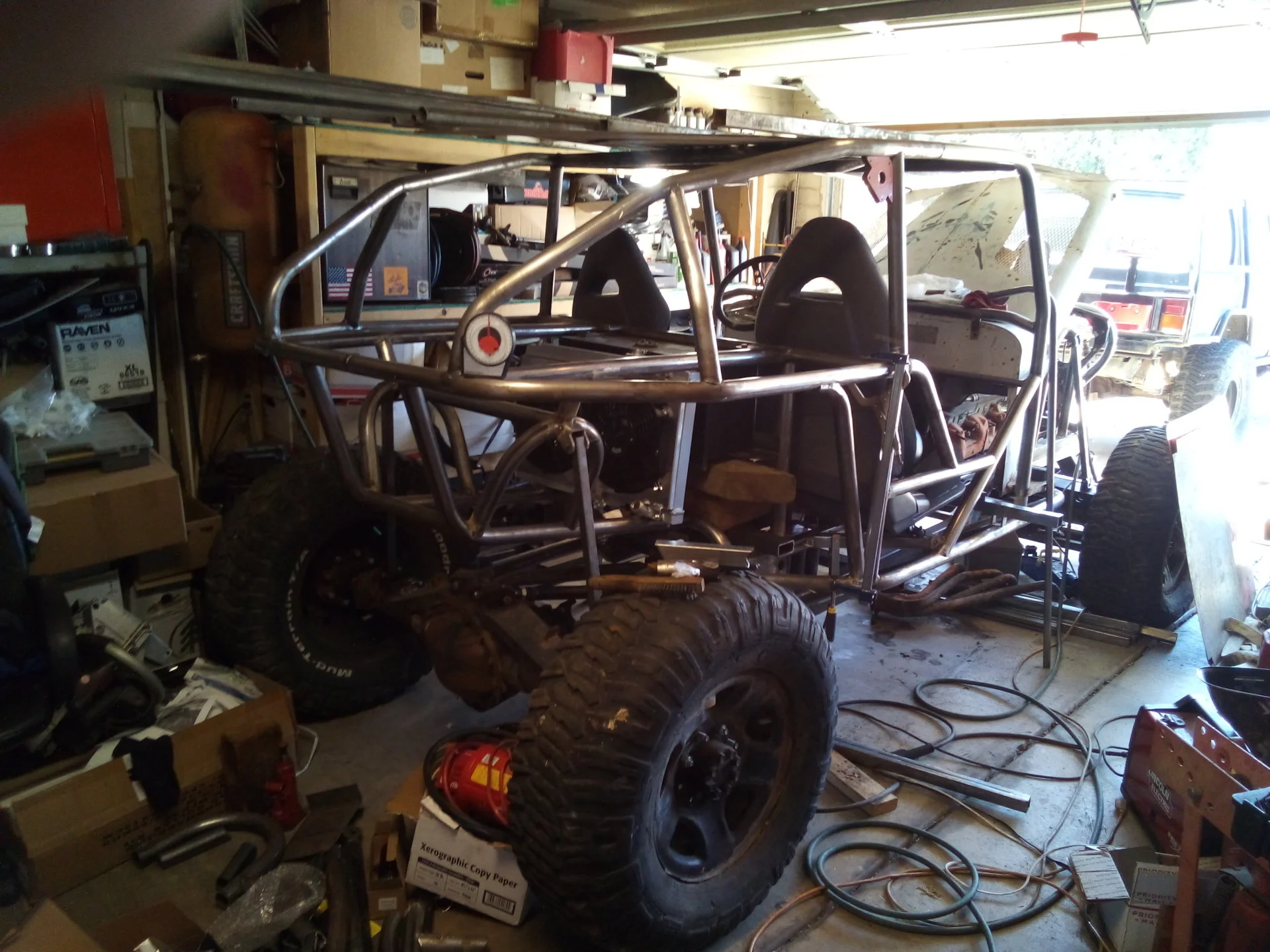

tbi350 rebuilt stock, 700r4 built to take 500-700hp, 241c with 241d parts swapped in sye and 6 planetaries, trused 14 bolt w/513s 4linked detroit w/14" airshocks rear ,trused dodge dana60 w/513 spooled w/cable release 3link 14" coilovers front . 107" wheelbase. Right now its sitting on 35s and at full bump for building should have 21" belly at ride hight w/ 39" bfg projects. 17gal alum fuel cell. rear mounted rad. and until I can afford to replace it hydro assist. I have been collecting parts for the better part of 12 years.

Mine changed just this weekend. Decided to push the grill out a couple of inches and lengthen the hood so I can mount the rad in front, to simplify everything and maybe keep the fan noise down.
