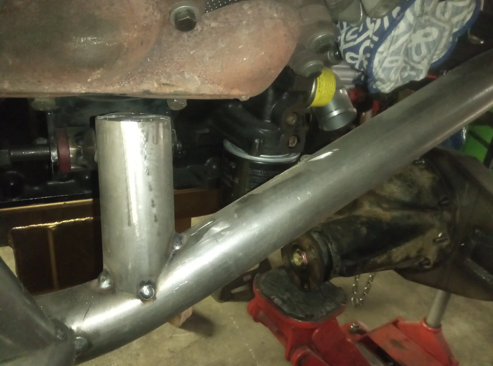

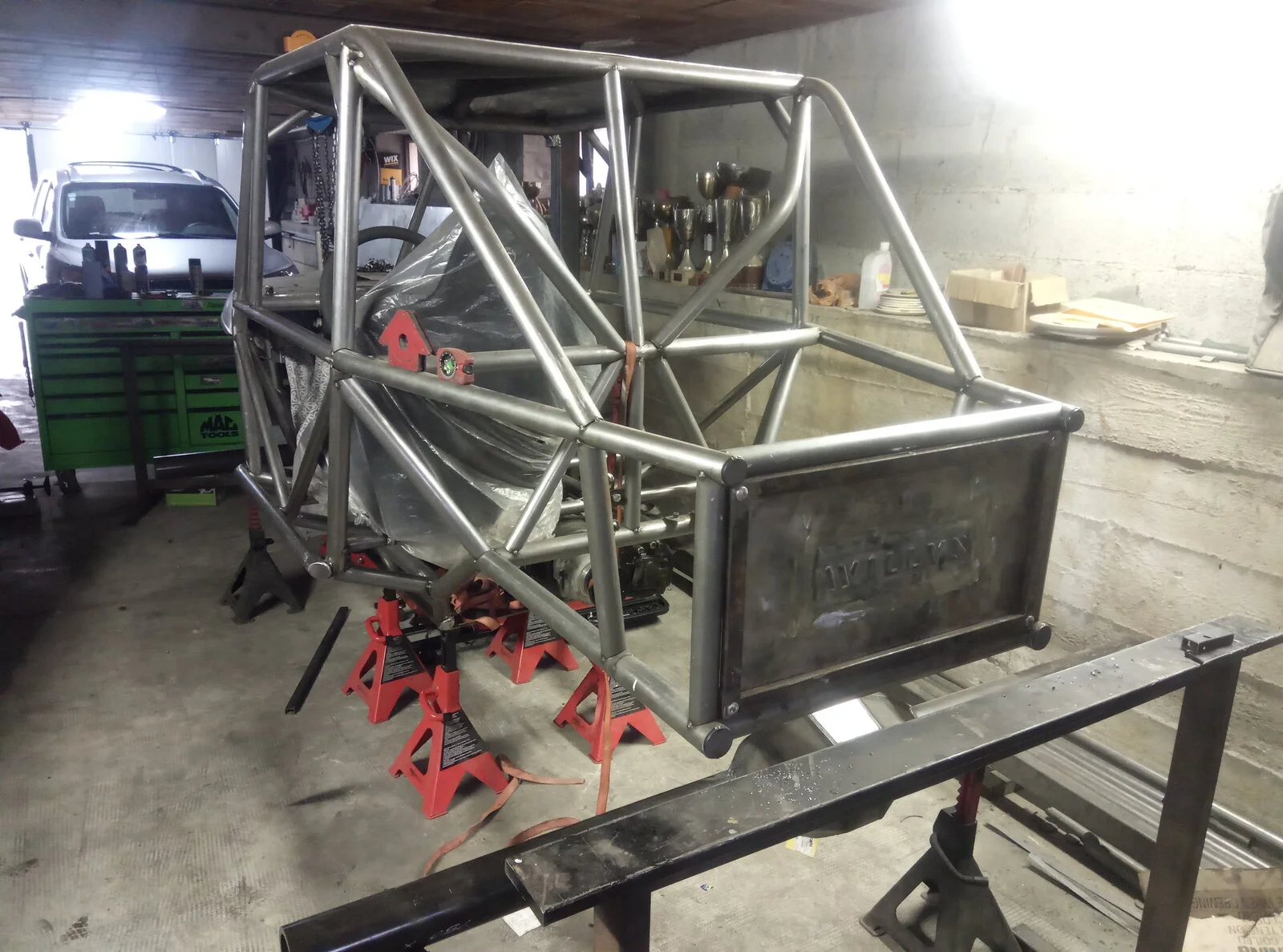

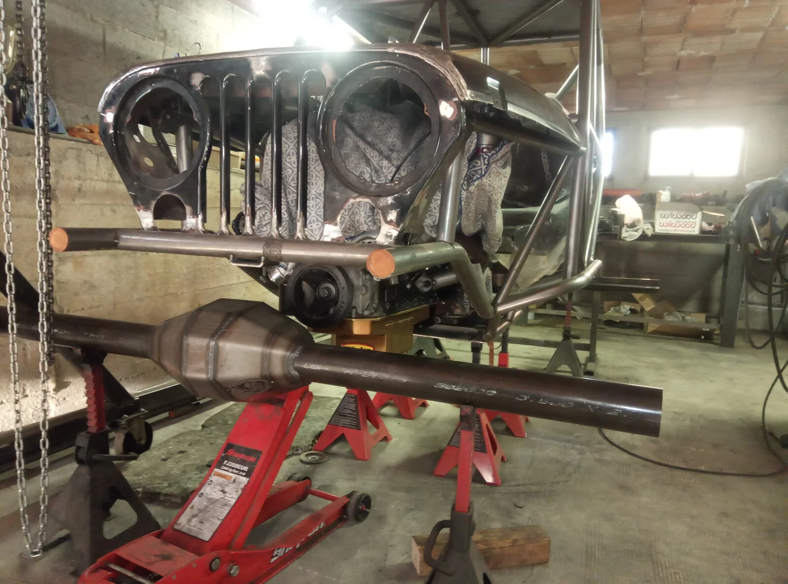

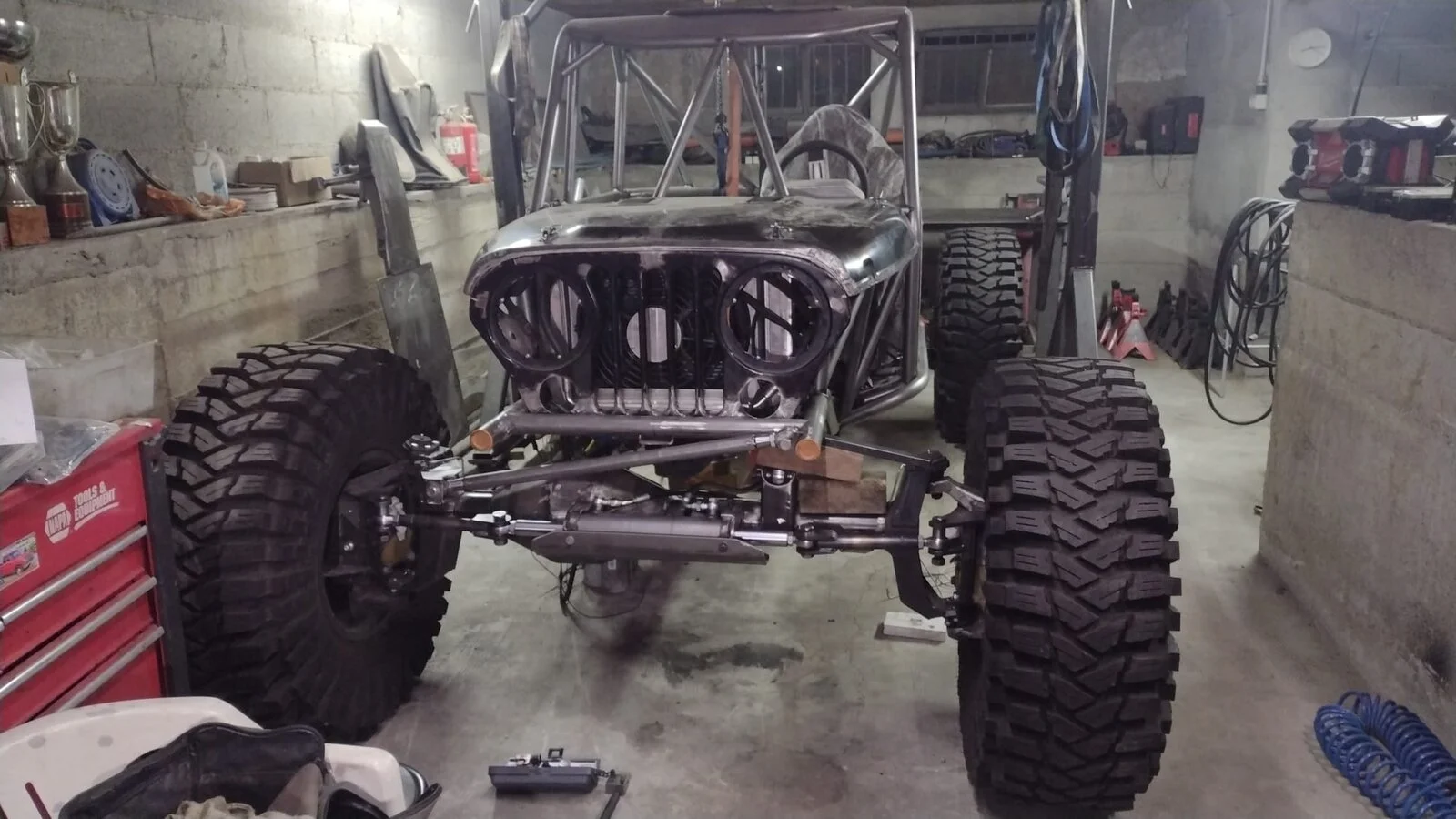

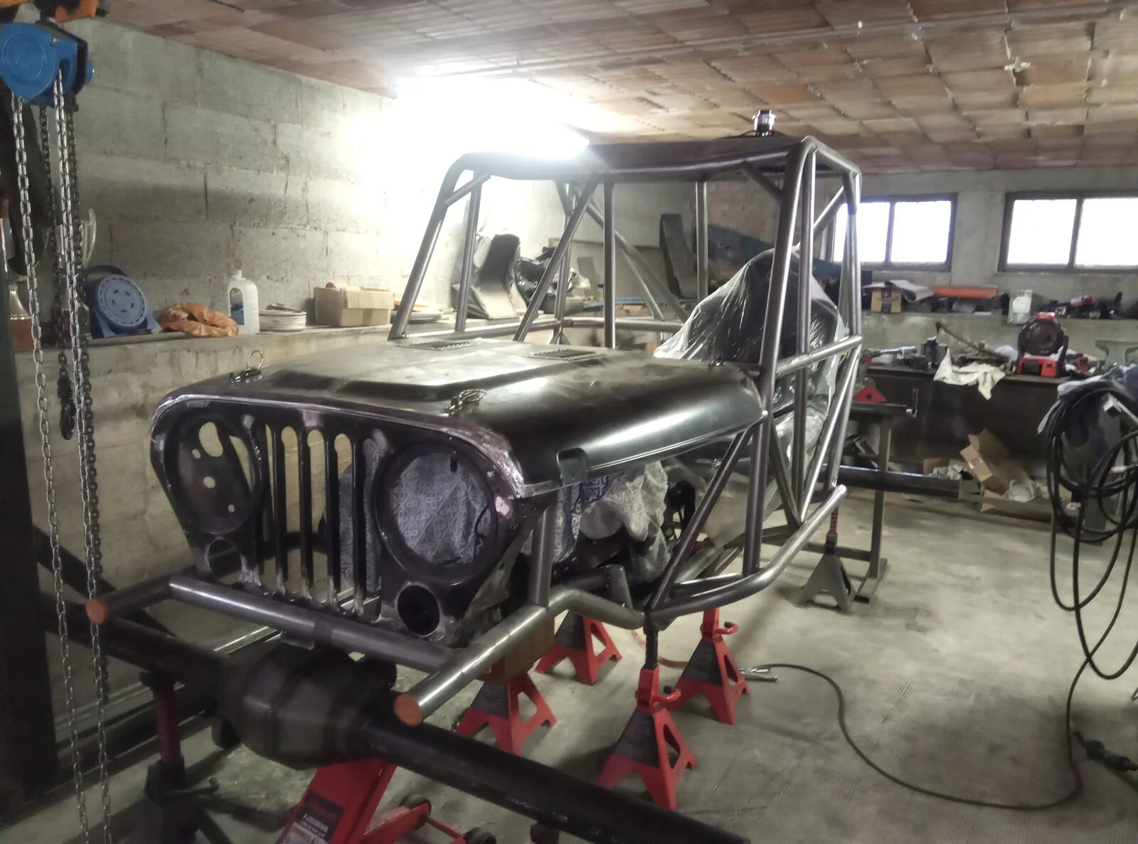

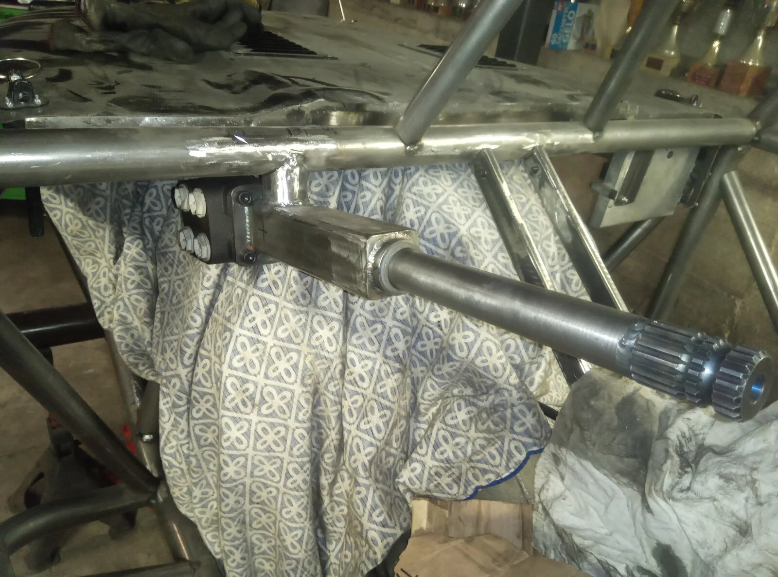

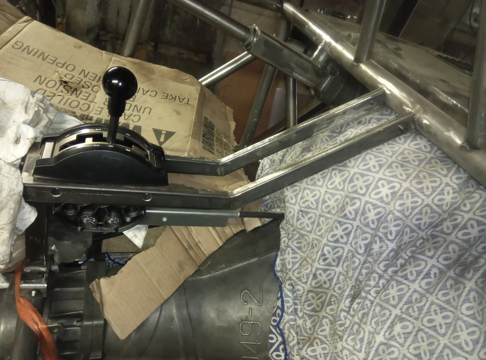

Hello folks, sorry about being so late, here some pictures of the rig I'm building, I will need your help soon for a few technical issue due to my lack of knowledge...
tubes and more tubes!

Thank you, chassis is not done yet, I need to get the coilover and the axle done in order to put some more tube. Can get why there's only one picture since I've been uploading 17 of them, I'll try again...
