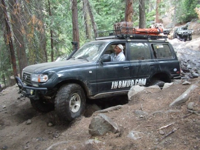

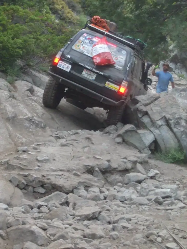

UPDATE: Just drove the FZJ80 on another 4500 mile round trip to run the Rubicon Trail…again, VERY impressed with the gear performance while offroading…the added control on climbs and descents helped a great deal with avoiding body damage and maintaining traction…I was able to run nearly the entire trail without engaging the front or rear differential lockers!
