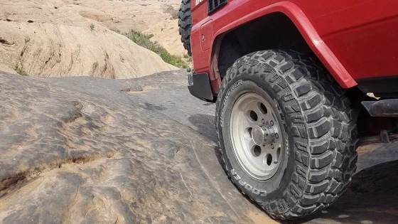

Cooper Discoverer STT Pro’s down to 14 psi in the rocks – the sidewalls squatted nicely and helped create a great footprint for the Moab slickrock.

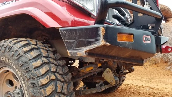

Offroad, I do air down the STT Pro’s a bit more than I normally would….Cooper is known for amazing treadwear (we can’t seem to wear out the Discoverer AT/3’s on our GX470) but compromises a bit with a harder rubber compound. I ran between 10 and 15psi and the STT Pro’s were effectively point and shoot. The slickrock of Moab and Sand Hollow were no match, even when I would deliberately stuff the sidewalls into the rocks. (I will note that I installed them laces out, and the white lettering is getting rough…)

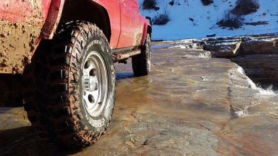

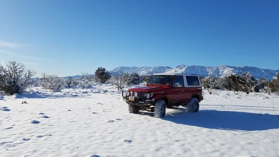

Snow in our corner of Utah is rare, but fortunately easy to visit. The Cooper Discoverer STT Pro’s made short work of most of the climb up, but finally ran out of traction. 25psi was a bit much, and dropping to 12psi turned a slick snowy/muddy climb into an easy drive…to this amazing photo spot.
Getting this shot was almost painful…

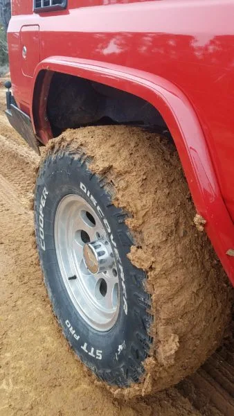

It may not look like the STT Pro’s cleaned well in mud, but this clay slop was no match for their aggressive tread. Slow starts, slippery climbs and gooey ruts were no problem…they simply found traction and continued forward motion with minimal tire spin. Notice how clean the fenders and bumper remain….idle speed was all that was needed.
