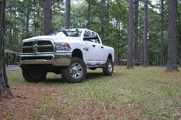

Superlift’s 2.5” Level-It Kit for 2014 Ram 2500 & 3500​
Superlift’s 2.5” Level-It kit for the Ram 2500 and 3500 features fabricated steel spacers that bolt to the coil spring towers. Additionally, relocation brackets for the factory shock absorbers’ bottom mounts ensure adequate shock extension travel. Unless the shocks are relocated, they will prematurely “top out” from being fully extended, creating a harsh ride and ultimately damaging the shocks.
All primary kit components are manufactured in-house by Superlift, and feature a durable powder coated and zinc plate finish.
Superlift Level-It Kits, like all Superlift Lift Kits, are Made in the USA, and carry Superlift’s Industry Best Lifetime Warranty and 60-Day Consumer Satisfaction Guarantee.
