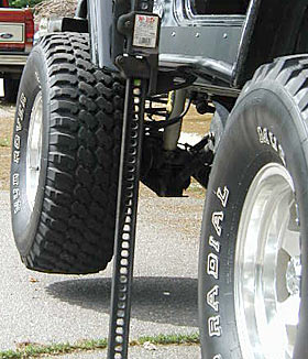

I fear no rock now. I have not had a chance to try pulling the Jeep sideways with them. I think I will save that test until I need to do it. I did jack it up with the Hi-Lift, though. The side step made for a very secure jack point and kept the jack a few inches away from the body of the Jeep. These are definitely one of the best things we have installed so far.

Jack it up!
The Rocker Panel Guards provide a strong jack point for a Hi-Lift.
