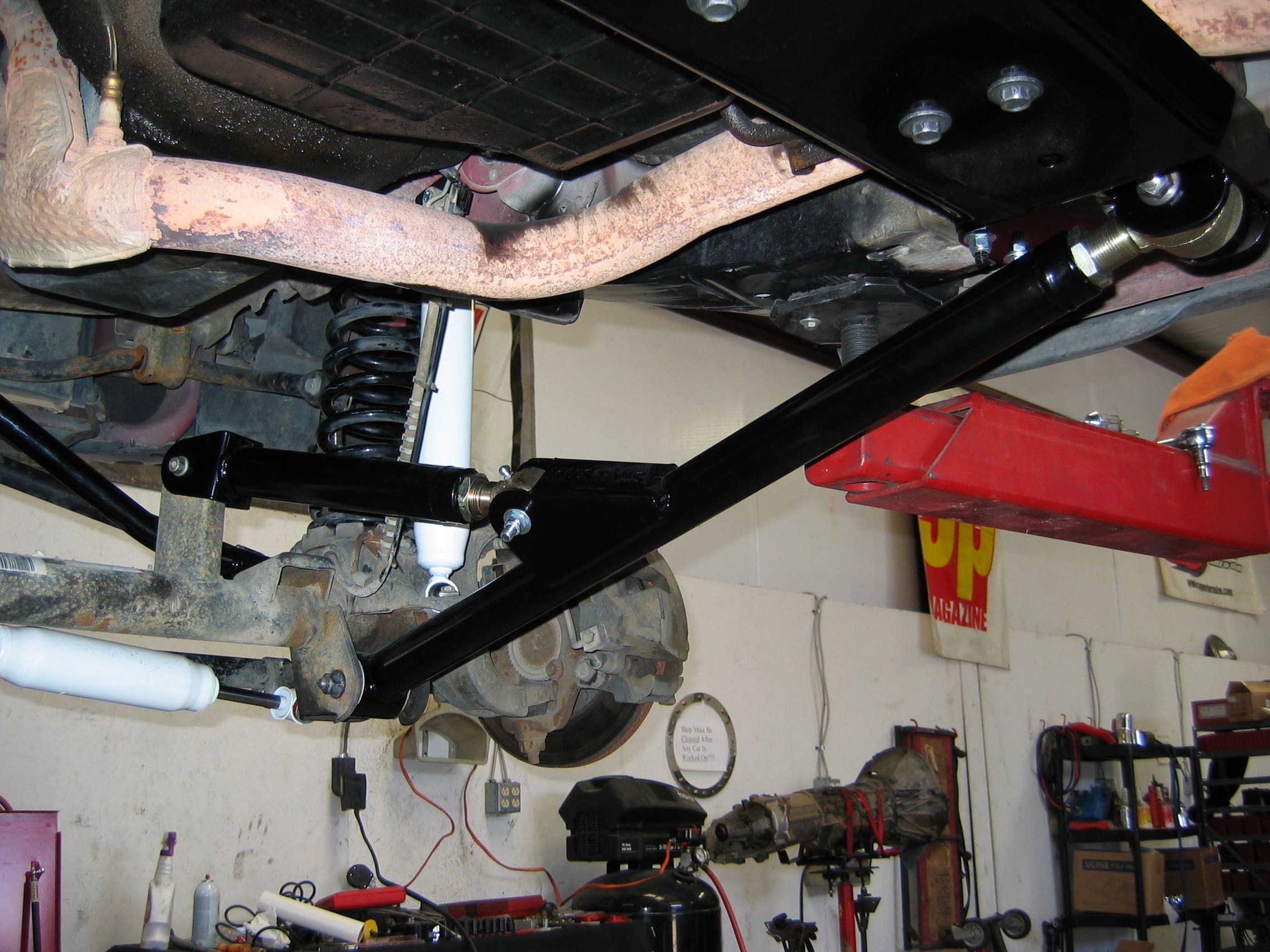

This kit bolts on to the uni-frame with minor drilling. NO WELDING is required or recommended. The front uses radius style arms and are completely adjustable, both the long lower as well as the upper link. Rusty’s Forged Flex Joints at the adjustable end and factory rubber control arm bushings at the axle end insure great strength & flexibility with no noise or vibes transmitted through the uni-frame. Rusty’s arms are constructed of 2 inch diameter D.O.M. tubing. This assures that you will not damage the arms on any rocks or ledges.
The new radius style arms bolt to a completely new 1/4 inch thick steel, laser cut and CNC formed cross member that has an extended mounting area and it also surrounded by Rusty’s new frame reinforcement. The 1/4 inch laser cut reinforcement brackets are located on the outside of the uni-frame. These brackets basically sandwich the uni-frame, tying the uni-frame and the new cross member together. Doing this distributes the load over a much larger area of the uni-frame.

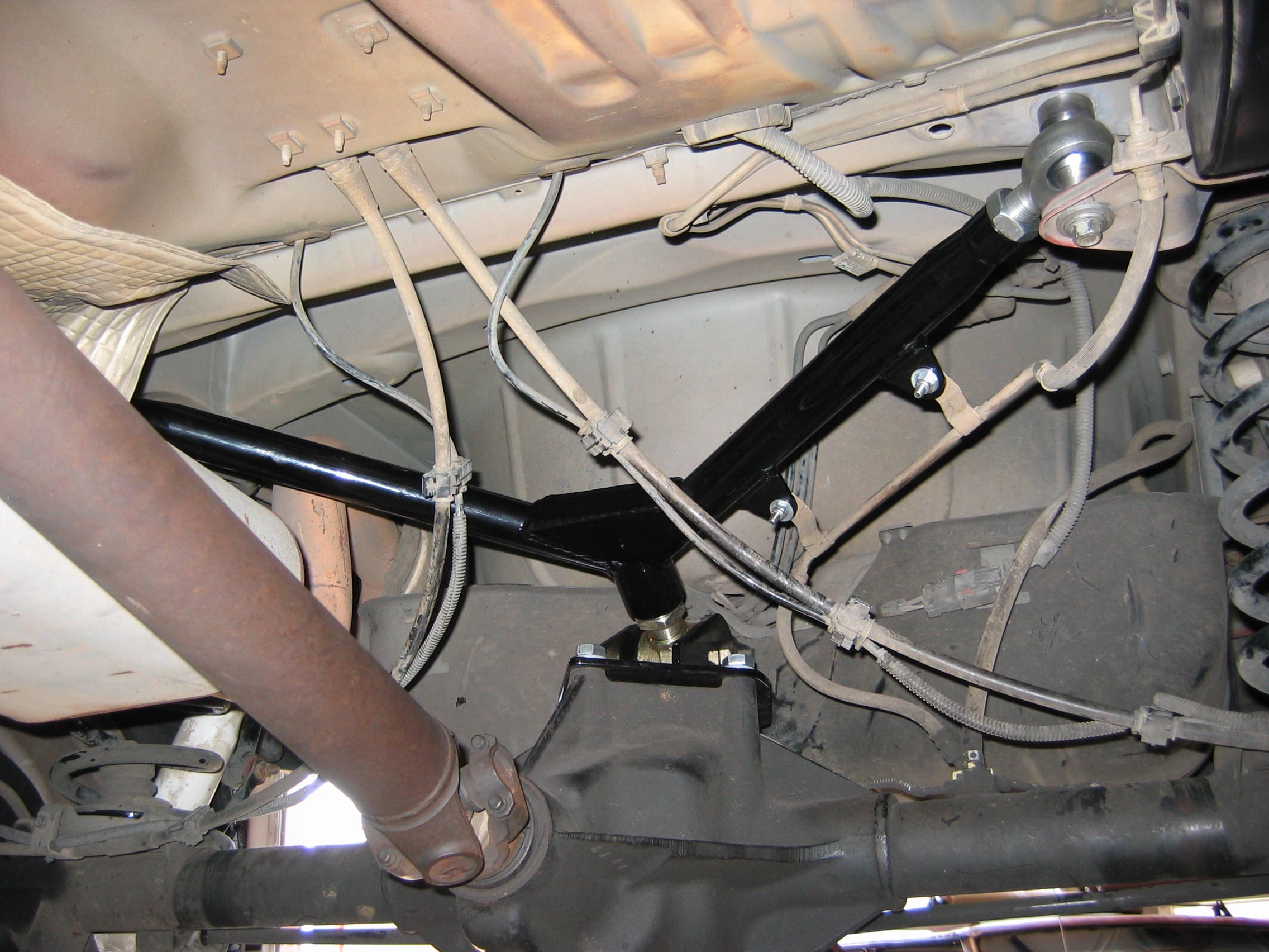

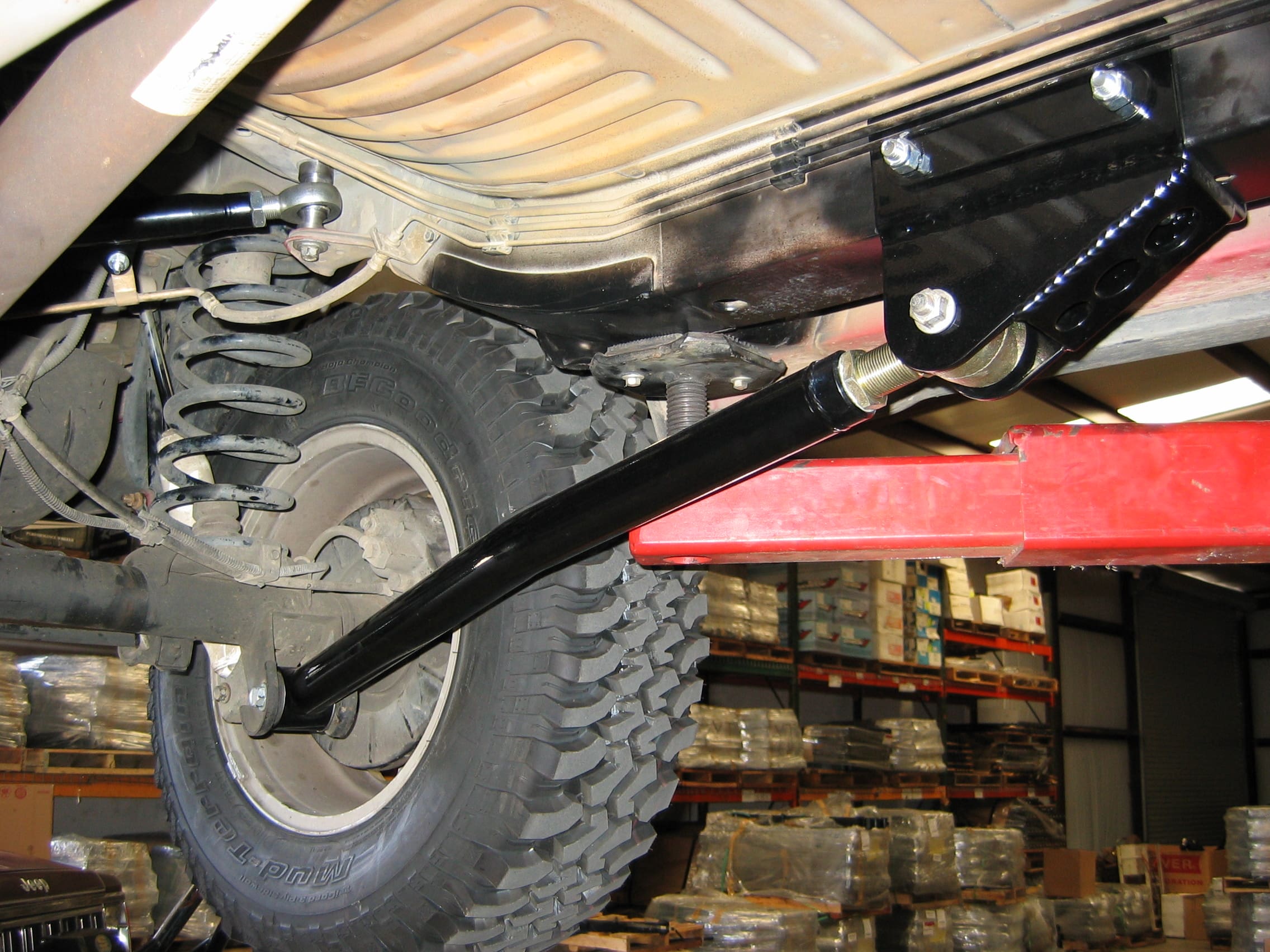

The rear lower control arms are both built with large 2 inch diameter D.O.M. and feature the Rusty’s Forged Flex Joints for maximum articulation and strength and the factory rubber bushings at the other end to ensure no vibes are transmitted through the uni-frame. No exhaust modifications are necessary with this kit. The Rusty’s rear mounting hanger is constructed of 1/4 inch thick steel, laser cut and CNC formed. These brackets also feature our keyed and tabbed bracket technology. The Rusty’s rear upper link is constructed of 1.50 x .375 DOM tubing, the upper link attaches to the body with two 7/8 heim joints and a Rusty’s forged flex joints attaches to a bolt-on 3/8 steel axle mount. Many hours where spent in the development and design of this bracket to offer strength, durability and adjustability for great articulation and precision driveline angle.
