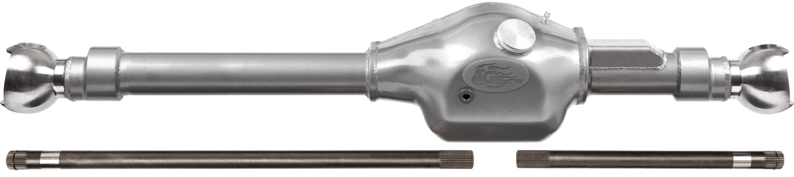

This exclusive axle design is the first in the industry to be released with all new parts. Our knuckle balls are forged from 1035 steel, making them much stronger than stock, eliminating closed or bent knuckle balls.
The axle tubes have been offset above the housing centerline, so the inner axles ride near the bottom of the axle tubes rather than in the center. The result is an increase of 3/8″ in ground clearance under the axle tubes. The axle tubes are made from 5/16″ thick 1020 DOM tubing with an outer diameter of 3″.
The heavy-duty, press formed, 1/4″ plate steel center section is shaved to give you 3/4″ of additional ground clearance under the differential. The differential mounting surface is made from 1/2″ plate steel to ensure studs can not pull out, even under heavy loads. Our housings are precision alignment checked using start-of-the-art, 3D digital imaging equipment to ensure that all Rock Assaultâ„¢ Axle Housings are 100% straight and true.
The Rock Assaultâ„¢ Front Axle Housing will come in your choice of bare tubes, with spring perches installed, or 3-link ready with a panhard bracket included. For an additional charge we can install an inspection cap making inspecting your front ring and pinion a breeze. Axle housing is shipped unpainted and lightly oiled to prevent rust during shipping and storage.
Comes with both 30 spline chromoly short and long side axle shafts.
