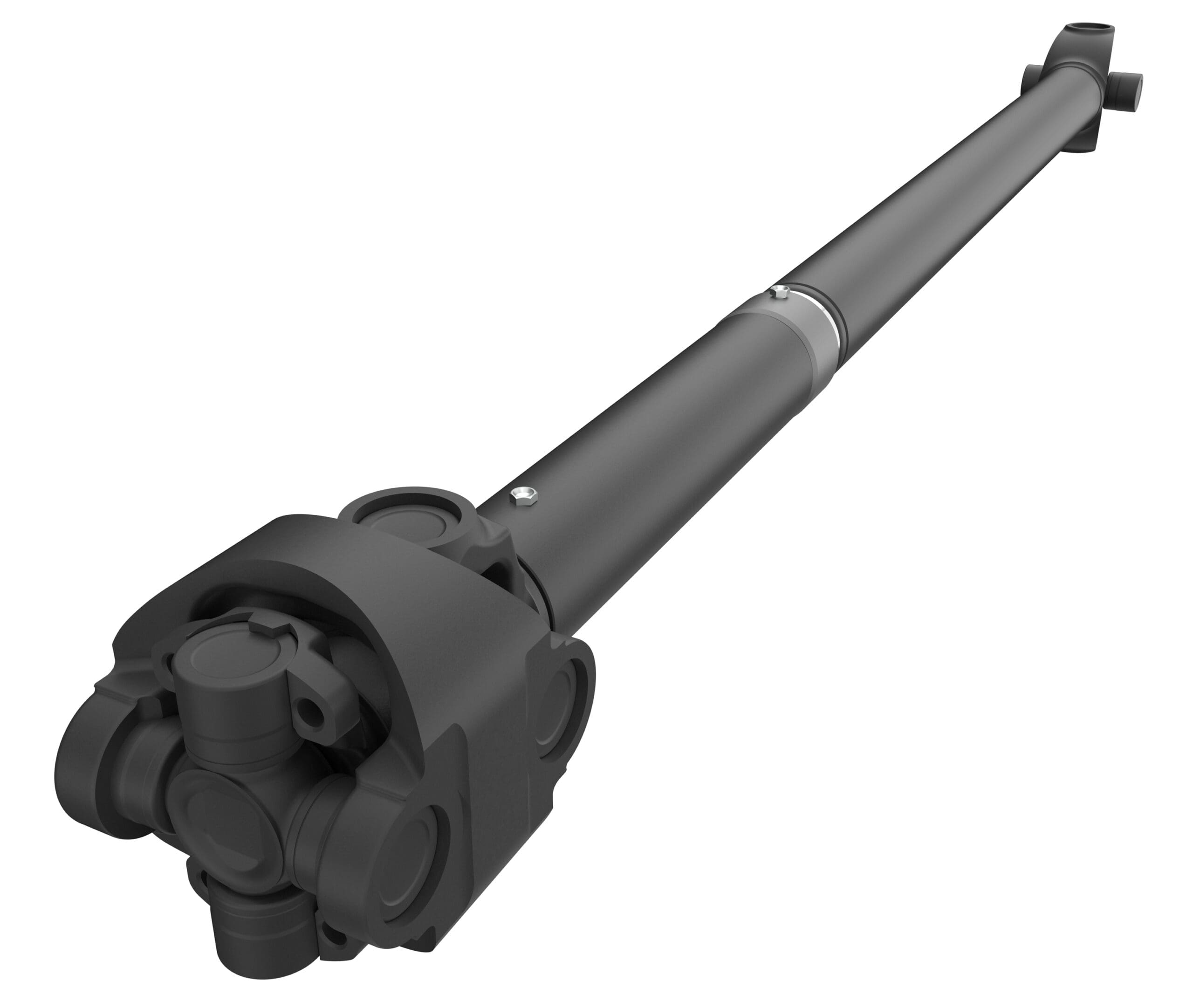

The Spicer® 1350 Series driveshafts are designed as a bolt-in replacement for the original equipment on both 2-door (front only) and 4-door (front and rear) models. The driveshafts feature a Spicer Life® Series 1350 u-joints and a longer slip length of 6 inches. The slip assembly is located at the transfer case next to the double carden joint to minimize damage and contamination. The driveshaft is constructed with an outside tube diameter of 2 inches, for optimal clearance, and a tube wall thickness of .120 inches for enhanced strength and durability. It comes with a new Spicer® 1350 series transfer case yoke and connects directly to the Spicer® 1350 series yokes on the UD60 axles.
