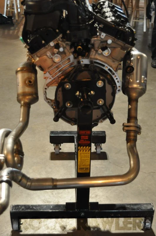

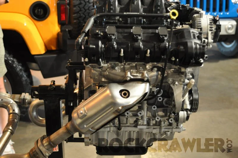

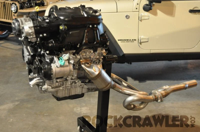

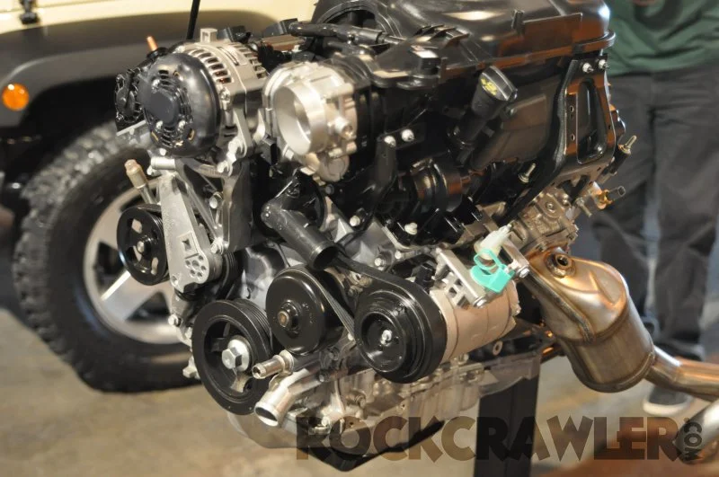

First, since this is the BIG change for 2012, some engine pics:
notice the alternator, mounted up high...you DO need to pull the alt/bracket to remove the serpentine belt tho...

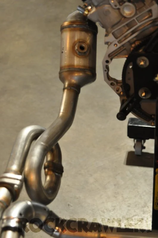

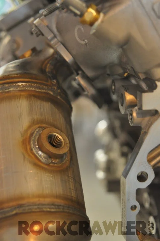

yep, four O2 sensors, two per side...

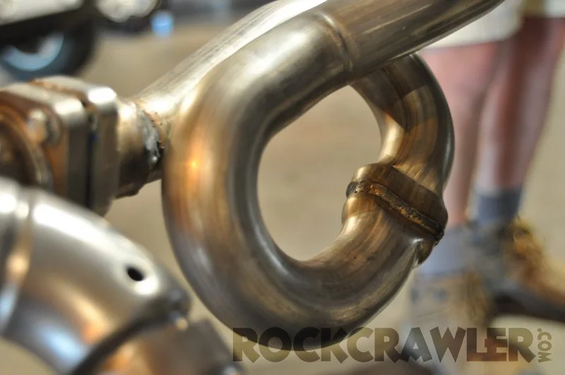

And the trumpet-style drivers side exhaust...required to make each side equal length

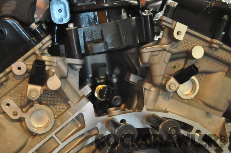

back of the block/heads...of course, a few things are tucked and hidden...

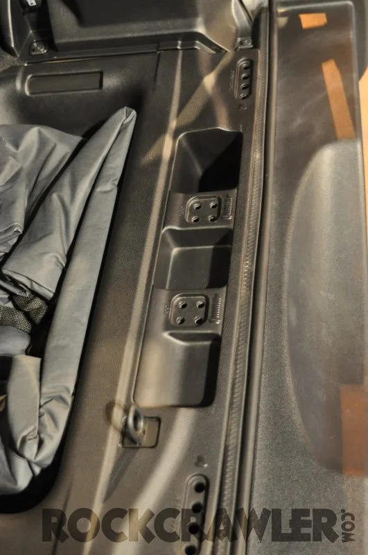

Storage, exterior, and other poser shots...haha

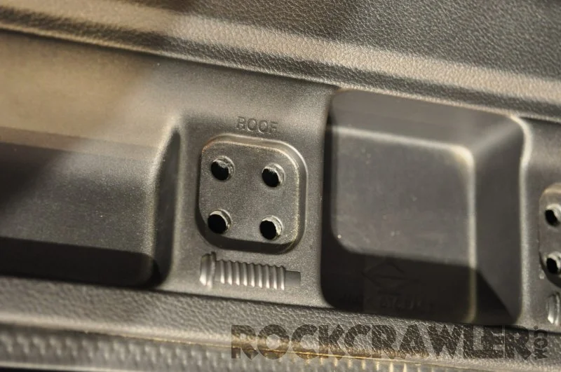

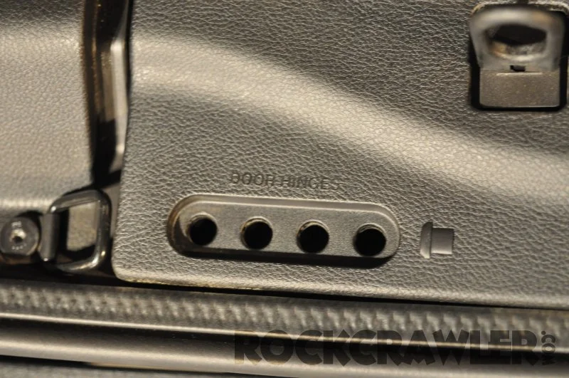

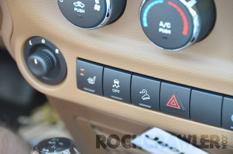

Marked and labeled...hard to mess up...

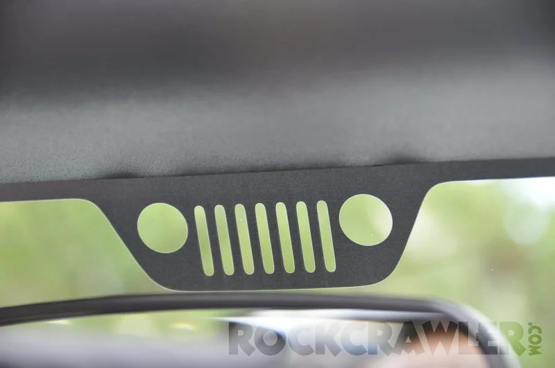

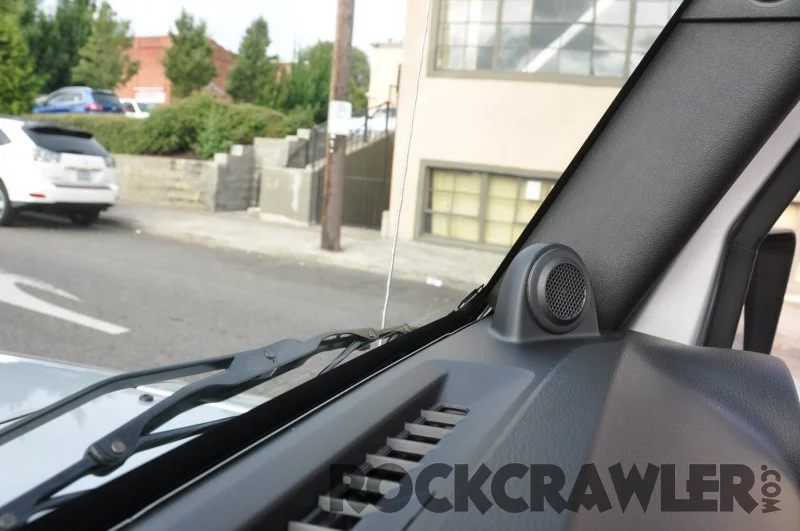

small details, but neat implementation...this is the top edge of the windshield above the mirror...
look in the corner of the windshield...look close...tiny little climbing Jeep image!

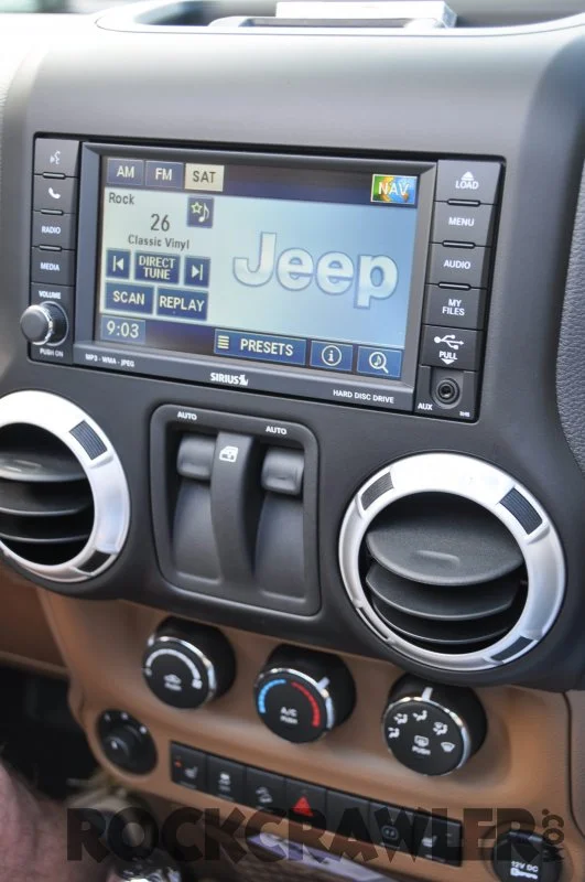

Heated seats on the Sahara...NICE!
And yes, Garmin Navigation is an option too...along with satellite radio...
