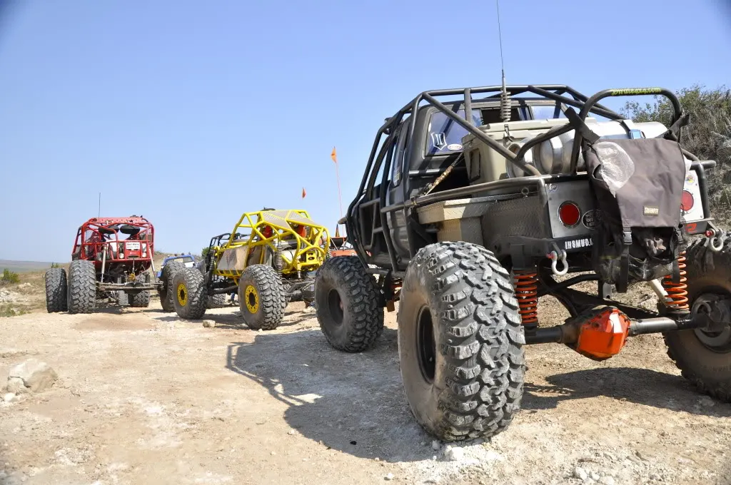

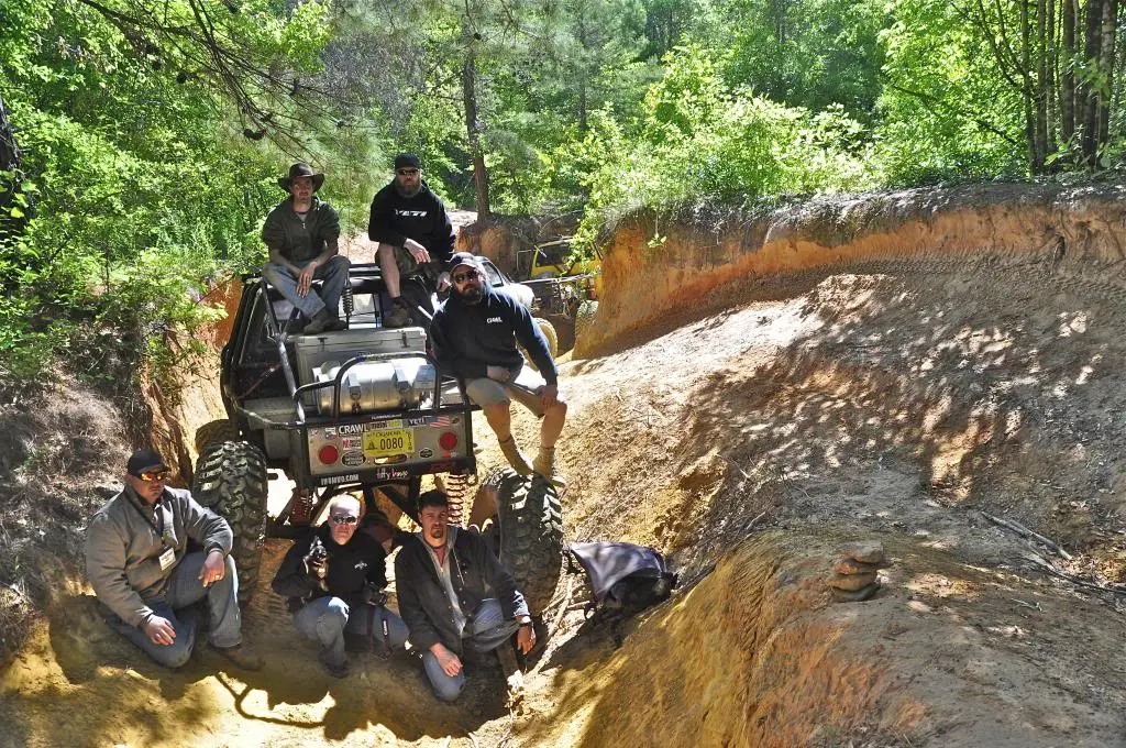

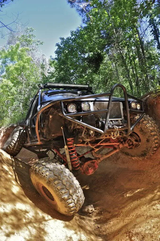

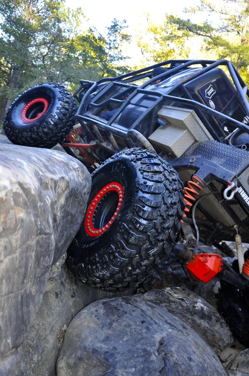

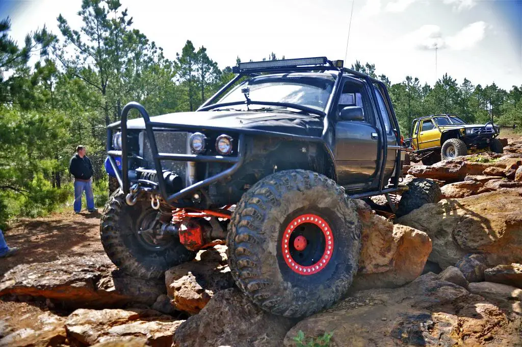

91 Toyota Truck
-wheelbase is 125" and the width is 90" outside of tire to outside of tire.
-Fully Tig welded Exo Cage
Drive Train
-350 motor
-350 trans
-Lokar shifter
-203/205 doubler twin sticked
-Brand new GOTPROPANE system with 2 used aluminum forklift tanks - need to revamp the cage to get them protected.
Front
-Dana 60
-5.13 gears
-Detroit
-Full Yukon 4340's with Super Joints
-RPM 35 spline drive flanges
-coil springs
-rancho shocks
-3 link with track bar
Rear
-14 bolt
-5.13 gears
-detroit
-disc brakes
-coil springs
-ranch shocks
-grader ball suspension
Misc.
-rock lights
-Mastercraft Harnesses. lap belts installed, need to get a brace welded in for the shoulder straps.
-custom tube doors
-9500# winch
- 5 - 42" Iroks on 15" black steel wheels
-Crawlfab weld on beadlocks not installed yet
- Full Hydro steering
- Spare PSC SE ram
-CD player
-40" Cree double row, 3x3 Cree, Crawler pods, 6" Double rows, 4" HIDs, and rock lights thanks to OKledlightbars.com
That's the important stuff, but now what everyone wants... PICS
