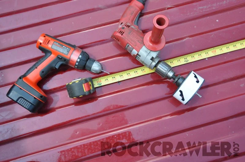

Tools: simple stuff...1/2", 9/16", 3/4", 15/16" combos and sockets, a 4" hole saw and a 1/2" drill...and a straight-cut tin snips to notch the bed in the passenger side fenderwell...

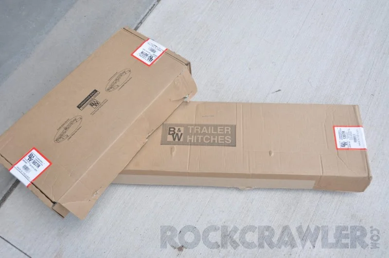

First, boxes...two, heavy, with hardware inside...

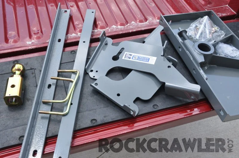

Next, the pile of stuff from inside the boxes...

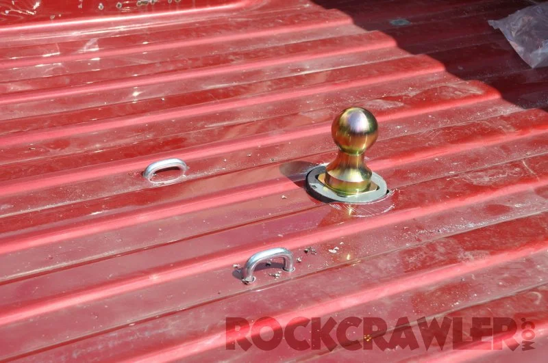

The BIG key to doing this right is the 4" hole...I measured, re-measured, began a pilot hole, RE-RE-read the instructions, RE-measured, and finally committed...no second chance here...

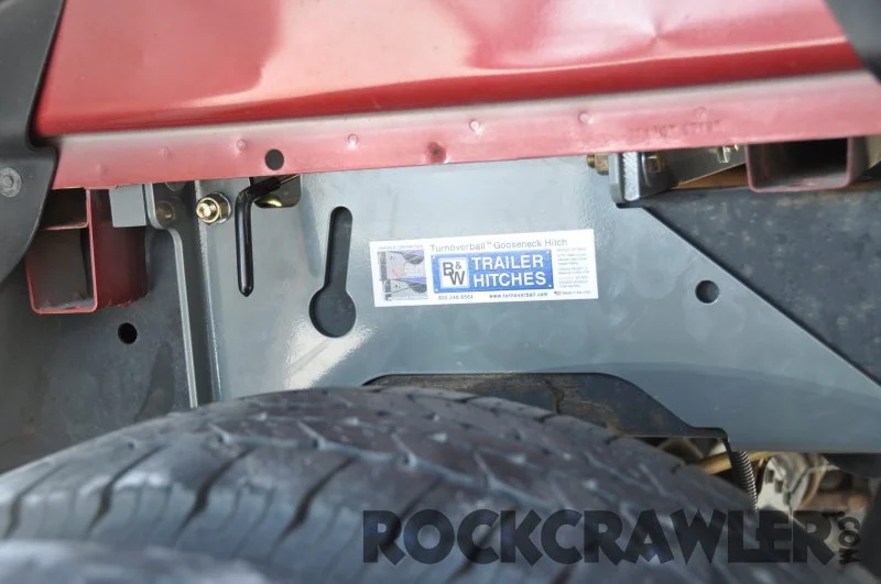

Finished pics...first, the ball/safety chain points...

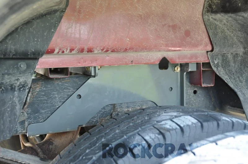

Drivers side frame plate...
Passenger side frame place...had to rel0cate the e-brake bracket (parts included!)...this is also where the release lever is positioned...

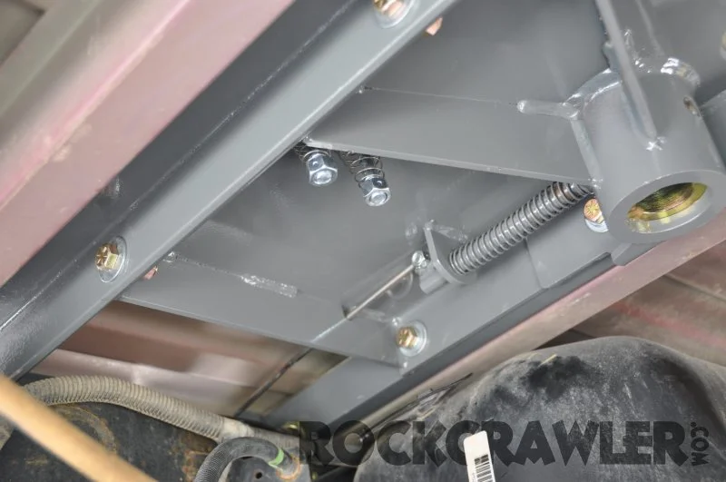

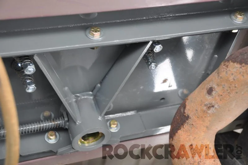

And, two pics from under the bed...YES, removing the spare tire is necessary...adds a ton of space to maneuver things around...
