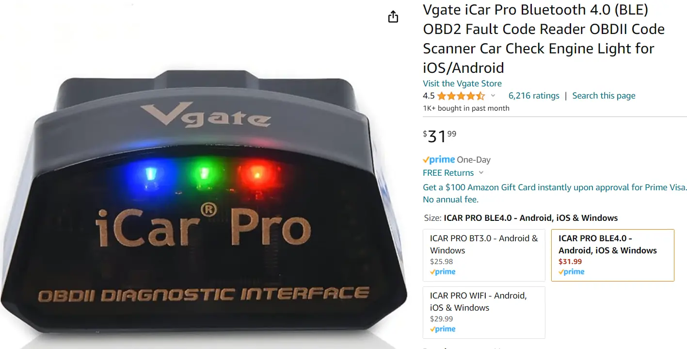

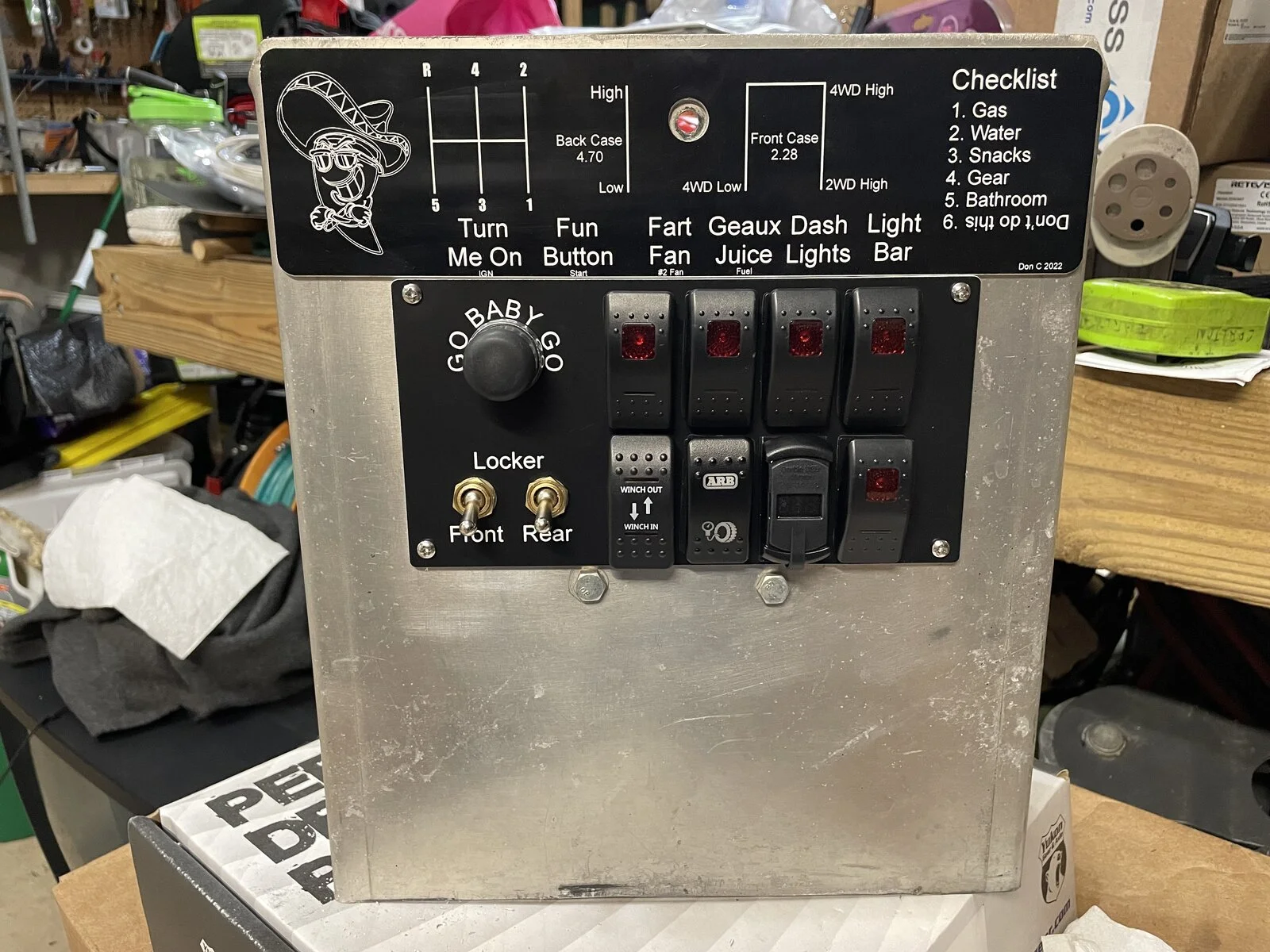

Mine is a simple panel with 3 gauges (water/trans temp and oil pressure). The plug on the bottom is a usb charging port that also shows the volts, so thats my volts gauge. I also can use an app on my phone that uses a OBD2 bluetooth dongle to an app called FourStroke. It lets me clear any codes that may pop up from my ecu. Only bad thing with most OBD2 readers is that they dont have a PiD for oil pressure so its not read through the app. My app requires a Bluetooth 4.0 reader so i bought this one on Amazon.

Boring standalone round gauges for oil pressure, trans temp, water temp. Nothing else needed IMO. Voltage is visible via a USB plug/monitor.

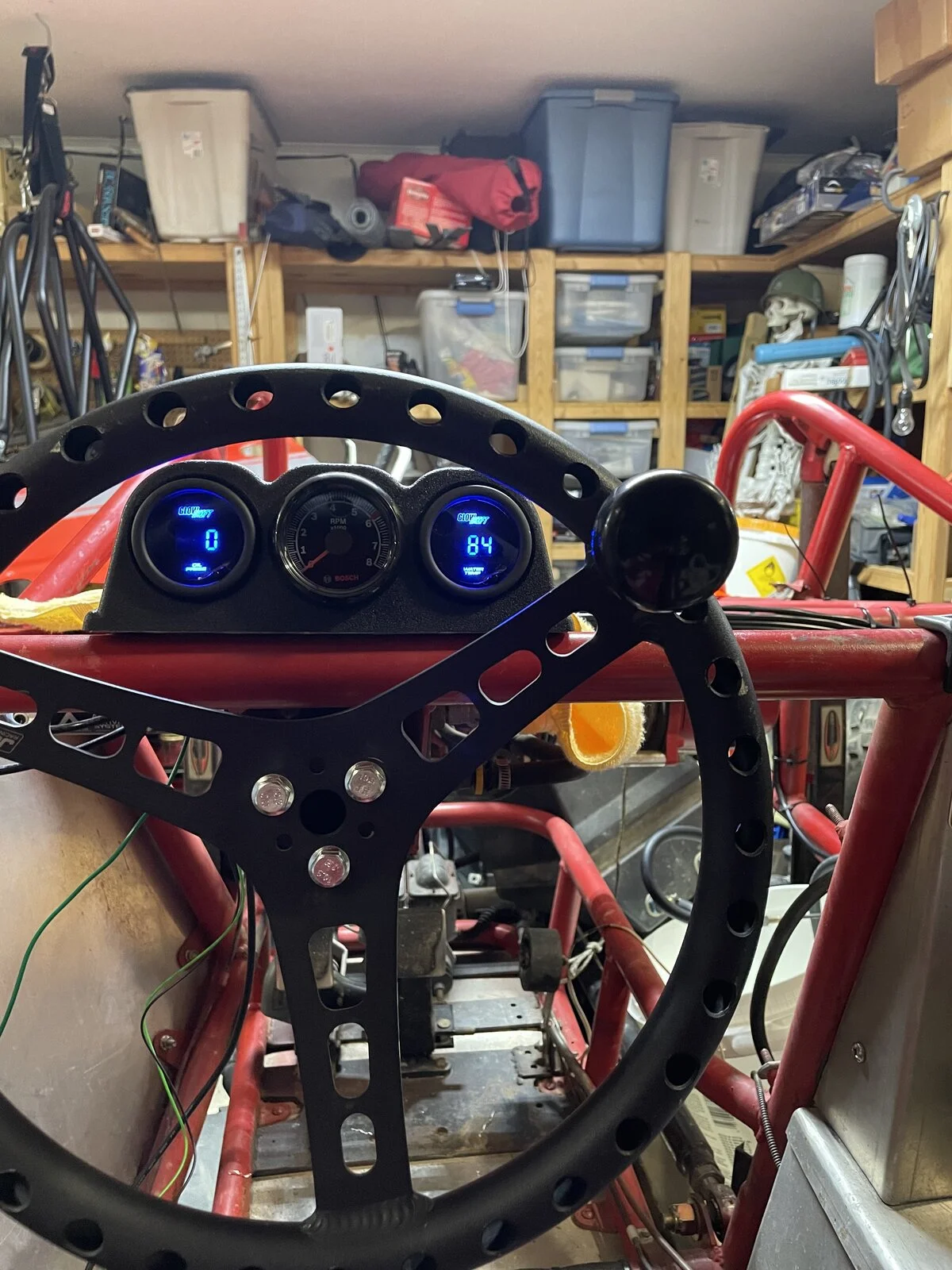

Used that pod on mine. Oil pressure and water temp. I opened the center hole up for a mini tach. I also have a volt meter on the usb plug in the middle of the switches.

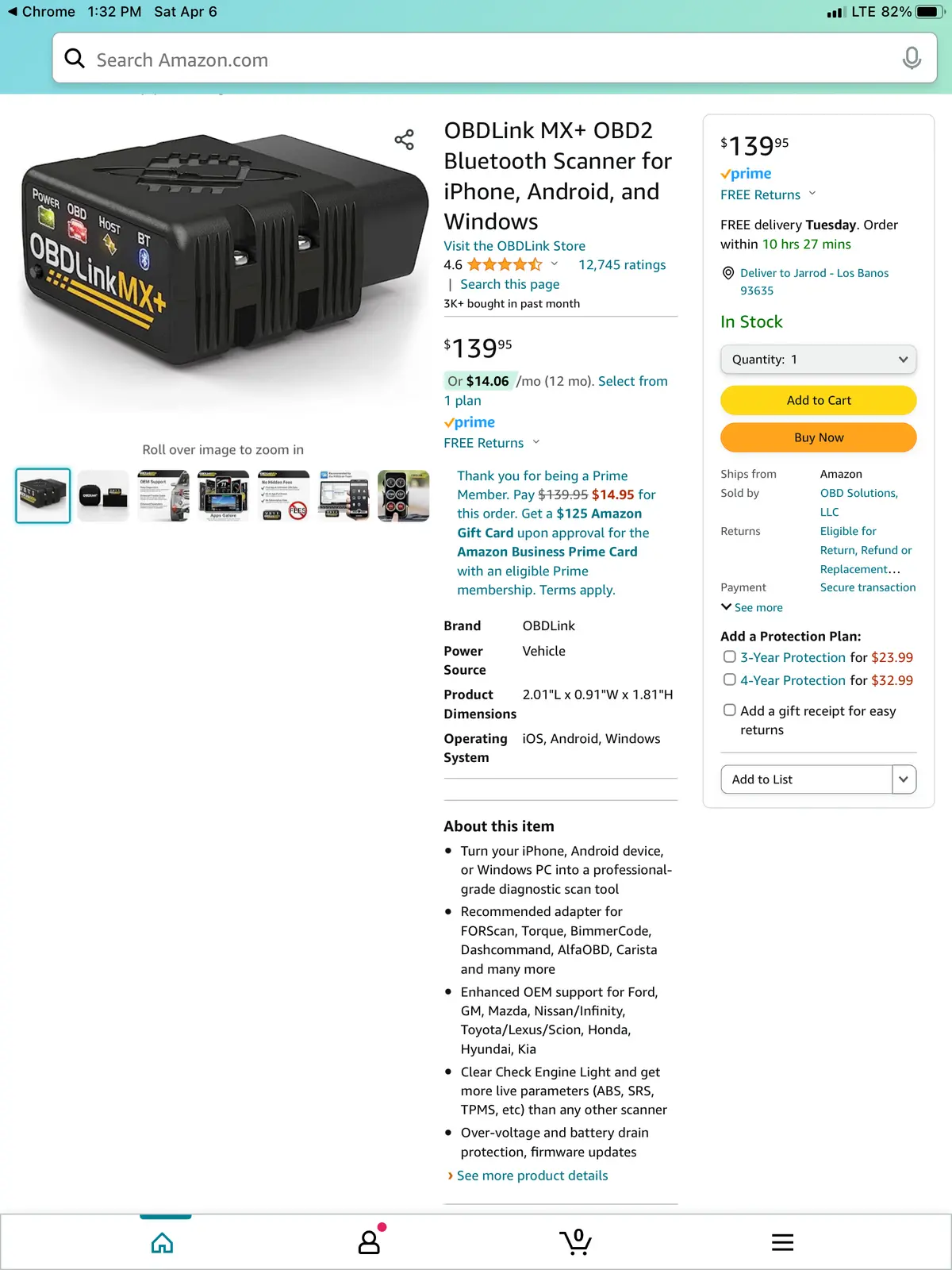

Hey. Yes. It was a Bluetooth box that plugged into OBD port then bluetooth to your phone. Reads codes. Makes gauges too!, I bought the car with that and came with an old android phone too.I got mad and ditched the engine and all that stuff too😂😂😂 here is something similar on Amazon..

OBD Bluetooth dongles are $10 or so on Amazon, I have one and tie it in with TorquePro.
