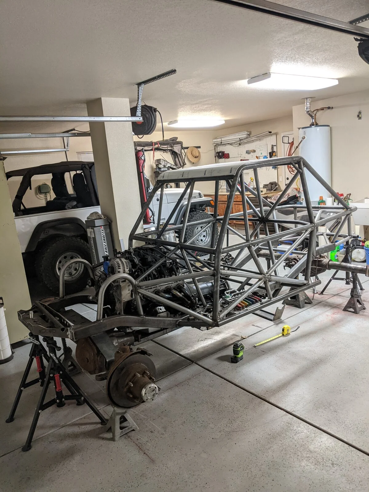

I have been wheeling for quite a while and have taken my LJ quite a few places but once I saw what was possible with a buggy I was hooked. It has taken me several years to get to the point where I could pull the trigger and get a build started.
I bought a partially finished Goat Built/JHF 2 seat chassis. I look forward to completing it and getting back up to Sand Hallow to test it out and hopefully learning how to drive better from the locals.

My plan for this rig is to build a capable trail rig that I can improve my driving skills with and increase my fab/building experience as well.
As fare as the build specs. goes, It has a LS 6.0 liter, TH400, I have an Atlas on the way (I found a case that someone did not end up using).
I have a D60 out of a 93 F250, and a 14 bolt out of a 2003. I would love to have portal axles with rear steer but I also realize that this rig is going to be more capable that my driving skills. Rear steer maybe a bit of a stretch for both my capabilities and budget. I am not going to go to crazy with these axles so I should be able to sell them in the future and upgrade when the time comes.
